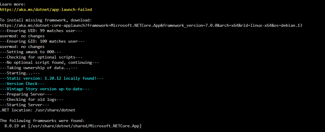

Vintage Story Server, new game update to 1.21.0 and it says "
The following frameworks were found:
7.0.20 at [/usr/share/dotnet/shared/Microsoft.NETCore.App]
Learn about framework resolution:
https://aka.ms/dotnet/app-launch-failed
To install missing framework, download:
https://aka.ms/dotnet-core-applaunch?framework=Microsoft.NETCore.App&framework_version=8.0.0&arch=x64&rid=debian.12-x64
So how do I go about updating the .net runtime to .net 8
I have to do that, please give me a few days.
The container is now updated, please update the container itself and everything will work again.
Hey I think this may have broken my instance, me and friends are stuck on 1.20.12 due to un-updated mods and not sure how but looks like my container got updated. Any advise?
Edited by Silent454
I create a second tag for the container shortly with dotNet 7.0 is that okay for you, so to speak you would have only to change the repository in the template.
Please edit your container and at Repository make sure to add :dotnet7 at the end, so to speak that your repository look like either: ghcr.io/ich777/vintagestory:dotnet7 or ghcr.io/ich777/vintagestory:dotnet7 depending which container registry you are using.
If you should ever upgrade to the latest version you just have to remove :dotnet7
Hope that helps.
Hope that helps.
Works great, thank you

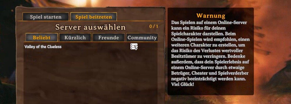

Hello all, my friends and me use your container for playing valheim a few month now … and it's working flawless (beside the fact that BepInEx died on the way … really not that important … I just disabled it).
But since the start the service is unreliable in terms of availability. Meaning: Every one, two or three days the valheim server can no longer be connected (question mark or cross in the valheim server list). The solution is always just a simple reboot of the docker container ... after that, everything is back to normal. I even set a scheduled task to reboot the container every night ... but still 50% of the time i have to reboot it manually before we can start a session.
Is there any explanation for this behaviour … anything I can do?
Attached the view when the service is not reachable.
Not really, never heard of such a behavior.
My server also looks sometimes like that but that doesn‘t mean that the server isn‘t reachable, that‘s still an issue since the very beginning from the game.
anything I can do?
Do you have a static or a dynamic public IP address?
Do you and your friends connect with the IP or with the hostname in game?
BTW BepInEx should work again.
I have a dynamic ip and use the dyndns service of my fritz box (xxxxx.myfritz.net:2456). My friends and i use this name ... is that possibly the problem? Connection loss when my internet address changes?
I checked my reboot script ... it restarts the container every night at 3:00 am, but my fritz box renews its ip roundabout 4:00 am ...
Changed the reboot script starting time to 06:00 am ... we will see if this shows any progress ...
Edited by GrandpaXXL
Most likely yes.
I know Fritzboxes but I don‘t have one here in Austria, howerver you can try to use something like DuckDNS and see if that is working better, I assume that the server list caches the IP and when your IP changes the IP isn‘t correct anymore but this is just a guess.
32 minutes ago, ich777 said:
Most likely yes.
The caching part makes a lot of sense ... i will try the above approach with the schedule change and maybe another dyndns provider. Get in touch again when I know for sure whether one of the approaches worked. Thanks so far ...
