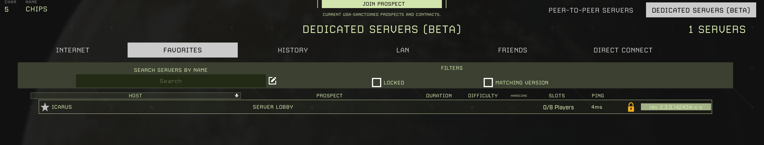

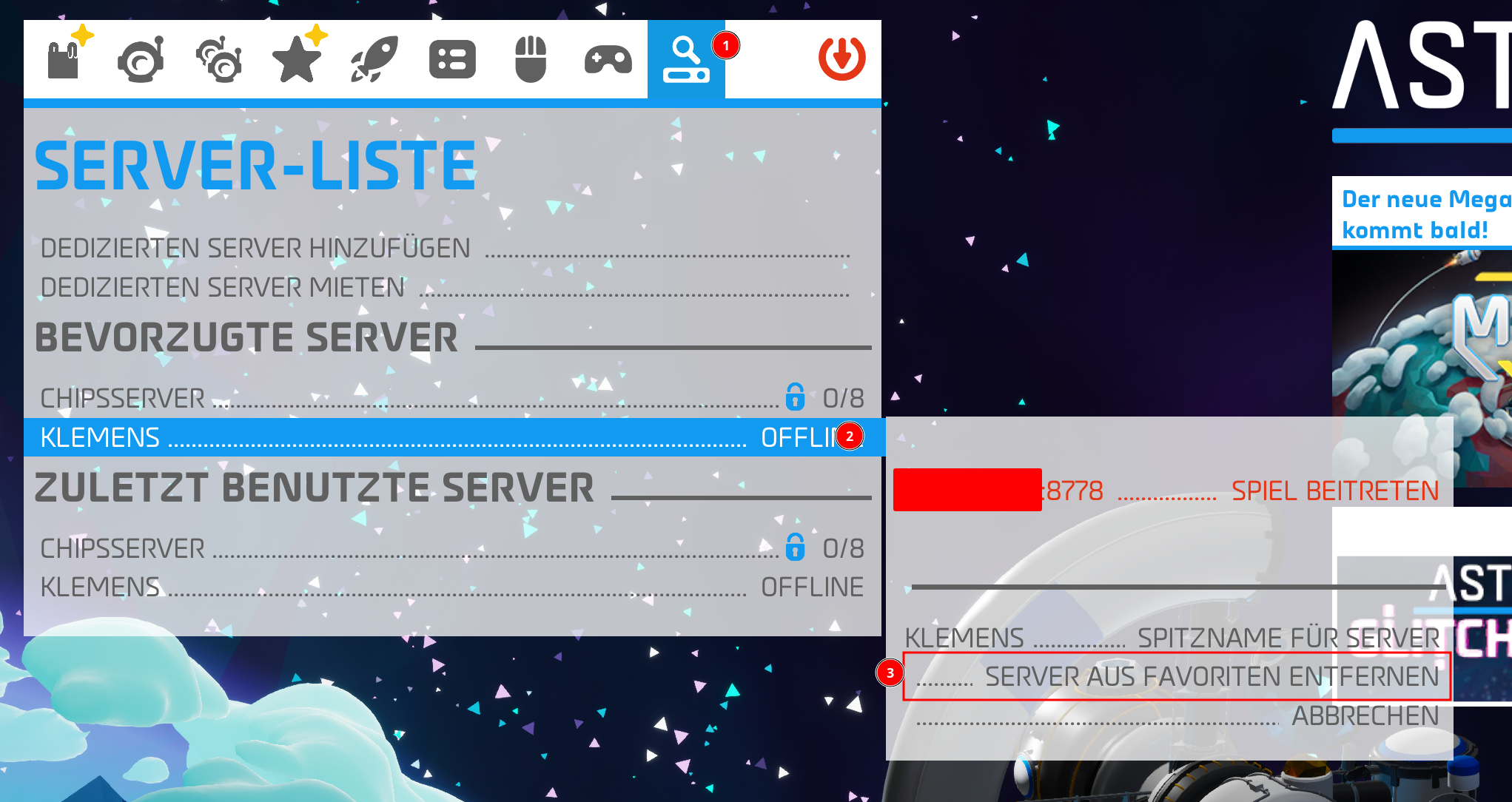

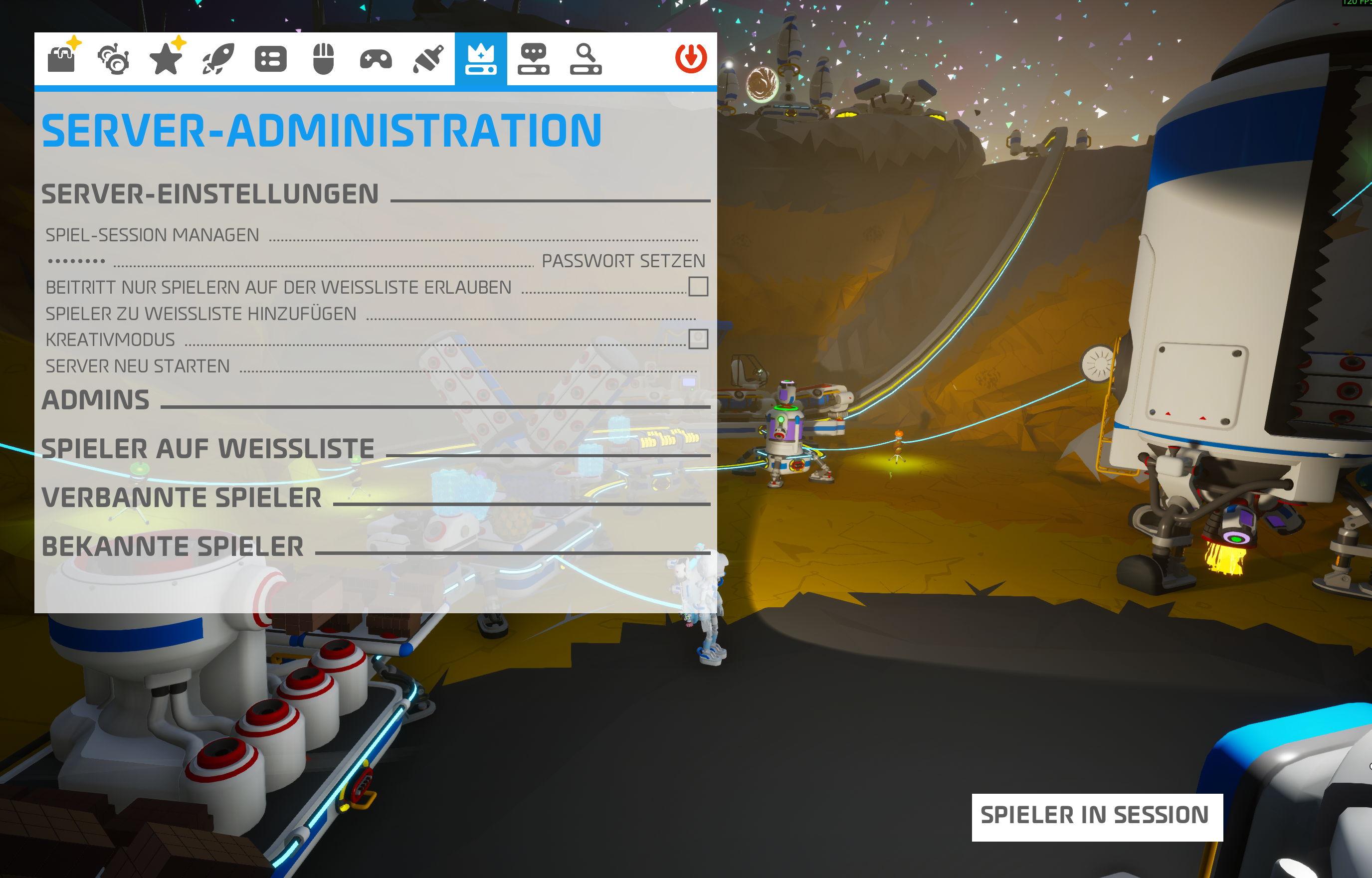

No hurry, friend! < 3 Default port, left it as is. How does one actually REMOVE servers from the game? I've not found that option just yet.

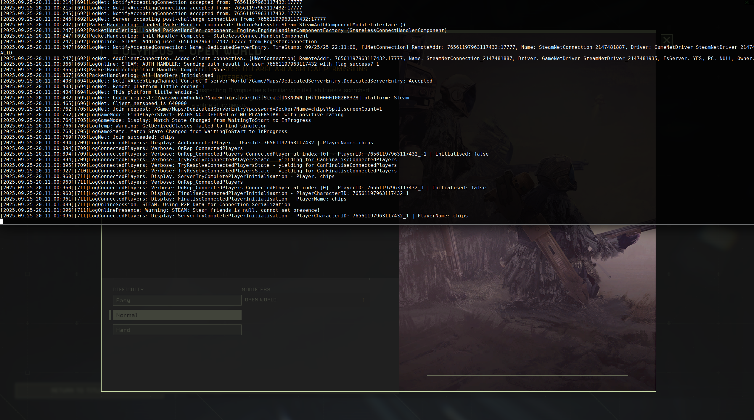

Sorry for the late response, the container is working over here just fine:
Is this a new installation or a old one? I guess a new installation, please try to set UPDATE_PUBLIC_IP to true, this will try to get your public IP before each container start and also please double check your port forwarding and if the port is set correctly, please note that you don't should do port translation so to speak port 8777 to 8778 (UDP), you have to set the port which is set in the template and even don't change that.
You can remove it here (sorry about the game being in German but I think you get the point) :
  • Replies 12.6k

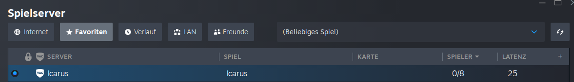

33 minutes ago, stevep94 said:
Thanks
This is really funny, since I still have it in my Favorites I see it but when I try to do a direct connection it doesn't work:
I even can connect, but only through the favorites, I'm not 100% sure what to tell you though...
You even find it in the steam Server Browser if you search it:
However I'm not 100% sure if it's worth investigating further, the container is working and you can connect to it, at least you see it in the History and when you've added it to your Favorites in your Favorites list.
I'm not 100% sure if there is a console command in game that you can connect and add it.

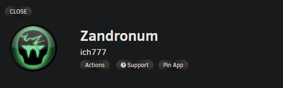

i have this problem after add m'y DOOM2.WAD
Edited by Logidroid

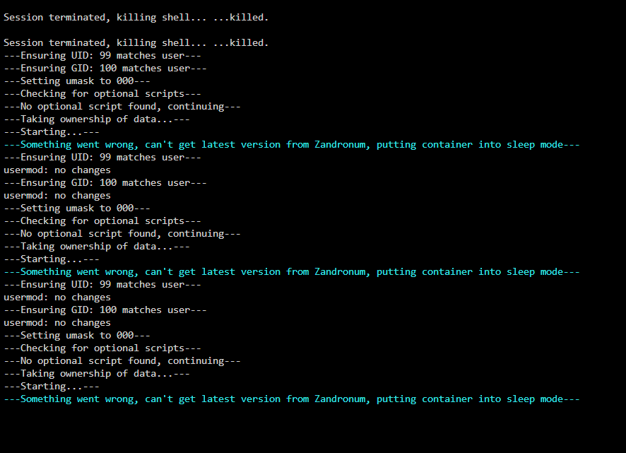

I'll take a look at that again, but I would recommend that you start over:
  1. Delete the container
  2. Delete the folder for the container from your appdata directory
  3. Re-download the container from the CA App
  4. Let it start for the first time and see if downloads Zandronum properly
On my machine the download worked fine, I assume something is preventing or better speaking not working properly on your machine.

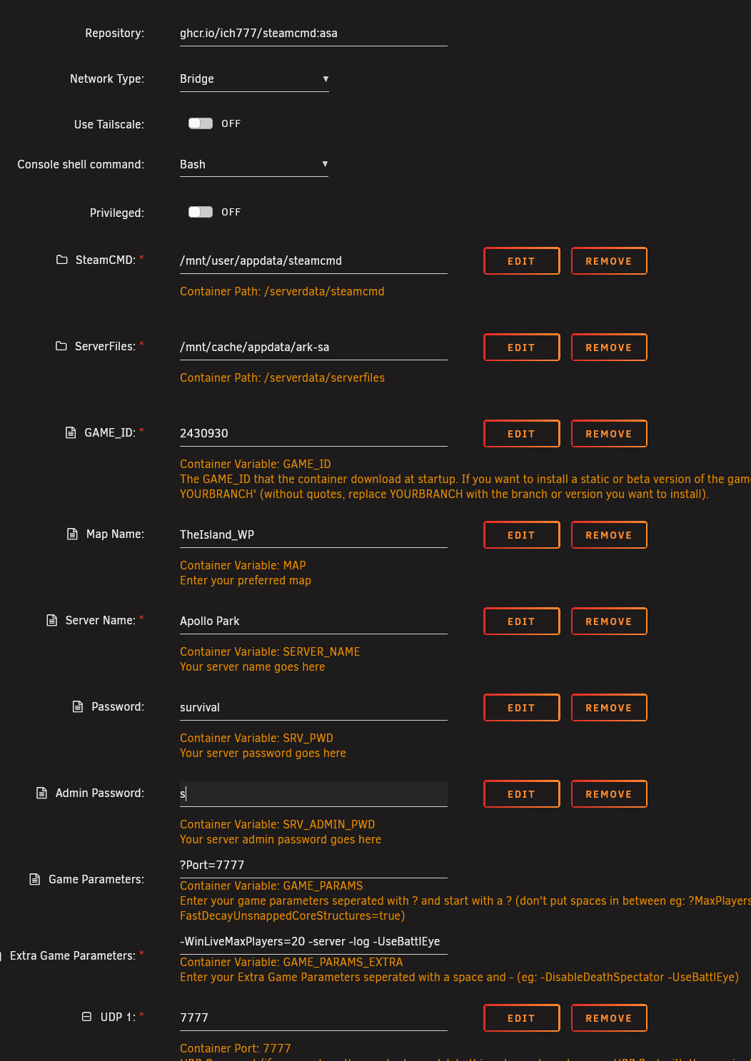

I setup Ark SA but I can't see my server when trying to join. The container log show the server is advertising for join. I forwarded port 7777 to the server IP.
What else am I missing? Appreciate the help.
Can you please explain what or how you are trying to connect?
Are you sure that NAT Reflection is working properly? Can you connect with your SERVERIP:7777
I was connecting via Ark and searching for my server in unofficial servers. I'm not sure I'm looking in the right place.
Also, I can't connect to the SERVERIP:7777. I'm assuming I should be able to
Did you change any of the settings or a settings file?
Is your server on the same subnet? Do you use the default bridge network or do you use a dedicated IP in br0 or eth0?
I’m using the default bridge network. I have not changed any of the files. I changed the container settings and that’s it. I even tried deleting the app data folder and starting from scratch but that didn’t help. My server is on the same subnet as my gaming PC. My network is basic for the most part. I have a UDM Pro and a 24 port switch and 10G aggregation switch that my servers and gaming pc are connected to.
