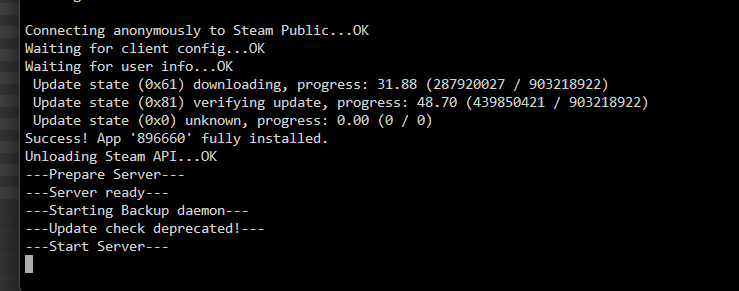

15 hours ago, ich777 said:
Please try this, it's a different game but the same applies to Icarus:
Thank you very much ich777. That did the trick!!

@ich777 Hello good sir. There was a recent update to abiotic factor that isn't downloading after restarting the container. Is there something else I should be doing to update the server?
Please try this, it's a different game but the same applies here:
