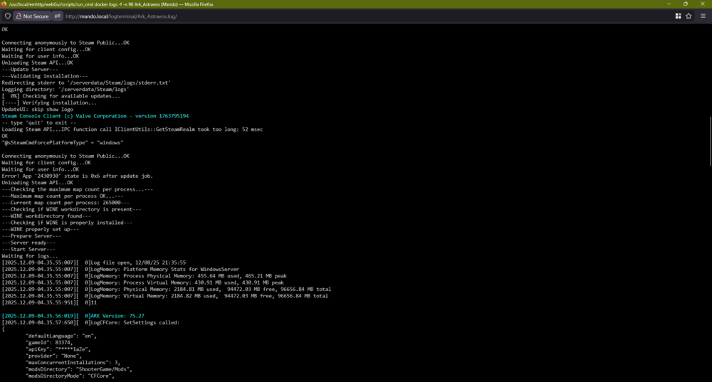

I'm having a consistent issue with Ark Ascended with updates, one I see on here for other apps, but our symptoms are different. We shut down the server every night, before we start playing we fire the container back up. If there is an ark ascended update, it will not update.
I get: 'Error! App '2430930' state is 0x6 after update job'.
However, no amount of restarting the container will resolve the issue. I've gone so far as to start a fresh container, to experience the same issue on the next Ark Ascended Server update.
I have tried turning on validate install. It did not help.
The only solution we have found is to delete the '/serverfiles/steamapps/appmanifest_2430930.acf' file, which will then allow the update to work... once.
Anyone have any ideas of a fix?
This is a SteamCMD issue, I can't fix that since if I would delete that file, every time the container starts a complete check from the already installed files is triggered and for some users it's actually working.
Any Suggestions on how to mitigate this issue for us?
Report it to Steam.
I really don't know how I can mitigate the issue since if I would delete this file everytime the container is restarting this would mean significant longer start times because a check from all files will happen and I'm not a big fan from that since for users it is working this would be a major annoyance.
However you can create a script on the host (Unraid) that you mount into the container to /opt/scripts/user.sh which deletes the files inside the container /serverfiles/steamapps/appmanifest_2430930.acf will also do the job, but I won't recommend that since this would mean every time the container starts a check is performed.

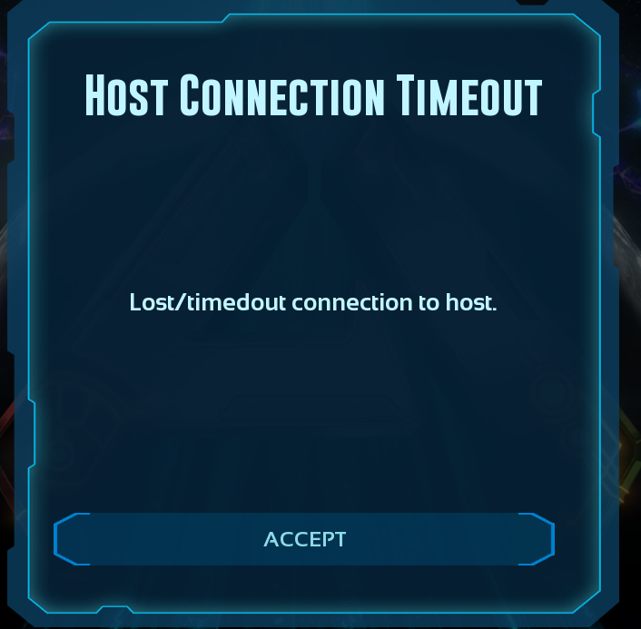

I have been trying to setup ARKSurvivalAscended server container. The server logs seem to be working just fine but I can not seem to ping the server using steam and only use the open command in ark. When i try to join through ark it keeps saying connection timedout. I tried to fix the ports, seperate them into udp/tcp and do it both but that didnt help fix the problem.
