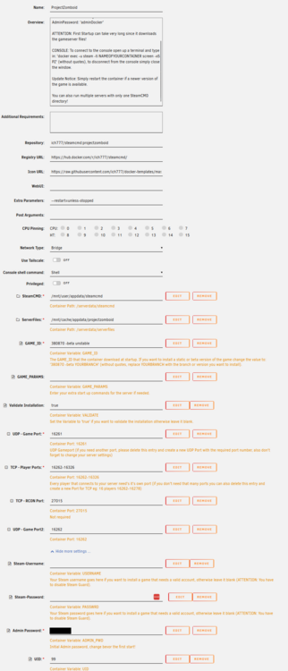

@HillyBilly Try deleting everything again and then running this from CLI:
docker run -d \
--name='ProjectZomboid' \
--net='bridge' \
--pids-limit 0 \
-e TZ="America/Los_Angeles" \
-e HOST_OS="Unraid" \
-e HOST_HOSTNAME="Unraid" \
-e HOST_CONTAINERNAME="ProjectZomboid" \
-e GAME_ID="380870 -beta unstable" \
-e GAME_PARAMS="" \
-e VALIDATE="true" \
-e USERNAME="" \
-e PASSWRD="" \
-e ADMIN_PWD="REDACTED" \
-e UID="99" \
-e GID="100" \
-p 29015:27015/tcp \
-p 16261:16261/udp \
-p 16262:16262/udp \
-p 16262-16326:16262-16326/tcp \
-v /mnt/user/appdata/steamcmd:/serverdata/steamcmd:rw \
-v /mnt/cache/appdata/projectzomboid:/serverdata/serverfiles:rw \
--restart=unless-stopped \
ich777/steamcmd:projectzomboid
Modify the password and host info to suit your server, and see if this fixes things.

1 hour ago, HillyBilly said:
Close to giving up, thank you all for your support.
8GB of system RAM is definitely too less.
On what system are you trying to run the container?
UGREEN NASync DXP4800 Plus
-Intel® Pentium® Gold 8505 @ 4356 MHz
Memory: 8 GiB DDR5 (obviously put off buying more ram all year before the price went crazy😭)
When you host the game locally on windows it defaults to 4gb, the standard branch boots fine from the container.
But please don't forget that Unraid and possibly other services also need RAM on your system and it is most likely the case that the container crashes because it has no RAM available so to speak a OOM error since for others it seems to (now) just work fine without any issues.
reinstalling for the 3 or 5th time finally got it to work. Thanks a bunch. now to figure out why my buildings are vanishing on joining the server. lol good old unstable.

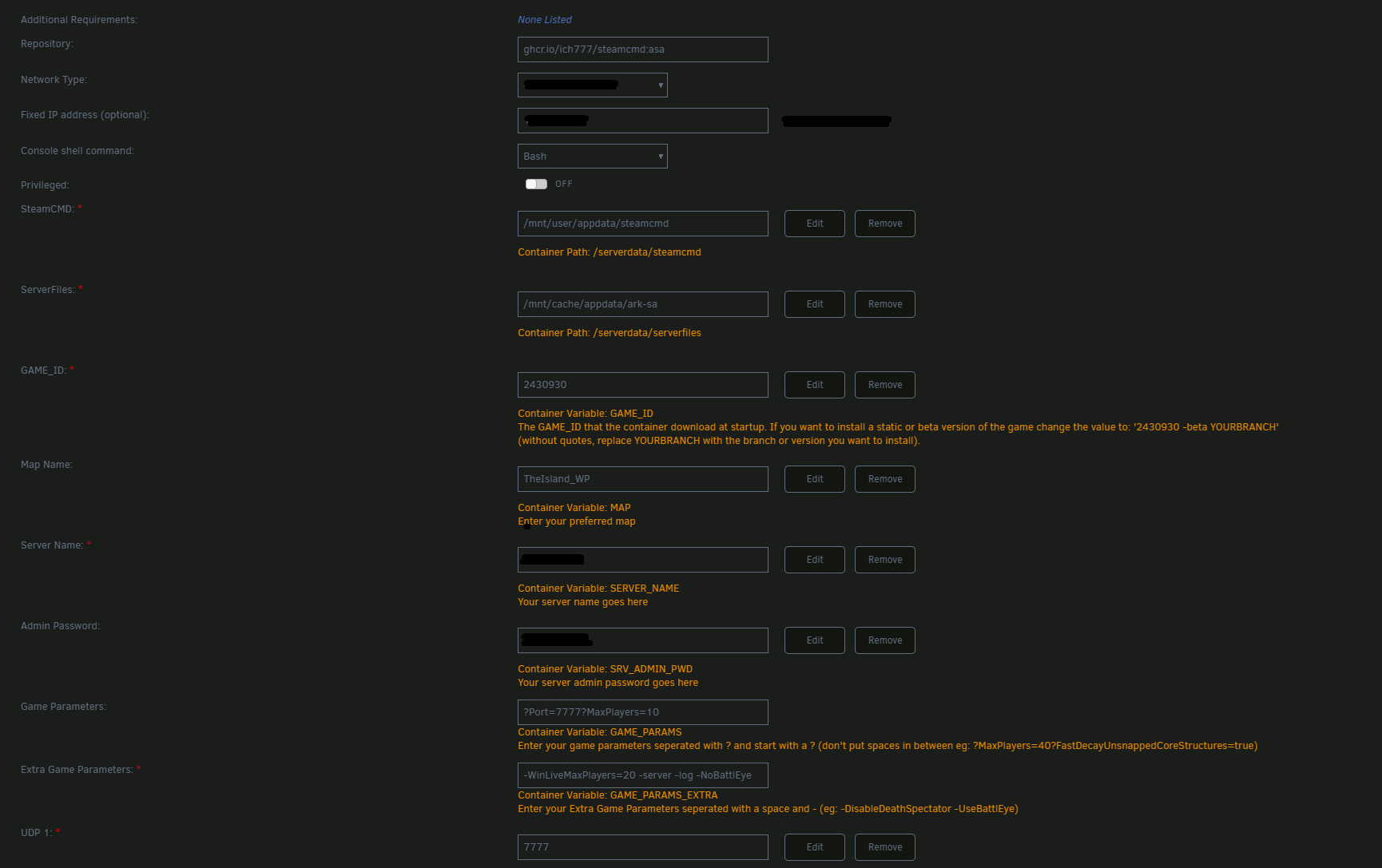

I am troubleshooting an issue with my Ark survival Ascended server running a map that was released in June of this year. The issue is when I try setting the map to "Ragnarok_WP", the server does not successfully start. I have no issues running TheIsland_WP or The Abberation map. I compared these logs to the working "TheIsland" Map and they're identical outside of the last two lines (below).
[2025.12.18-14.55.53:893][  0]Server: "************" has successfully started!
[2025.12.18-14.56.08:503][234]Server has completed startup and is now advertising for join.
Here are the full logs. I checked the stderr.txt file as well but there are no entries in it.

I've attached some screenshots of the configuration.
Update your server, 66.47 doesnt contain ragnarok, ragnarok got added in version 67, and the current version is something with 70, 76 or 77
I ended up having to delete the .acf file which kicked off an update of the game version. Appreciate the information!
