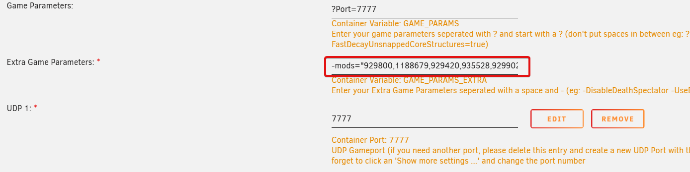

How to run mods on ARK: Survival Ascended Dedicated Server
1. Grab the Project IDs of the mods you want to run
  • Head over to the ARK: Survival Ascended section on CurseForge
  • Browse and find a mod you want to install. Click on it.
  • On the mod's main page, look on the right-hand side for a section called "About Project" .
  • In that section, you'll find the Project ID. Copy it! It should be a string of numbers.
Tip: I made a list of all the mods I wanted to use and copied all Project IDs in a notepad. I separated them by commas, for example: 929420,929231,929878
2. Add the mods to your server configuration
Now we need to tell the server which mods to load.
  • In your Unraid web interface, go to the "Docker" tab.
  • Find your ARK: Survival Ascended container and click its icon, then select "Edit".
  • Scroll down until you find the field for "Extra Game Parameters"
  • In this field, you add the -mods argument. Be careful about the format, look at the examples.
Example for a single mod:
  • -mods="929420"
Example for multiple mods:
  • -mods="929420,929231,929878"
3. Start the server and check the logs
The first time you add mods, the server will need to download them. This can take a few minutes. To check the progress or when troubleshooting, click the ARK: Survival Ascended container and click its icon, then select "Logs".
You are looking for a line that confirms the mods are being loaded. It should look something like this:
  • [2025.07.25-13.05.54:685][ 14]UShooterEngine::LoadGameMods with 12 mods
The number (12) should correspond with the amount of mods you have running.
Good luck with running mods on your dedicated server! Special thanks to both ich777 and Mainfrezzer for their contributions!

thanks in advance for your help :)
log.txt
Please update the container itself and try again.
Did you change the path to the game files in the Docker template possibly to /mnt/user/appdata/... if yes that might be the root cause of the issue, most GoldSource and Source games need to point to the physical location from the files so to speak /mnt/cache/appdata/... or /mnt/diskN/appdata/...
