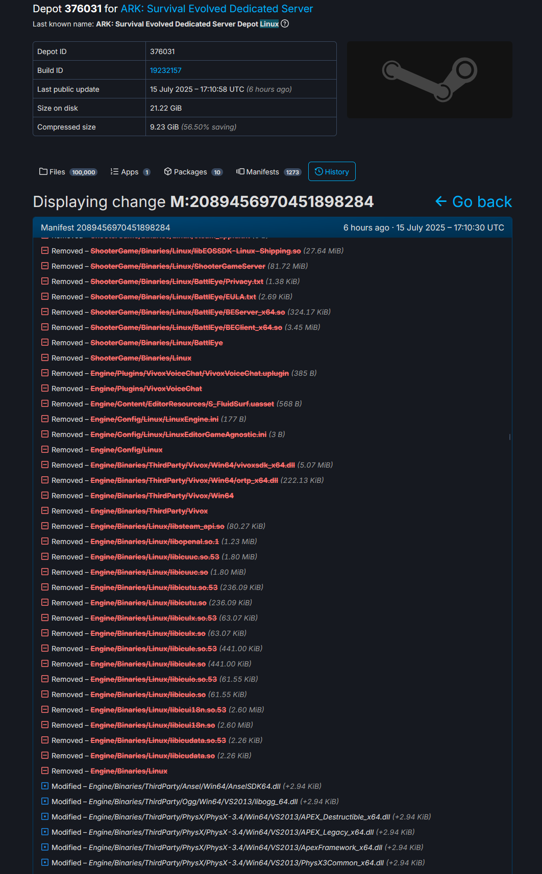

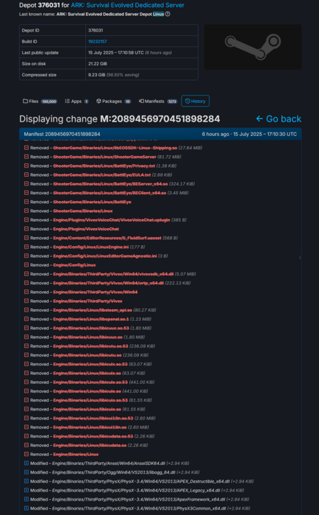

Hello,
First id like to thank you for all the great work you have done on these containers, they are great!
Ive been having some issues getting mods to automanage as well as having allot of issues with changes to the gameuserfiles.ini for the Ark SE server container. Usually resulting in a game never starting up even after 20-30 min.
I am starting fresh, including a new share and completely fresh install of the container and am now getting the following error:
/opt/scripts/start-server.sh: line 56: cd: /serverdata/serverfiles/ShooterGame/Binaries/Linux: No such file or directory
---Something went wrong, can't download Librarys, putting server in sleep mode---
rm: cannot remove '/serverdata/serverfiles/ShooterGame/Binaries/Linux/lib.tar.gz': No such file or directory
I just wanted to confirm if its possible this is related to the Ark update that came recently or if this is an issue on my side.
Please find attached some screenshots to support my issue:
https://steamdb.info/depot/376031/history/?changeid=M:2089456970451898284
Best,
- Musa
Edited by musanajam11
adding more context
I'm not sure what they've did but now the AppID 376030 downloads the Windows Dedicated Server and not the Linux Dedicated server, maybe they have abandoned it?
I'll pull the template for now from the CA App.

@Mainfrezzer already investigated a bit further and it seems they broke a lot with the latest update, we'll have to wait.
I can't guarantee that I can fix it in a reasonable amount of time if they release a fix on their end, however I'll try.

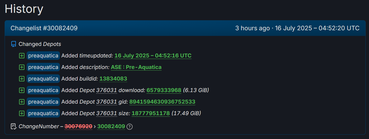

Since im still stuck updating the game on windows (over 1 hour already) im a bit limited to check everything at the moment. They at least acknowledged that they broke stuff^^ (although theres more broken than just mods)
But from what ive seen so far its more than likely that they dropped the linux support completely since the last "working" linux version already had huge memory leak issues.
New Client versions also cant join any old server, so if you use the preaquatica branch they pushed, you need to downgrade your clients as well.(who knows how that works with epic)
As for a possible "quick and personal solution", if you dont run mods
You could get your servers up and running with the new patch if you swap to my container image for the moment (ghcr.io/mainfrezzer/ase-docker:latest), it runs the windows binaries instead of linux.
Things to note there: it needs "--ulimit nofile=2048:65530" in extra parameters to run
Also, any link you might have placed in the unraid template probably doesnt work because of weird character escaping. If you have a banlist, dynamicconfig or sorts like that, declare them in the appropriate .ini config file (also dont forget to copy the LinuxConfig files to the WindowsConfig folder)
As for mods not working, nothing that we can do apart from rolling the servers back to preaquatica

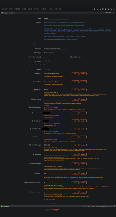

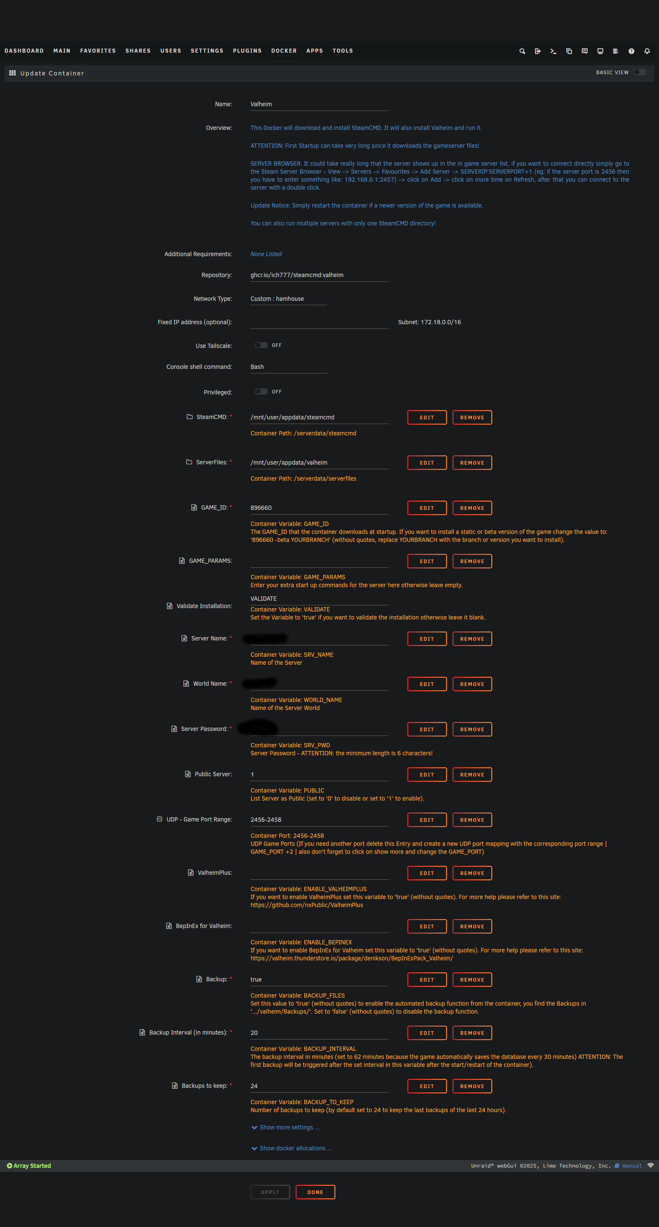

Having a problem with the Valheim server. I had installed a while back but this is a clean install on a new device. I get the following error
[S_API FAIL] Tried to access Steam interface SteamNetworkingUtils004 before SteamAPI_Init succeeded.
src/clientdll/cminterface.cpp (2124) : !BLoggedOn()
This is not strictly an error, this is just a warning.
How much resources does the container consume, usually that message means that the container is running and waiting for connections.
After that "warning/error" it fails to generate any world. It installs the game and that's it. NO world generation. Is that normal? How do I find out how many resources it is using?

Do you have special characters in your password or server name?
Is your password at least 6 characters long?
Please remove VALIDATE from the Validate variable, that won't do anything.
Resources however seem fine for a running server.
Is the container constantly restarting or is it sitting there after Starting server?
You posted a log where it pulled an update.
I removed the VALIDATE option, having reinstalled it. It's stuck on Start Server. Attached my world and server name if it helps. Password is alphanumeric 6 characters.
