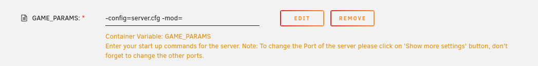

I am having trouble figuring out exactly where I need to add the additional parameters to an Arma 3 server to force it to download a different server branch.  I'm trying to get a small CO-OP server setup that runs the Prairie Fire dlc, and it require the creatordlc server branch.  I've tried adding it to the "additional parameters" line of the docker config under the advanced view, but that fails.  Tried adding it to the server/game ID and it just disappears.
I'm not super skilled with the finer points of docker containers, so I'm pretty lost.  I don't believe it can be configured to pull server branch's through any of the server configs, it has to be done with a steamcmd parameter, just can't quite figure out how to do that with the container, and make it persist through container restarts.
GAME_ID and you have to enable validation if you switch the branch.
The variables should have a description where it is described.
However if you want to add a DLC that involves cost you possibly have to log in which is not possible in my container if 2FA is enabled.

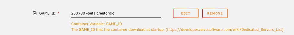

As far as the arma server goes, this is what I need to get steamcmd to download the proper server branch "233780 -beta creatordlc".  Not sure how to get the extra parameter to actually persist after restart.  I put all of that in the "GAME_ID" section of the template and it didn't appear to do anything.
  I do have a secondary steam account that is strictly for hosting servers, so i'm not worried about 2FA, however, the server account only has to own Arma3, only the clients need to own the paid dlc.  I did have it all setup on a windows host, but I'm tired of wasting CPU cycles and RAM running a VM when I could just run it all in docker instead.
You have to enable validation in the template if you switch branches:
and finally:
I'm not following about the extra parameters, these are usually passed through here:
The Docker containers are not that different to like if you deploy it on a dedicated machine, the containers just do everything automated on startup, so to speak download and start the game, everything else is handled like if you run it on a dedicated machine.

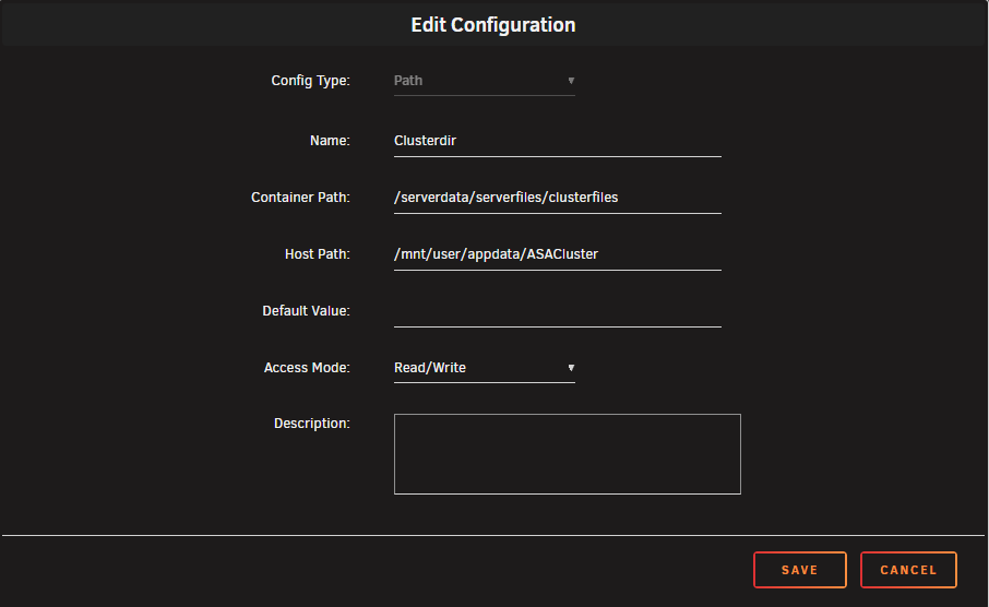

What I can't figure out is how to override the cluster save location and put it somewhere outside the default container paths so I can spin up another instance in a container and actually get it clustered.  I'm sure it can be done with path mapping in the template, but my brain has trouble keeping those straight. lol
Sorry but I can't help with that, maybe @Mainfrezzer can help you with that issue because I don't even play ASA nor have I ever set up a cluster.

Got it figured out as far as Arma 3 is concerned.  I must not have set it to validate the first time I tried.  Wiped the container and folders, then re-installed the container with the proper config variables and it appears to have grabbed the correct server branch this time.  Now onto the tedium of configuring the server itself.  Many thanks
@Mainfrezzer Would you mind pointing me in the right direction as far as ARK SA is concerned?  Didn't want to just DM you without warning.
its the same as it was in ARK:SE
With "-ClusterDirOverride=/serverdata/serverfiles/clusterfiles" (this should be the default) in the "Extra Game Parameters" you can select where wthin the container filepath you want the cluster storage to be.
So if I am understanding correctly, I can move all of my cluster data/saves into a folder/location of my choosing, lets say, in the "appdata" share, and then add a path to the container that points to that path on unraid, and presents it as /serverdata/serverfiles/clusterdata to the container?  Then obviously set the cluster dir override launch parameter and that should make it possible for that container to access it, but also for any other ARK containers to access it too?  I get spun around and have trouble wrapping my brain around docker pathing, I'm not a fan of it. lol
if you want to keep the default save location as it is (which isnt a bad idea) you can just create a path mapping via the unraid template like this
Many thanks, pretty sure I've got my head wrapped around it now.  Off to experiment and hopefully not break anything. lol

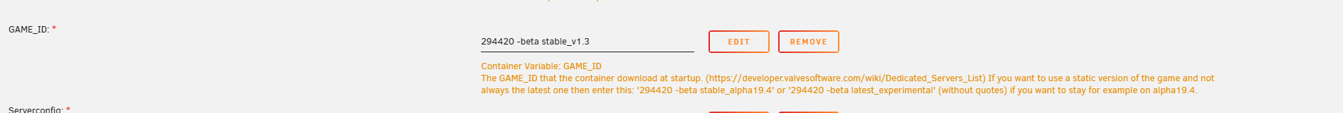

is there a way to go back a version from 1.4 to 1.3 on the 7 days to die unraid docker.
is there a way to go back version from 1.4 to 1.3 on the 7 days to die server docker
@Spectral Force can you please help here.
Instructions are in the template under appid. Im at work right now so cannot give the detailed response but gimmie a bit and I'll follow up.
sorry I'm a little new with this stuff but where is the appid located at
Sorry, in the template it is Game ID
ive tried to enter it a couple different ways but it giving me failed to set beta also failed when i entered it exactly the same as what it says in the instructions below
