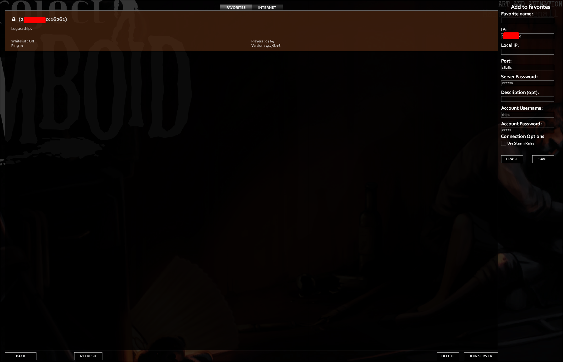

21 hours ago, jeremytodd1 said:
Even with a bridged network, only the local ip address can connect to the PZ server. In game, the external ip server shows as "The server is not responding" still.
This screenshot is with the container in bridged mode. You can see the local IP sees it with no issue but the external IP cannot.
Not sure if relevant in this case, but I've had a few containers running on a separate network segment/vlan, where I had to manually add a static route in my router/firewall for said subnet(s) (with the unraid server ip as the "next hop"), before everything worked correctly.
Might be worth a try.

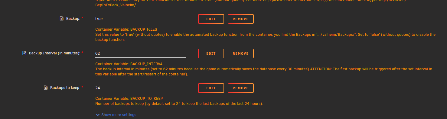

Hey, I'm trying to run a Valheim server and it showed up for my friends when I first started it but it is no longer showing up or working for them. I can still connect with an external IP but my friends can't connect using it. Any ideas on what I could be doing wrong? I can upload photos as needed to figure this out.

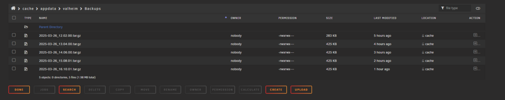

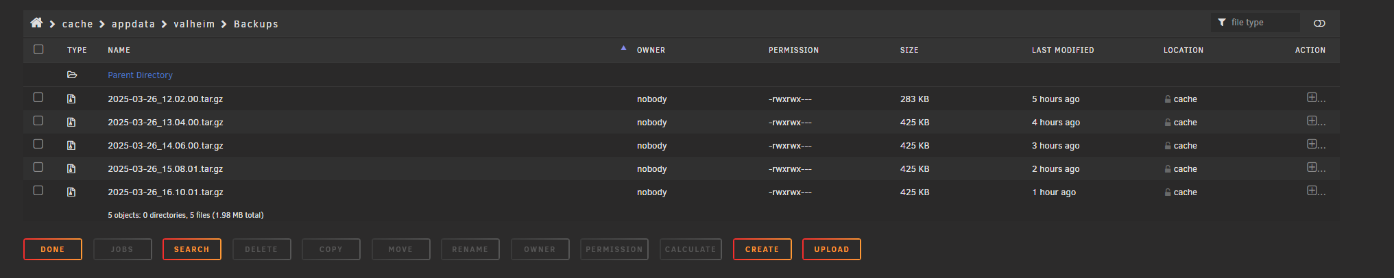

Hi Ich,
First of all, thank you for your work in producing these containers. Super helpful for noobies like myself.
I have a huge issue I just ran into though and I'm not sure what to do...
I restarted my Unraid server today (7.0.1), Valheim updated when it came back up, and when I join my server, I'm put into what looks like the same world I had before, but the map is totally refreshed. Nothing I built is there, the trophies from the bosses are gone, all the fog of war is back on the map, and I'm spawning where you first spawn when you first spawn into the world in the center of the stones.
I restored my world from backup (there were only six backups despite my settings dictating 24... not sure why) but it's the same. I don't see any backups over 6 hours old and the restart was over 6 hours ago early this morning.
Any ideas on how I can restore my world so I don't lose everything I've built and all the items in all the containers I had?
Why didn't I manually back up the world to a backup drive? Every time I try to copy the world files to another drive I get "Invalid target" with unraid. No idea why, the unraid ui is allowing me to navigate the file structure, the drives are in the unraid array itself and accessible, but always invalid target so I've been unable to backup the files from the cache/appdata/etc etc folders including the world.
Why would a system restart do this? Or why would a restart of the container and an update do this? Screenshots show my backups folder and relevant container settings. Here is the most recent log output where you can see the update.

Any help is greatly appreciated. This is my first time hosting a game server and I really don't want to put in all this work only to lose the world I spend hours exploring and building in.
Edited by whisp

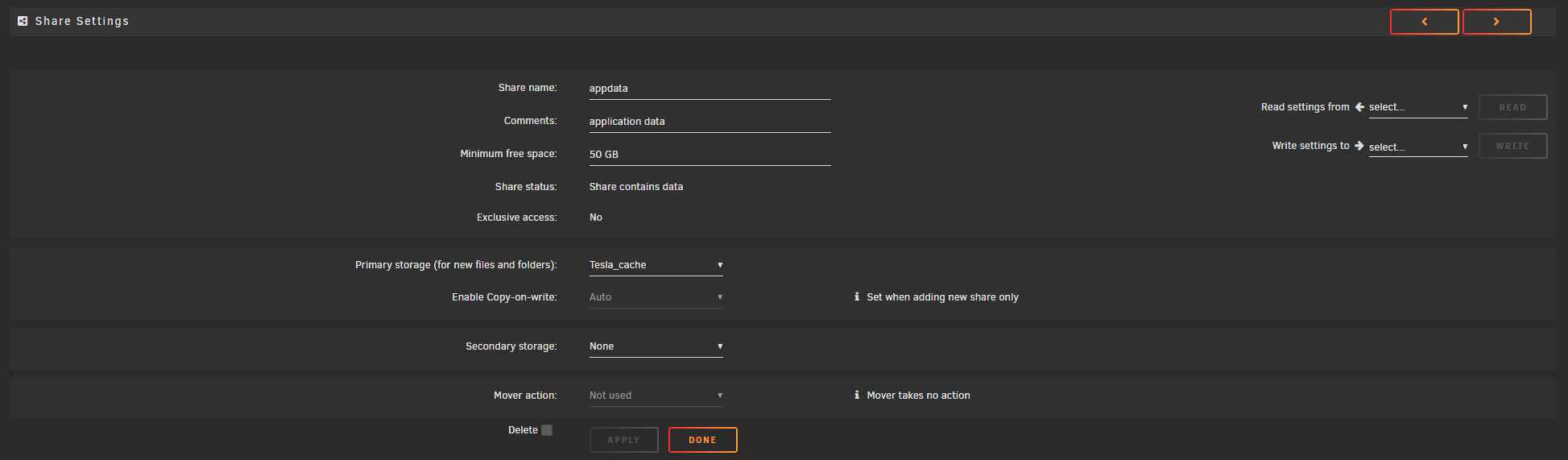

Is you appdata share set to be moved to the Array, if yes this si your issue.
No. In fact cache/appdata is not in a share at all. User/appdata doesn't have a secondary storage so no mover.image.thumb.png.a0400c7afd23657b280b685cfeba8b7f.png
Edited by whisp

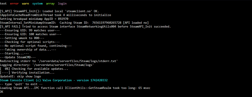

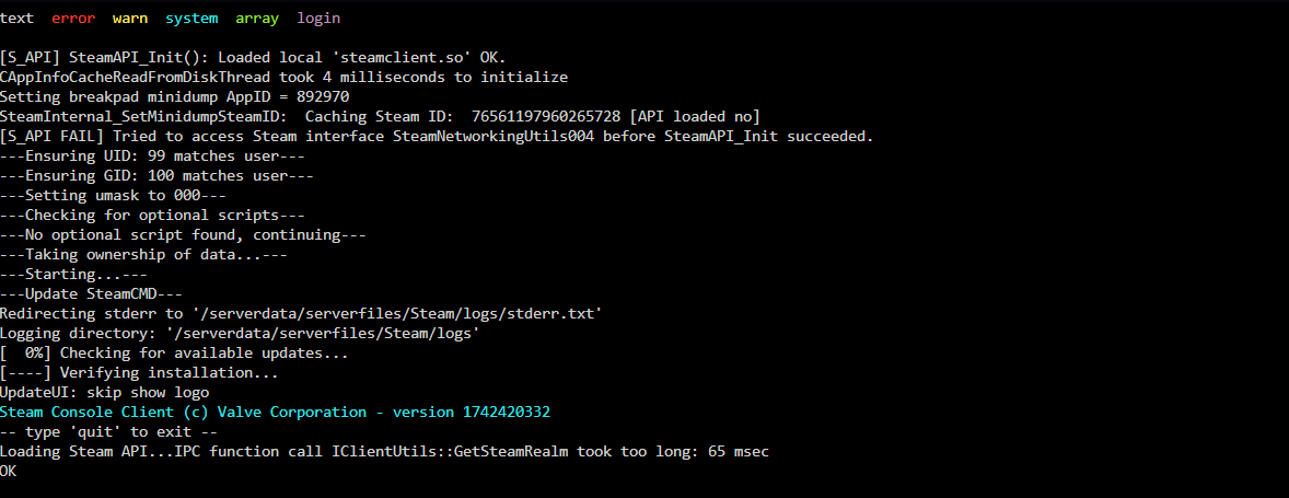

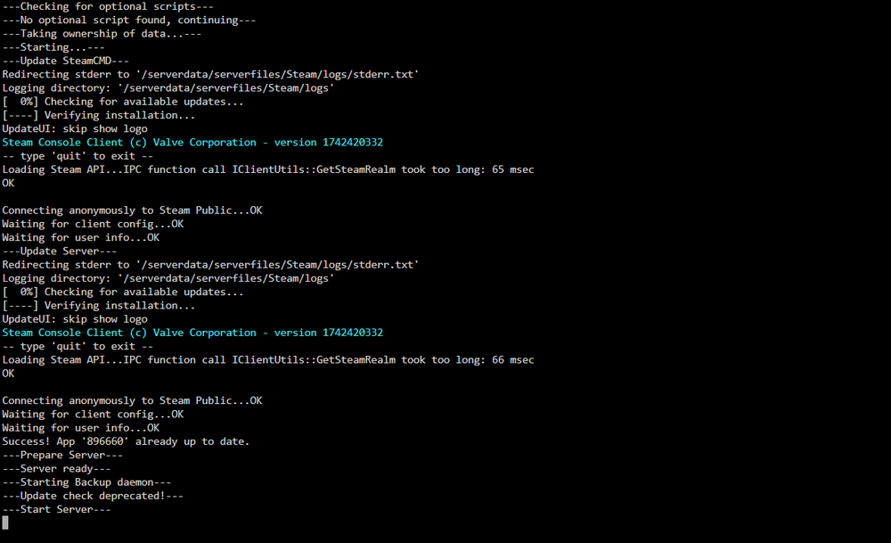

16 hours ago, ich777 said:
Any error message or something?
Do you have any UniFi network gear? Please check the logs, it might be related to that.
I didn't see any error messages and I don't use any UniFi network gear. This is the log that I have.

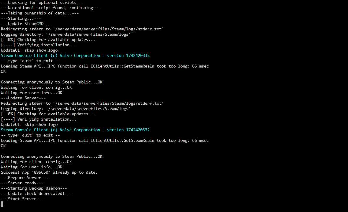

I restarted it and got this at the end as well.
On 3/23/2025 at 8:13 PM, jeremytodd1 said:
I'm trying to host a Project Zomboid server for a friend and I to play on. I've done everything right I believe but neither of us can join when using the external IP address. I can join the server using my local ip address with no issue.
Here is what my container settings look like (the ip address shown)
On my Unifi network, I have port forwarded the required settings, shown in these two screenshots:
Nothing to worry about, just a normal warning.
Everything seems okay.
Strange that you can join with your public IP but your friends not since this should basically work. Do you have a static IP or a dynamic IP?
Does the server show up in the server list?
To what is the path in the Docker template set?
