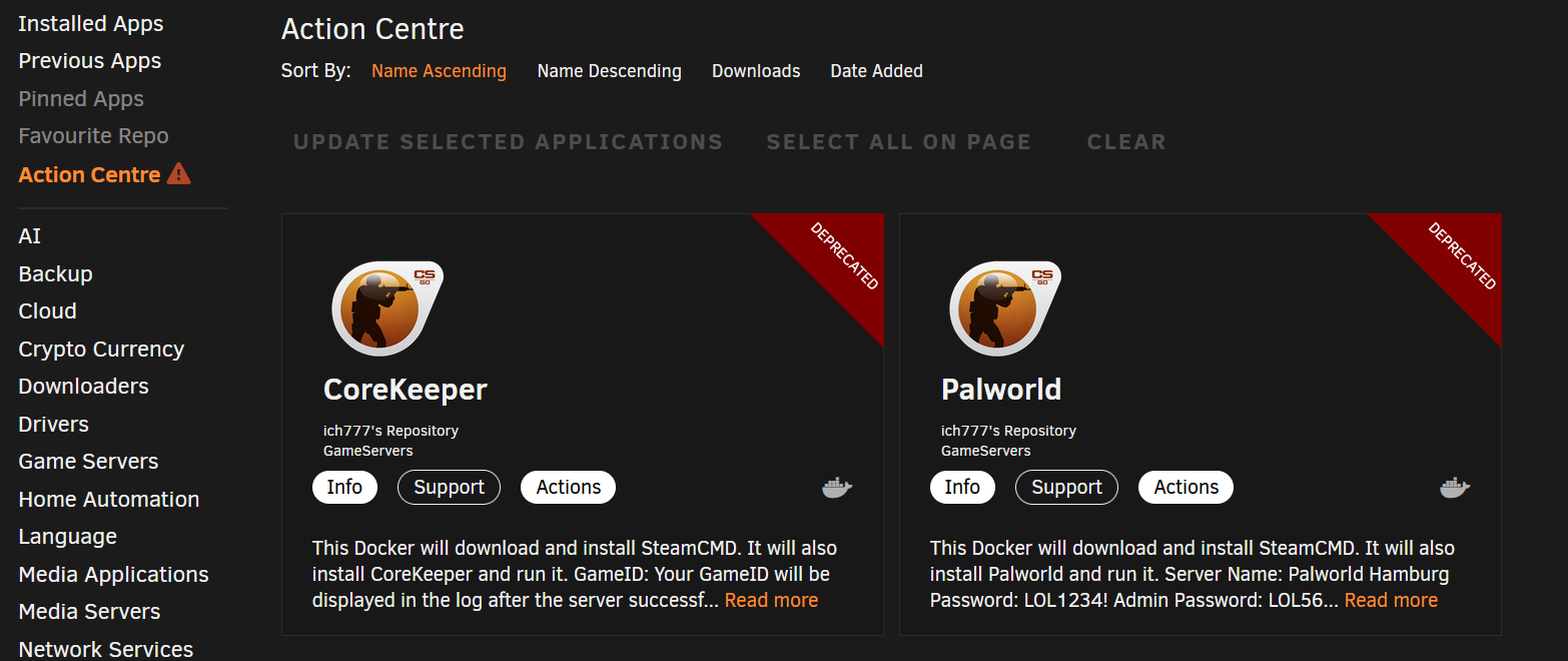

Hi ich777,
why are you servers being shown and deprecated in community apps?
Did I miss something?
Possibly because I switches repositories from DockerHub to Git Hub Container Registry because of the upcoming change in the Rate Limits for DockerHub.
If you search the app in CA it‘s still there.
Maybe try to switch the repository in the template by adding the prefix:
ghcr.io/
like this?
ich777/steamcmd:7dtd ghcr.io/
Sorry, I wasn't clear enough, like this:
ghcr.io/ich777/steamcmd:7dtd
Thank you :)

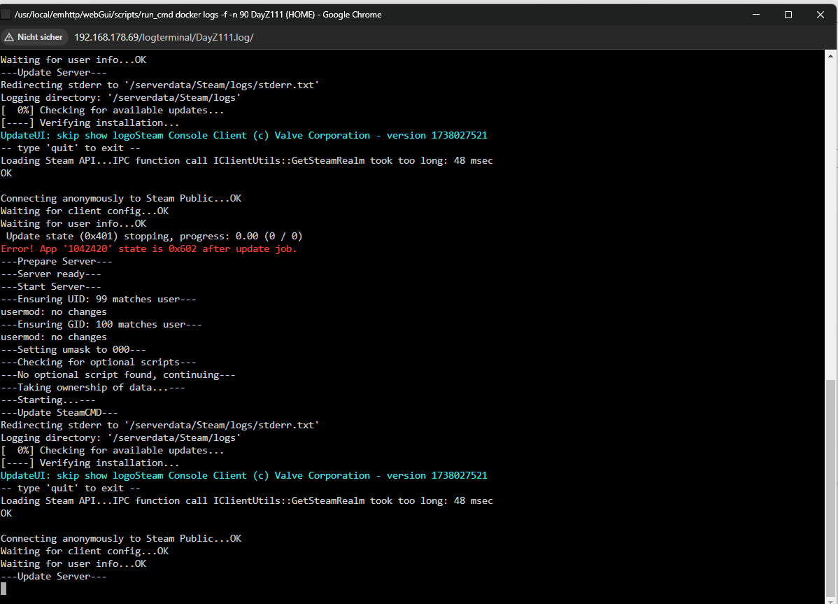

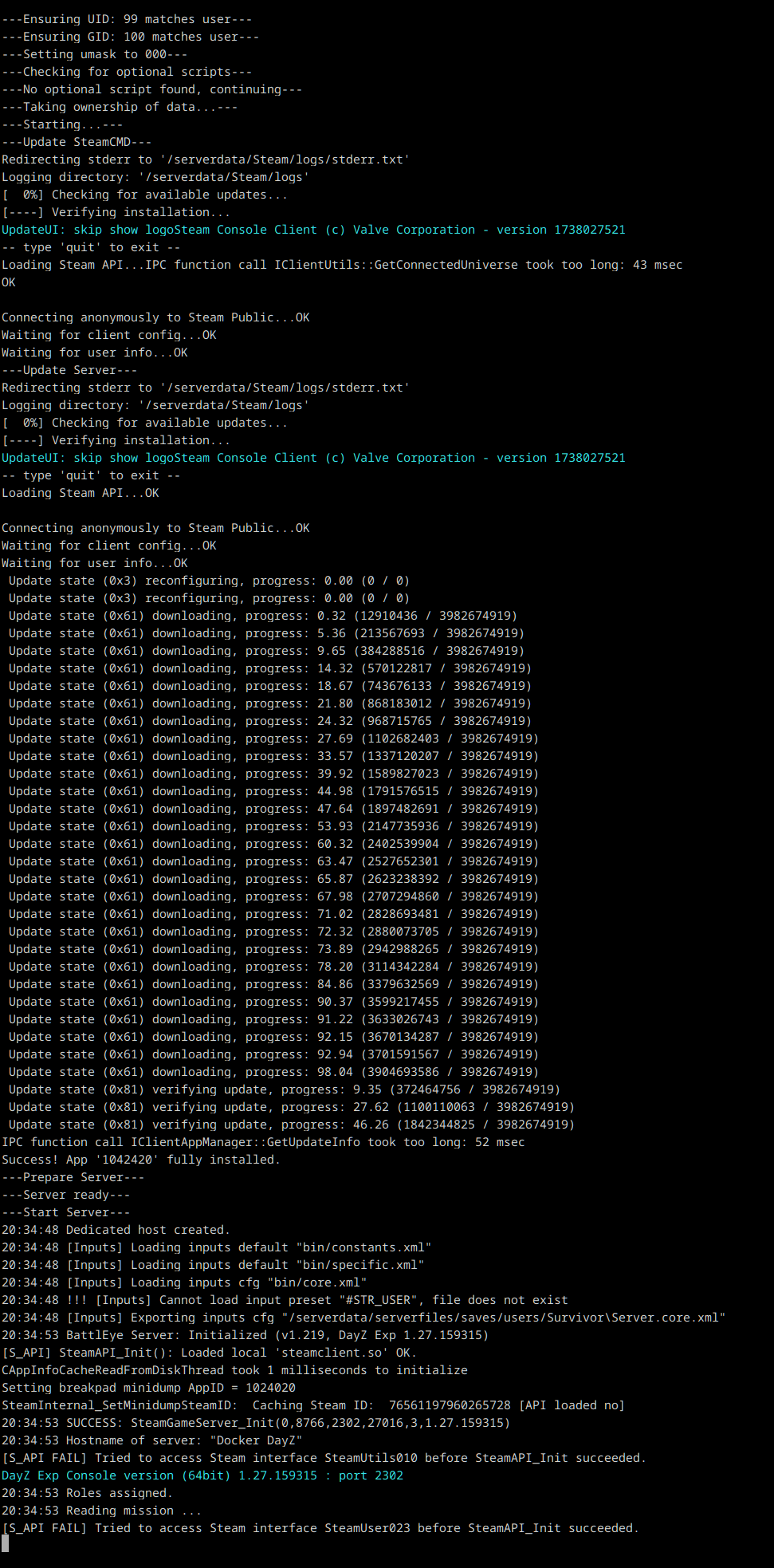

Having trouble getting  Icarus server to run on Unraid, no errors just wont start.
any help would be appreciated, below is far as i can get for the life of i can not work out why
What is the exact error?
I assume the log ends there and is not restarting correct?
How many resources does the dedicated server consume, did you maybe restart the container at some point when it was starting for the first point? The setup process for Icarus teaks really long, up to 10 minutes, however if you did restart the Docker container please do the following:
  1. Remove the container
  2. Remove the folder for Icarus which lives in your appdata directory
  3. Pull a fresh copy from the CA App
After that wait until you see the Start Server message and don't restart the container even if it looks like the container is doing nothing.

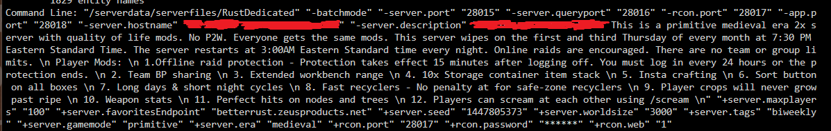

ich777,
First and foremost, thank you for creating all the containers that you have, I'm using the rust one now and besides one little hiccup it was super easy to set up and is working flawlessly. I'm running into an issue with my rcon port. I have the port open in my router for 28017 and I've specified it in my game parameters. The start up logs looks like it's working too. When I try to connect though on http://rcon.io/ I get an error. Here are a few screenshots for the game parameters and the start up log. Any ideas?
GPamscreenshot1.png.9206e7d4b467dc45e767c2091582cb7e.pngGPamscreenshot2.png.5315e73289c89f56688f9ef240f8c761.png
Edited by J-Cali
With what IP are you connecting to the container, please note, even if it's web RCON, you have to connect with your local IP.
You rock! Thank you so much. Idk why I didn't think of that. I was trying to connect via the web IP.

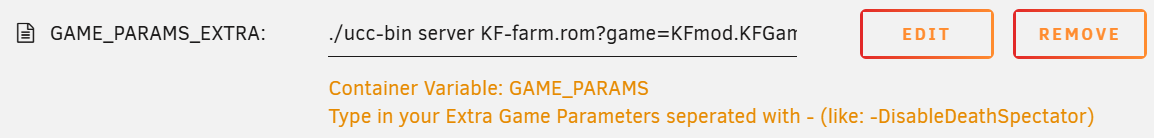

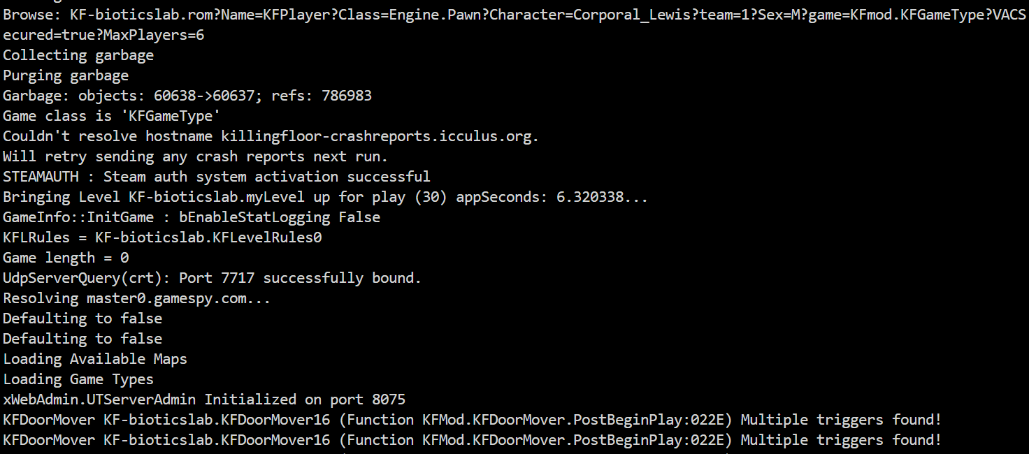

I have successfully Hosted Killing Floor but don't know how to modify Launch Startup. I tried changing in GAME_PARAMS_EXTRA but it didn't work.
Please help me.
It will be after i set GAME_PARAMS_EXTRA
Edited by huymetruoi
Because you shouldn't do it like that, what do you want to edit/add exactly? You don't need to include ./ucc-bin
This is a hard coded line:
${SERVER_DIR}/System/ucc-bin server KF-bioticslab.rom?game=KFmod.KFGameType?VACSecured=true?MaxPlayers=6${GAME_PARAMS} -nohomedir
I want to change the server startup command to my own, not the default because my server uses gamemode and customizes a lot of things.
Example: ucc-bin server KF-CustomMap.rom?game=CustomGameVACSecured=true?Mutator=ScrNBalance?MaxPlayers=30... (Example).
Please update the container itself with 'force update' (with Advanced View enabled) on the Docker page from Unraid, after that you can use it like that:
so to speak like:
please don't add 'ucc-bin server', this field is only for game parameters, you could of course add '-DisableDeathSpectator' or anything like that but please make sure they are valid game parameters, this would then look something like:
KF-CustomMap.rom?game=CustomGameVACSecured=true?Mutator=ScrNBalance?MaxPlayers=30 -DisableDeathSpectator
Hope that helps.

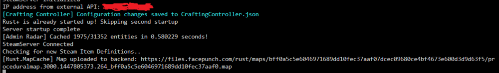

1 hour ago, BootyWarrior said:
No joy there either. I'm sure I'm missing something stupid, please help. Haha. Thanks.
Rust uses WebRCON and not the simple RCON and you should be to connect through this site here.
Please note that you have to connect with your SERVERIP:RCONPORT <- not your WAN IP!
