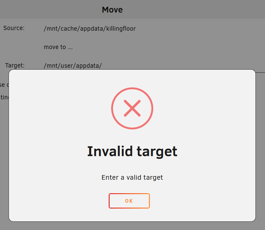

5 hours ago, huymetruoi said:
Because when I install other than default, Host cannot start.
Do you mean the container wont start and/or simply crash? If this is the case some dedicated servers have issue when using /mnt/user/... instead use the real path to the files like /mnt/cache/... or /mnt/disk3/...
Please make also sure when you are using the real path that the share you are using is actually configured to stay on that drive and is not moved to somewhere else in the Share settings from Unraid.
How to move the default installation directory (/mnt/cache/appdata/killingfloor) outside for example /mnt/USER/HostGame/killingfloor.
Stop the container, move it where you want to have it physically on Unraid and in the template change the path as pointed out above.
I cant move :( . The container start and freeze, maybe reboot loop.
you cannot move from real disks (i.e. cache/appdata/) to the FUSE-System (ie. user/appdata)
You have to move from cache/appdata to cache/appdata
Do we have a plugin to edit files or share folders from cache/appdata via SMB Share?
You can just expose that share via smb. But you dont need that if you just move the files.
You just cant mix while moving.
If you pick anything in the gui from the disk1 for example, your target has to be any disk, not fuse target.
So from disk1 to disk5 or from cache to disk3
if you pick something from the fuse system, user/ your target has to be user/ once again.
Its a safety feature
