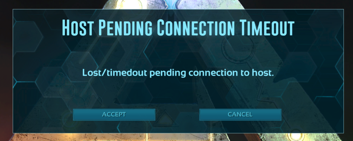

Hi Guys hope anyone can help me.

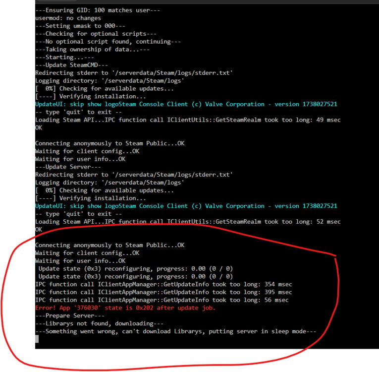

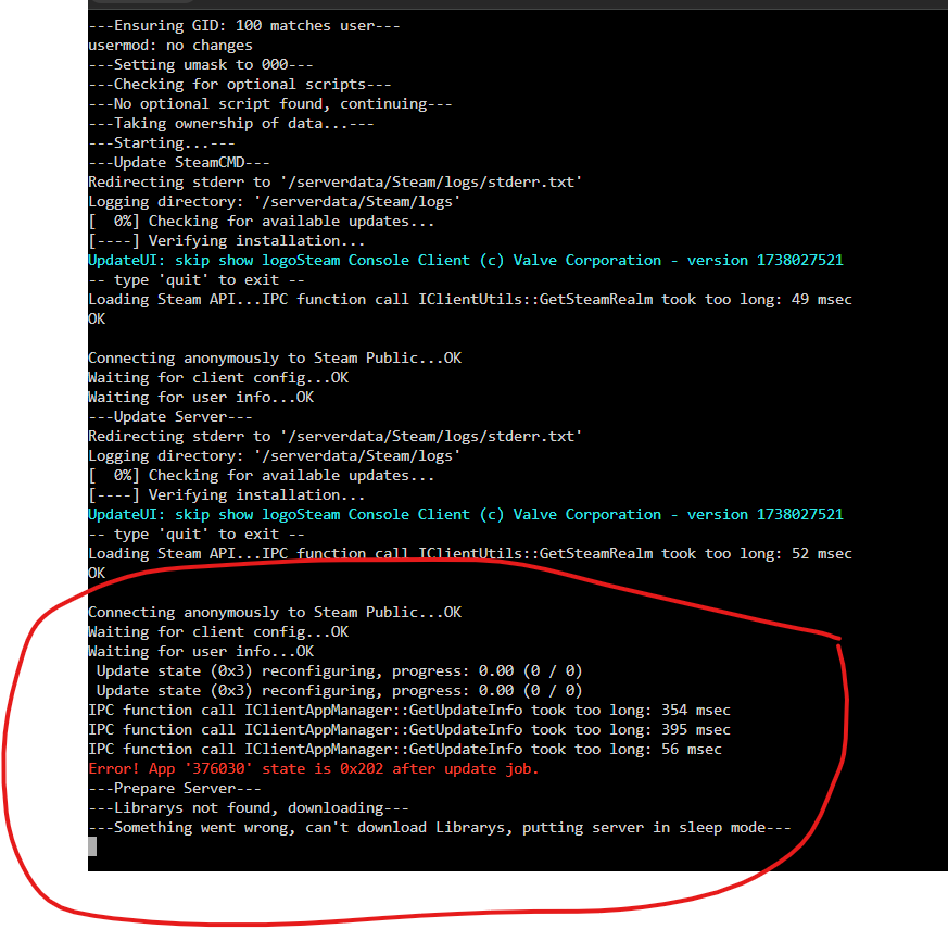

I just startet my unraid some days ago and wanted to install the ARK SE Server. I can create it but in the logs it shows there is a problem with download.
I already testet the connection to the internet and its stable from the docker / Host.
This issue is related to out of space IIRC, please do keep in mind that a few users had issues when using ZFS and not using the real file path like /mnt/cache/...
I'm also not sure why the download from the Libraries fail because this basically means you are really haven't got any space left (at least it thinks it hasn't any free space) or it really don't has a connection to the Internet.
Please try:
  1. Remove the container
  2. Remove the folder for ArkSE from your appdata directory
  3. Pull a fresh copy from the template from CA
If you have Unifi gear on your network please double check the Firewall logs since it's IPS/IDS is a bit to strict sometimes.

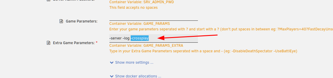

Having a few issues with the Astroneer container. It's experimental, so I understand if this is simply something we have to live with.
Currently when I run the container, it seems to get stuck at --Start Server--.
As per the instructions for the container, I did set the engine config change. Though, due to the fact it seems the server isn't able to even launch, I doubt it's due to this. I also made sure it didn't have any conflicting ports. It doesn't crash, it hangs. I'm unable to find any logs, apart from the ones I took below from the Unraid Logs via the GUI.
Network wise, I was unable to connect via the public IP or using the local IP of my server.

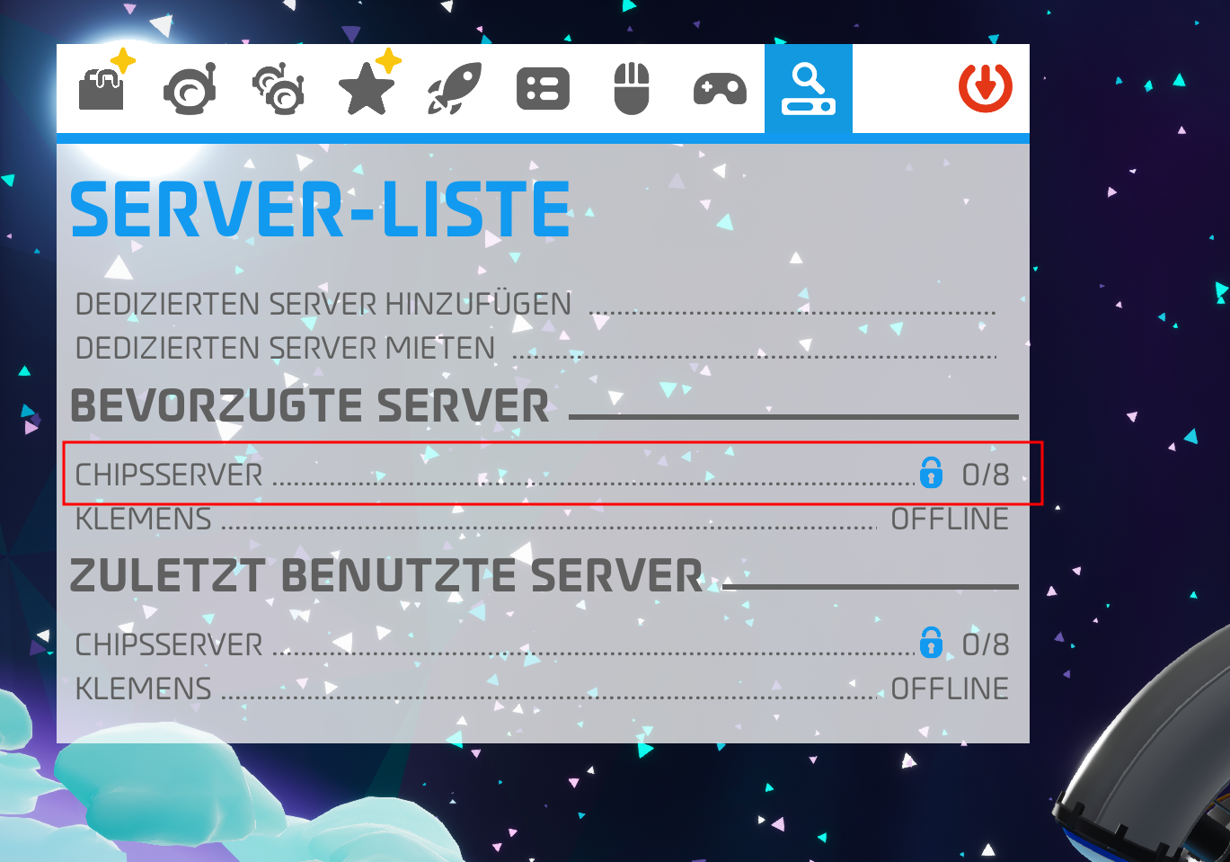

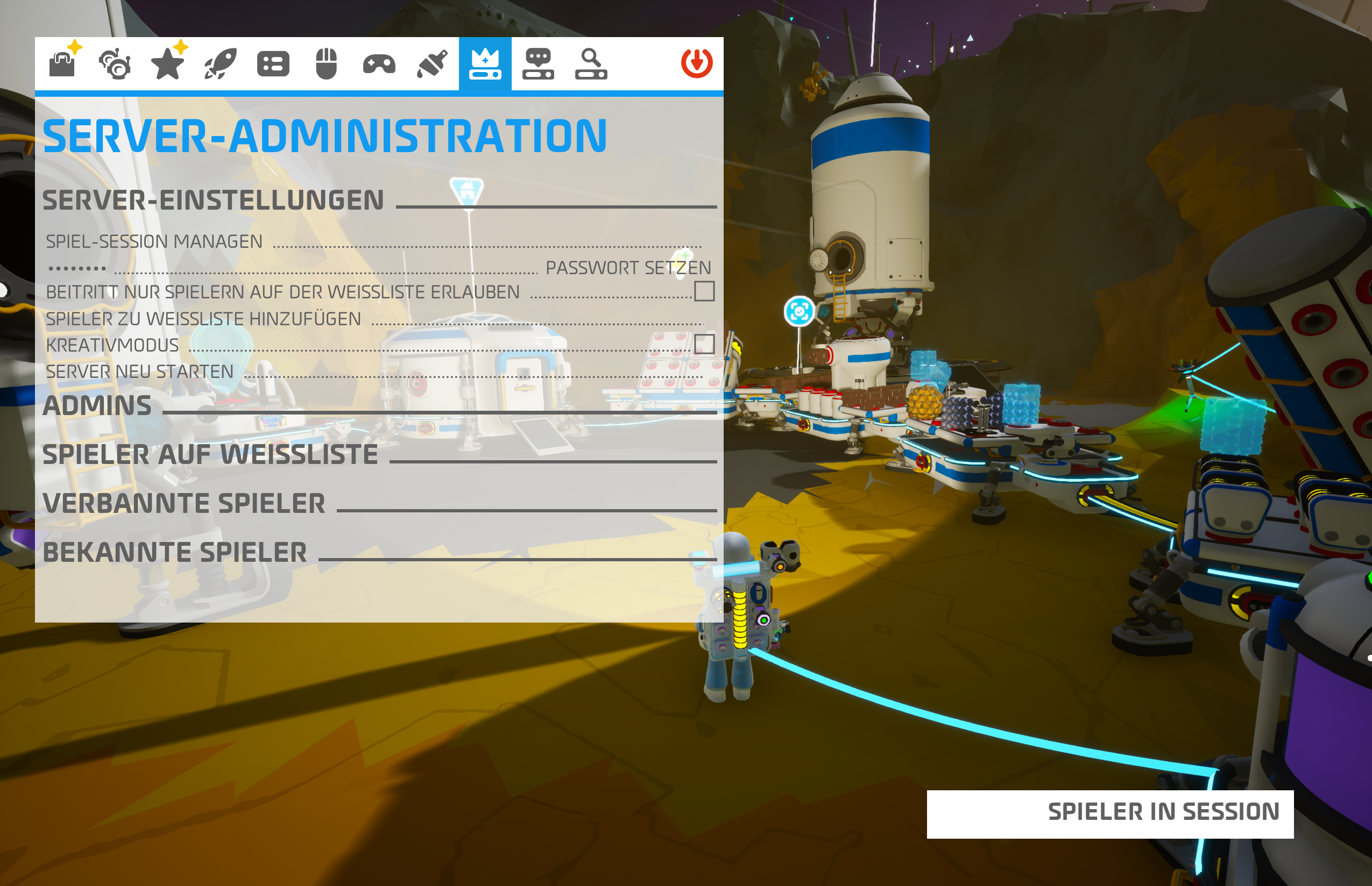

EDIT: The container works as intended:
And when connected:
Please note that you have to open up the ports to the Internet since LAN only doesn't work from my experience and therefore your HairPinNAT also has to work correctly.

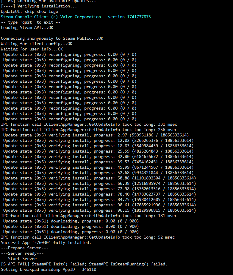

I am struggling to get the Ark Survival Evolved Server running.
With the docker up and running, I am unable to join the server.
I am on Epic, so I believe the only way to join a server on the local network is with the command: Open <IP:Port?Password>.
When I do that, it immediately gives me this error:Screenshot(5).thumb.png.a5163899030da4f47c13a2dc2d798e9f.png
i can ping my server from my PC, and If I run that command with a non-existing IP it takes a minute or so to see that error. So it at least can see the server.
Here is a screenshot of the log, and I'll attach it as a text file as well:Screenshot2025-03-14202406.thumb.png.9a2b2377ed9bb6019b823557d54cd8ec.png
I'm not sure if the "took too long" messages matter if at the end it still says it was successfully installed. I'm also not sure of the significance of the Steam_API_Init failed at the end.
I'm using a fresh install of Ark from Epic, no mods or anything.
IIRC you have to add -crossplay like this if you want to be able to join from an Epic account:
This is fine and the indication that your server is up and running.
Just this, it should ask you for the password, with what IP are you trying it? Your public IP or your local IP?
I would strongly recommend that you try it with your local IP so to speak: YOURSERVERIP:7777
Awesome! I appreciate the quick response.
I am just using the server's local IP to connect "192.168....".
I tried initially without the password with the same results, just added it in case that was the issue.
Adding -crossplay seems to have helped as I can now see it in the server browser, but couldn't before. I still get a connection timeout when I try to join though.
I don't see anything in the logs. Is there somewhere I can check why the connection is failing?
Did you change anything so far? The ports or something else? A screenshot from your template would be very helpful.

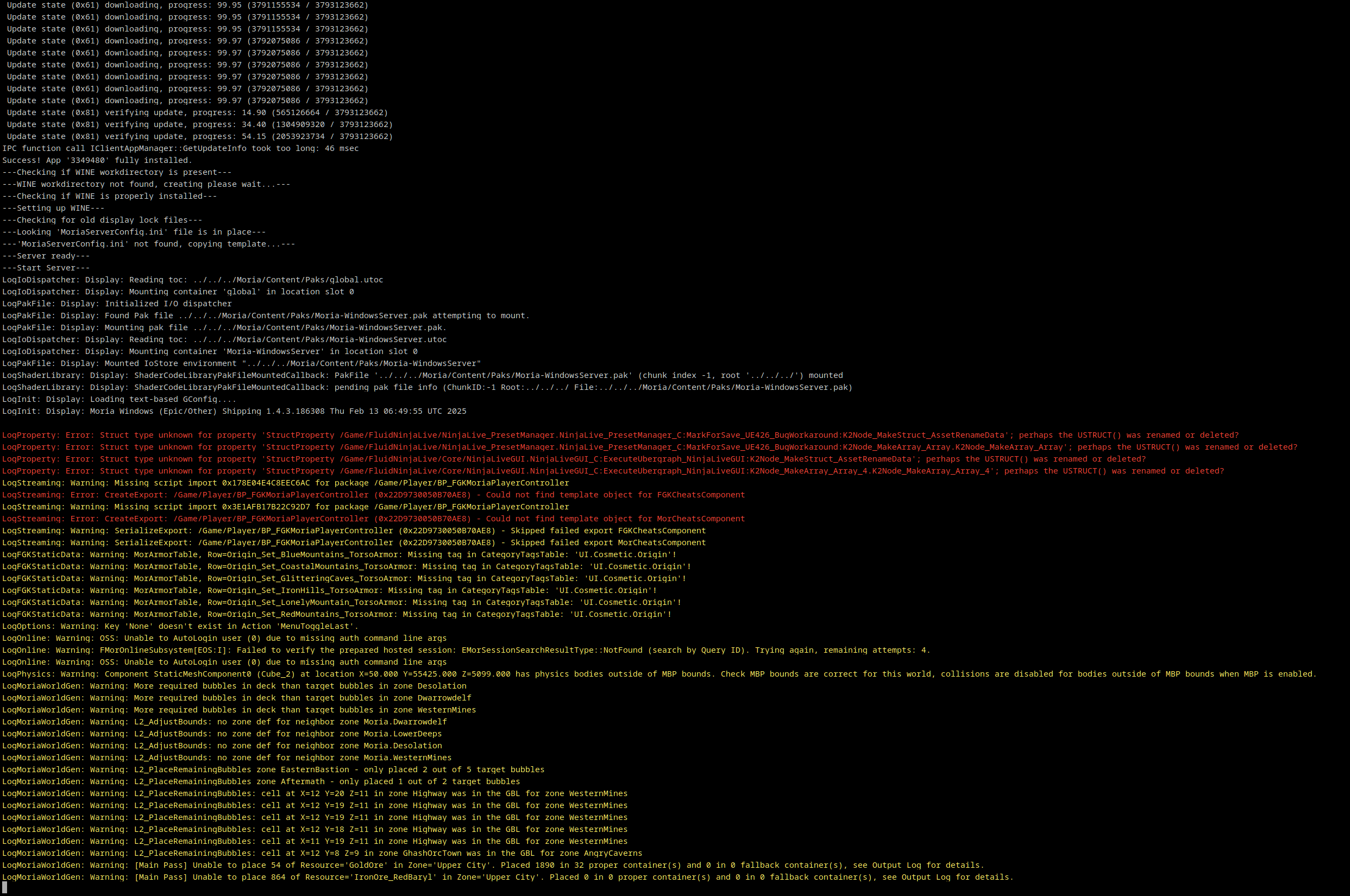

i have an issue withe return to moria docker.
the container stop with this alert in log:
X connection to :99 broken (explicit kill or server shutdown).
LogWindows: Error:
LogWindows: Error: Fatal error: [File:Unknown] [Line: 197]
LogWindows: Error: Ran out of memory allocating 32768 bytes with alignment 0
LogWindows: Error:
LogWindows: Error:
LogWindows: Error:
LogWindows: Error: Crash in runnable thread PoolThread 0
The server have 128Go of memory so it is possible to rise this limit to 64go?
Thank you for your help!
28 minutes ago, Ossito said:
first ,thanks ich777 for all your work!
Please share a bit more details, on what Unraid version are you?
For your Docker image, do you use directory mode or do you use an image, if you are using an image please try to do a scrub and see if you have any errors.
The container works just fine over here:
I don't understand what you mean exactly with that, the container will use whatever resources you give to it.
Please not that the container is running through WINE and that there might be unexpected behaviour or crashing due to that but it shouldn't be related to the error that you've posted above.
