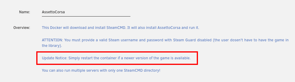

Hey can you make this assetto corsa server build because the dedicated one is a little outdated
https://assettoserver.org/
urs dosent create the files by server start for extra options in cfg
I don't understand, have you read the description from the template here:
However if you server won't update please refer to the third recommended post on top of this thread:
2 minutes ago, Onyxdigital said:
This container doesn't support AssettoServer.
