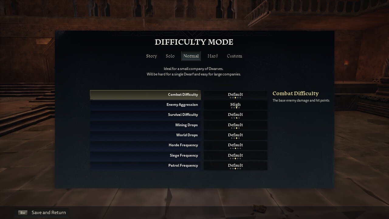

Hey everyone, I am hoping someone can point me in the right direction. On the LOTR: Return To Moria server, when changing the MoriaServerConfig.ini file the game does not seem to take the changes. At least it is not reflected in the in-game menu.
Also, does anyone know of any console commands to change the server settings in real time? I have noticed the MoriaServer.exe file and have been able to run it on my local windows machine but I do not believe it to be manipulating the server properly. It simply gives a host has left server message in the hosted server while not making any changes to the server itself. If yall have any insight it would be greatly appreciated.
Do you stop the container and then edit the files or do you simply edit the file and the restart?

Are you also sure that it is possible to. Change these settings after creating the world? This UnrealEngine based game has a pretty unique way of configuring the server.

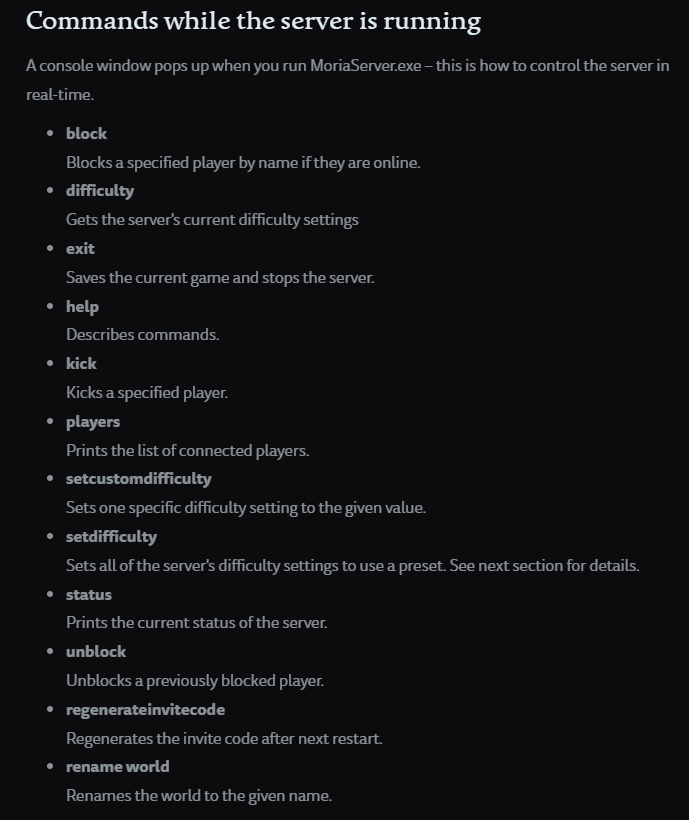

I don‘t think so.

I appreciate the response. Yes, I do stop the container prior to making the changes. I do see in the logs when it starts up that it recognizes the config file. This would leave me to believe that perhaps it is a capitalization error also. I will continue to try combinations that work until it either breaks me or works haha.
According to the return to moria server guide page this should be something that is doable while the server is running also. While the environment in which the server is running is of course not windows it would leave me to hope that the difficulty is editable in an existing world. But who knows at the end of the day.
I have been able to use this terminal by running the exe file on my windows machine while accessing it through the SMB share for the appdata folder and it does seem to manipulate it enough to shut it down, list the connected players, and get the current difficulty settings. However, when it is closed it seems that the server recognizes this console app as the new host and will remove everyone from the server when closed.

I have created a CS2 Docker and would like to access the Steamcmd console to enter commands like META? Thanks a lot
Accessing the game server console is only possible through RCON or the in game server console.
