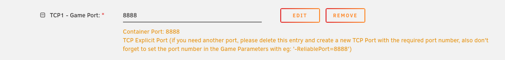

@ich777
Hallo,
I use your Satisfactory Docker for the Experimental Branch. Unfortunately, I can no longer log in, i.e. I can hear what is happening and can also shoot with the gun, for example. Unfortunately I only ever see the loading screen. With the patch 1.1 today CSS has somehow made the TCP port 8888 or higher necessary.
Here is the text from the patch notes.
Dedicated Server - Port Forwarding Updates
If you have Host a dedicated server, you should definitely give the next block a read as many new improvements have been added to allow for extra flexibility since the last update on Experimental
We have updated the Port Allocation Strategy in Reliable Messaging
New features:
Explicit Port Configuration
    A new -ReliablePort= command-line parameter allows explicit port selection.
    The value must be an integer between 0 and 65535.
    If specified, the server will attempt to bind to this port and fail to initialize if the port is unavailable.
Default and Configurable Port Ranges
The following settings in Engine.ini control port allocation:
[/Script/ReliableMessaging.ReliableMessagingTCPFactory]
PortRangeBegin=8888
PortRangeLength=512
ExternalPortRangeBegin=-1
    The server will attempt to bind within [PortRangeBegin, PortRangeBegin + PortRangeLength).
    By default, the server starts at port 8888 and tries up to 512 ports until it finds an available one.
Client Awareness & NAT Handling
    Clients must connect to the correct port, but port remapping (e.g., via NAT/firewall rules) can break this.
    To address this, the server now communicates the listening port to clients during the initial handshake.
    If external port remapping is used, the server must be aware of the external port via:
    The ExternalPortRangeBegin config setting (for remapped ranges).
    The -ExternalReliablePort= command-line parameter (for explicitly mapped ports).
Server Host Requirements (TL;DR)
    If hosting a single server, port 8888 TCP must be open by default.
    If hosting multiple servers, a range of ports starting from 8888 TCP (by default) must be open.
    The server will attempt up to 512 ports before failing (configurable).
    If port remapping (NAT/firewall) is used, the server must be configured accordingly; otherwise, clients won’t be able to connect.
    Logging is in place to help server maintainers verify the allocated ports.
Do you have any ideas what we can do?
Und jetzt auf Deutsch:
Hallo,
ich benutze Ihr Satisfactory Docker für den Experimental Branch. Leider kann ich mich nicht mehr einloggen, d.h. ich höre was passiert und kann z.B. auch mit der Waffe schießen. Leider sehe ich immer nur den Ladebildschirm. Mit dem heutigen Patch 1.1 hat CSS irgendwie den TCP-Port 8888 oder höher notwendig gemacht.
Hier ist der Text aus den Patch Notes.
Hast du noch eine idee?
Grüße
Tim
Edited by Timmey85

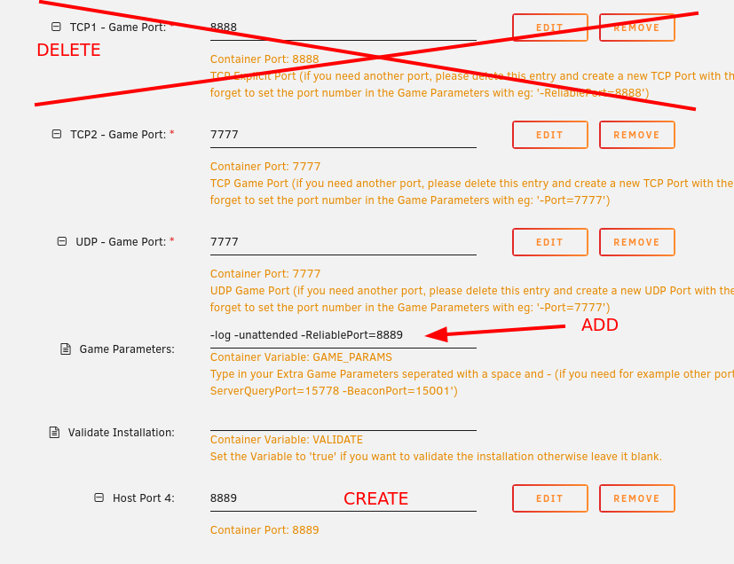

I have found the solution:
You have to release another port: TCP 8888
So the ports TCP/UDP 7777 and TCP 8888 are required

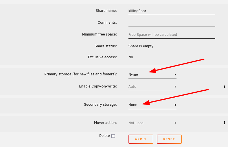

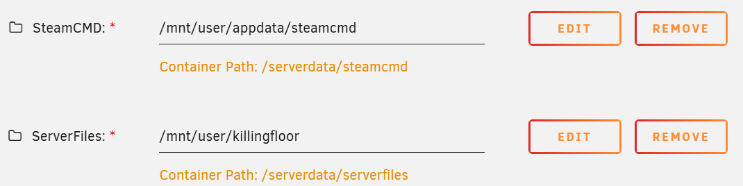

5 hours ago, huymetruoi said:
So there is no way to fix this :(. We have any plugins for backup?
I think you've quoted the wrong post correct?

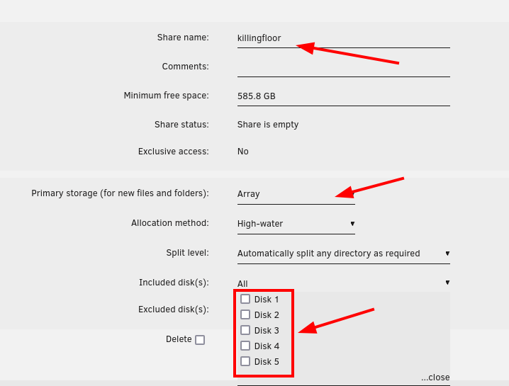

There is a fix, point the container to the correct disk, so to speak if all the game files are on disk1 use: /mnt/disk1/... if they are on disk3 then user /mnt/disk3/... if you have a cache pool with the name nvme then use /mnt/nvme/...
To go more in detail, you even can create a separate share and point the files to this share.
To do that
  1. Go to the share settings and click Add Share
  2. Enter your desired name for the share, select Array and at Included disks select the disk that you want to use <- this will ensure that the files only live on this disk
  3. Then click Add Share
  4. After that go to the Docker template and set the Game Files to /mnt/diskX/Killingfloor (where X stands for the Disk number that you've selected in Step 2
With the above your server won't delete anything.
However what I would recommend is that you are using a share that stays on the cache pool since with this the Array can go to sleep and save power, to do that click on Primary storage and select the pool that you want to have the game files on and at Secondary storage select None because with this the folder will stay on the Cache Pool, in the example below the path would be /mnt/nvme/killingfloor :
The preferred way in my book would be to change appdata so that it has only a Primary storage location on a pool and is not moved to the Array since with that you avoid the whole procedure above.
My main issue with that all is that I don't know which pools or if you even have a pool or Array at all and therefore explaining can get complicated quick.

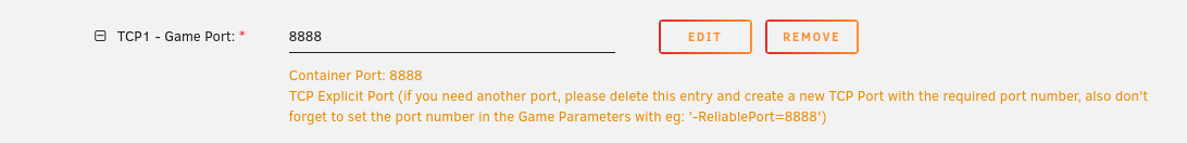

16 hours ago, ich777 said:
Thank you for the heads up, I just updated the container template for new installations and it will now include a second TCP port 8888, I also added a short description how users can change that port.
Unfortunately, I do not understand how to change the TCP port 8888. Which file do I have to edit and what does it look like? Can you post an example with port 8889?
The template has now this in it (only valid for new installations) :
You will basically need to delete that entry, create a new port mapping with TCP 8889 container port and host port set to the same and add -ReliablePort=8889 to the Game Parameters like this:
and of course don't forget to forward the port in your router/firewall.
Hope that helps.
14 hours ago, ich777 said:
Hope that helps.
Yes, Thanks.
Vielen lieben Dank ❤️‍🔥

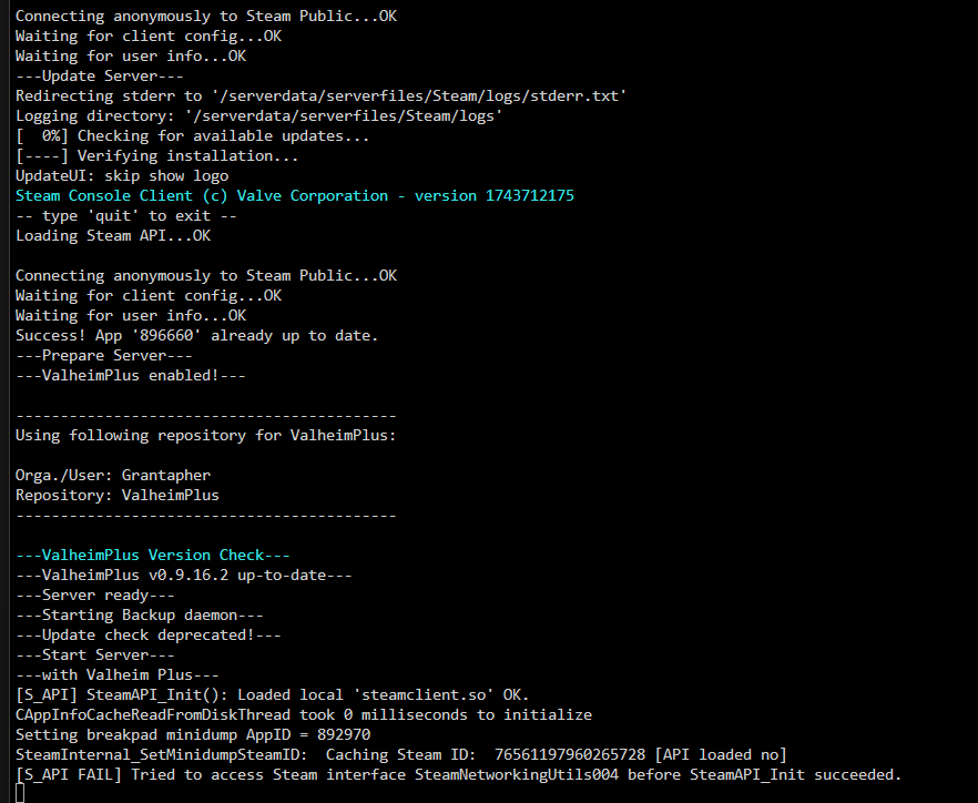

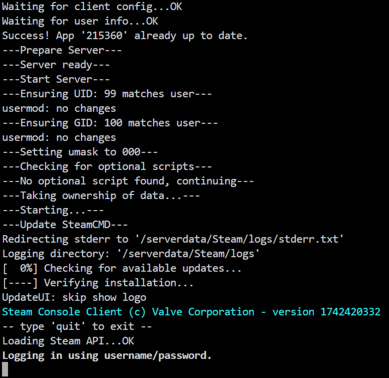

My Valheim server has suddenly stopped working.
I had re-stared the docker and also lost power shortly after that.
The server no longer shows as available in the server browser.
The only thing that should have changed was some tweaks I made to the Valheim Plus config before restarting the server.
When I first checked the logs, it had stopped at :
---Start Server---
Now each time I restart it, it makes it past that but still can't access it.
Here is the most recent log:
I'm not sure what [S_API FAIL] means, if it's good or bad, or if I should expect to see more after it.
---Start Server---
I tried connecting with my local IP address and it worked, so this seems to be a network/routing issue. Commenting here in case it may help someone else. I would still like to understand what [S_API FAIL] means.
Everything seems fine and you should be able to connect, have you tried to connect with your SERVERIP:PORT too?
This message was always there and is just normal, it just says that the Steam API was not ready but if you look a few lines above it’s loaded because it retries and finally intializes.

  -p '7777:7777/udp'
  -p '27015:27015/udp'
  -p '7777:7777/tcp'
  -p '27015:27015/tcp'
  -v '/mnt/user/appdata/steamcmd':'/serverdata/steamcmd':'rw'
  -v '/mnt/user/appdata/humanitz':'/serverdata/serverfiles':'rw' 'ich777/steamcmd'
27a60c484e336ba940b157daa4b533de6ace6b0f422bd049ad9dc77d4eb06c98
The command finished successfully!
The docker crashes after downloading the server files and calling start-server.sh
