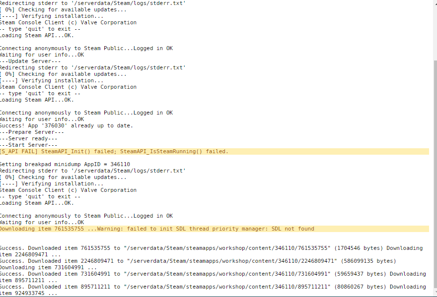

sadly i'm not getting this to work it always stops at the last mod in the list and stops continuing
i guess hes not finding the files where hes expecting it. but i tried many different mount and links to folders but cant geht it to work.
any ideas ?
sidenote: found out if you put -automanagedmods in The extra parameter and you have your mods in ActiveMods= in GUS.ini you wont need to put the [ModInstaller] in game.ini. so you only need to put your modid into one place. otherwise you have to edit both files or gameparameters
@ich777 have you had the opportunity to read though my proposed additions to the are-se container?

i did not managed it to work
It always stops at the last mod to download
If i add another or remove one its always the last mod where it stops to download.
i did the symlinc and checked the mod files he downloaded are at both places
/serverdata/Steam/steamapps/workshop
and
/serverdata/serverfiles/Engine/Binaries/ThirdParty/SteamCMD/Linux/steamapps/workshop
 so what am i missing ? i think he completely downloaded the mods but the step where he has to copy them to the conten/mod folder are not happening ?
it stays at this place forever (see Picture)
Edited by Cornflake
@Cornflake that looks like a successful launch to me. Take a look at your tower/docker page and look at the memory usage for the container, it should be spooling up. It seems to me that shootergameserver has the last message held in a queue. If you open the console in the container and look in ShooterGame/Content/Mods/ you should see all of the .mod meta files there and available.
