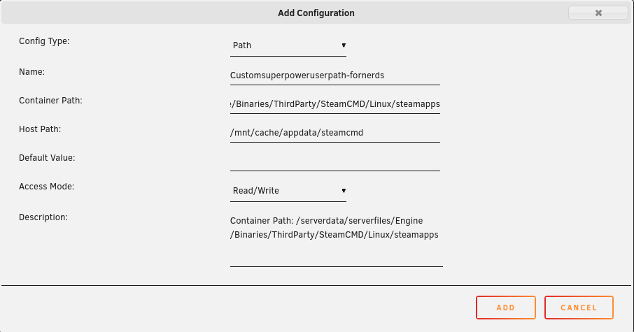

@Cyd & @Cornflake
I think this should do the trick (but I could be also wrong and could break something inside the container, try it on a fresh install):
Container Path: /serverdata/serverfiles/Engine/Binaries/ThirdParty/SteamCMD/Linux/steamapps
Host Path: /mnt/cache/appdata/steamcmd (depends on where your SteamCMD path is in the template, I think it's the first entry)
@ich777 and @Cornflake
I have it figured out.
This enables the game engine to find and use the already available SteamCMD tools.
However SteamCMD is smarter than the game engine, it stores downloaded workshop content to its user home directory under "/serverdata/Steam/steamapps/workshop/content/346110/2229978458/" yet the server expects to find it in the directory from which it called the steamCMD tools "/serverdata/serverfiles/Engine/Binaries/ThirdParty/SteamCMD/Linux/steamapps/workshop/content/346110/2229978458" so the soft link is still required because the Steam users home working directory is in the container not on the host.
ln -s /serverdata/Steam/steamapps /serverdata/serverfiles/Engine/Binaries/ThirdParty/SteamCMD/Linux/steamapps
This could simply be included in the startup script block as the /serverdata/serverfiles/Engine/Binaries/ThirdParty/SteamCMD/Linux directory will exist because of the Path mapping.
adding "?GameModIds=2229978458,..." to the Game Parameters
and "-automanagedmods" to the Extra Game Parameters
would be easy enough to parse in the start-server.sh with the other variables...
