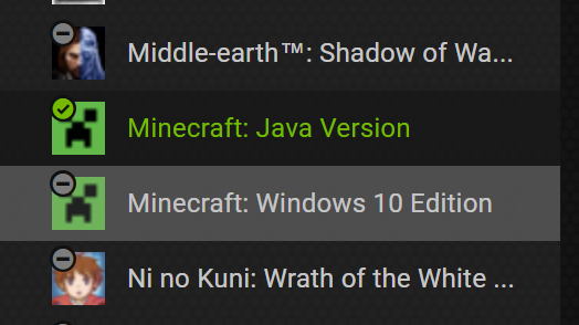

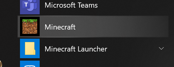

Hi @ich777,
Here is a quick update. I figured it out!!!!
My problem was I was thinking old school Minecraft launcher. It's been a while since I played regularly and this whole bedrock vs basic thing is new to me.
I had assumed there was only 1 minecraft launcher.
However, today I saw this in my GeForce Experience screen:
I had been launching Minecraft from the Windows Start menu where I only have 1 listing and it does not say whether it is Java or Windows 10:
So when I saw these 2 listings in GeForce I launched them. The Windows 10 link opens the launcher that does not see the Minecraft Basic Docker.
But the Java link opens a different launcher that is specifically for Java servers.
I had no idea the launchers could be different. *eyeroll*
Anyway, it's fixed. I can now play in my old world from your server and it's a beautiful thing!!!!
