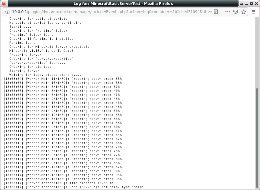

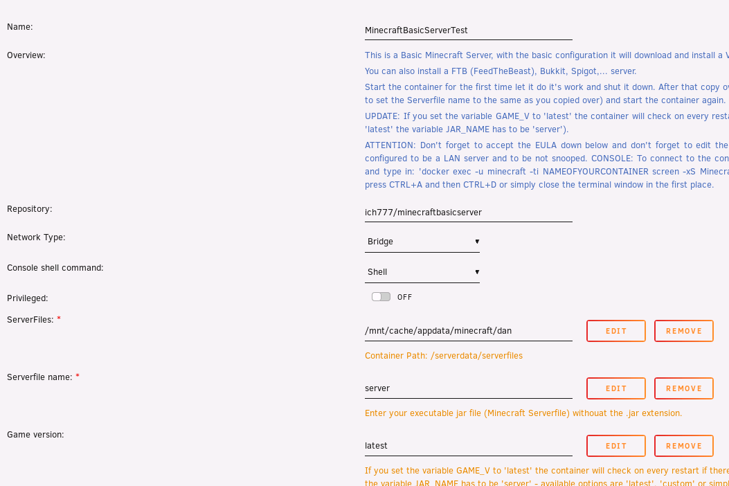

If you change the default directory for ServerFiles from the default "/mnt/cache/appdata/minecraft" to say something like "/mnt/cache/appdata/minecraft/dan" the Minecraft docker will fail to launch. I spent 4 hours trying to figure out why if I moved it to a sub directory the server started having problems. Made a new one with a subdirectory within the minecraft one with a new docker setup just for it to not even launch. I couldn't tell you why though.
MinecraftBasicServer or MincraftBedrockServer?
If you are talking about the MinecraftBasicServer it works just fine:
As you can see I renamed it like you posted it above.
Please share the log from your container and also screenshots from your template, otherwise I can't help.
