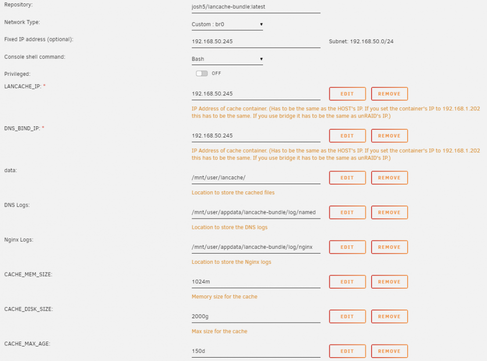

Here's my working 1 PC setup (not ideal)
Docker config in Unraid

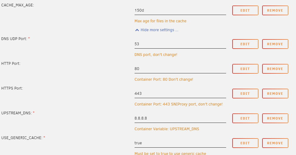

Docker config continued

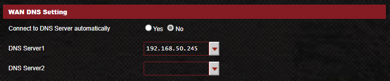

Router DNS Config (I know this isn't pointing to my lancache docker image at 192.168.50.245 - this is the less than ideal non-router setup)

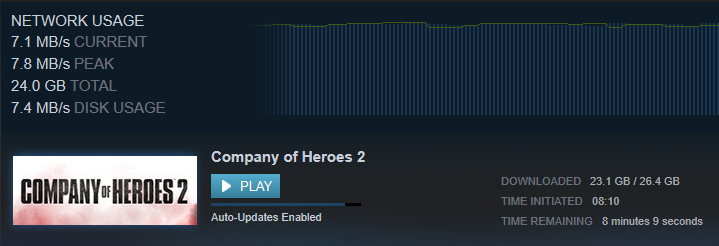

Initial download speeds from steam

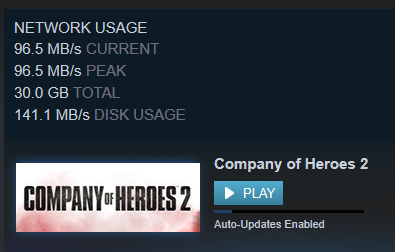

Re-download speeds that prove the cache is functioning correctly
Now if I change the router config to point to the lancache docker image as the DNS it doesn't work and nothing on my netwrk can resolve DNS addresses...
Router pointing to lancache docker image
