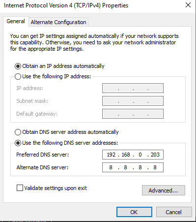

Not sure if the main developer still proving any help here but I figured I'd ask here anyways.  I was able to get this working when downloading and redownloading games from Steam.  I had noticed that under more settings it mentions Nintendo and Sony (screenshot below).  Now it says that I would have to change to option to true in order to disable caching for those.  So does that mean it is enabled by default?  I tried testing on my PS Vita and Nintendo Switch setting those up exactly like I did my computer for Steam but it appears that nothing is being cached when downloading from my PS Vita or Nintendo Switch.  Is there anything additional I have to do to get this to work for gaming consoles like those or does this really only work for PC type games?  Thank you.
Clutz450 you are correct, it should be working by default. I dont have either of those systems to test, but I have set my router to point and hand out my lan cache IP. This way no matter what device gets onto my network, it will goto my lan cache ip first.
Before doing this, I had to set everything in my network to point at my lan cache ip or it would not do anything.
Hope that helps.
der8ertl, before mine stopped working, I didnt have to do anything but set the first DNS request to my lan cache IP.
I didnt check after setting my router to have my lan cache IP as the primary DNS IP.
Image shows what I had before updating my network months ago, and I can confirm that worked as I forced my pc to updated with windows, then updated the other 4 windows 10 pcs in my house.
hope that helps

Thank you for the reply.  The way I was doing it was I was manually setting the DNS to my lancache IP address on each device (PC, Switch, and Vita).  It worked great on my PC for Steam games.  It didn't seem to do anything for the Switch or Vita.  How did you set it up through your router?  Maybe I can try that next.  I have an ASUS RT-AX58U if that helps any.  Thank you.
Clutz450 a quick search for "changing dns on ASUS RT-AX58U" will provide you where you can change the DNS addresses that your router looks for. You will need to update the details in the lan cache settings though as well.

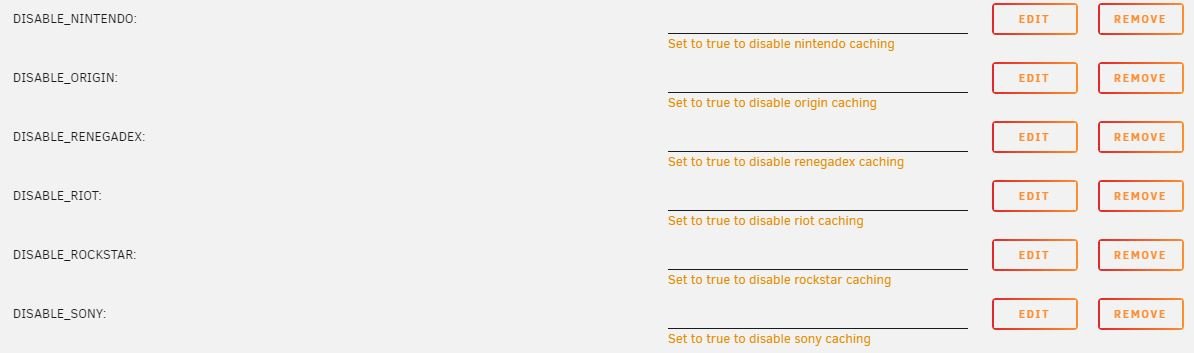

Is there a way to delete cached data other then wiping the whole cache? I didn't notice the Twitch caching was a feature enabled by default. From what I understand this will cache any live streams you have watched on Twitch. I would like to delete all cached Twitch data that is taking up space.
Thanks,
Edited by TrueImpulse
Thanks,
I believe it caches only twitch games, not the live streams, I watch a lot of twitch and I have never seen twitch in my access log, are you saying twitch is in your access log when you watch twitch streams?
