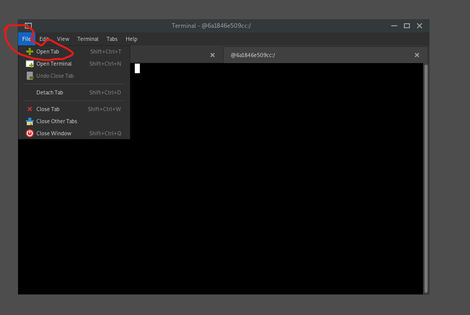

Could someone please provide a little more detail on running mulitple preclears with this docker?  I read this:
Q5. Can i preclear multiple disks at the same time?.
A5. Yes this is possible, you simply create an additional 'tab' in the 'Xfce terminal' and then run the script again against the additional named drive.
But I'm unfamiliar with how to create an additional tab in the XFCE terminal.  Is another docker/plugin required?  Thanks.
Edited by betaman
Try this:
2 minutes ago, Frank1940 said:
Try this:
Doh! I'm helping a friend remotely and didn't realize there was a menu in the VNC window since i wasn't doing it myself.
Thanks for your guide as well. Maybe worth adding a section on preclearing multiple drives would be beneficial?  Either way, thanks for the response.

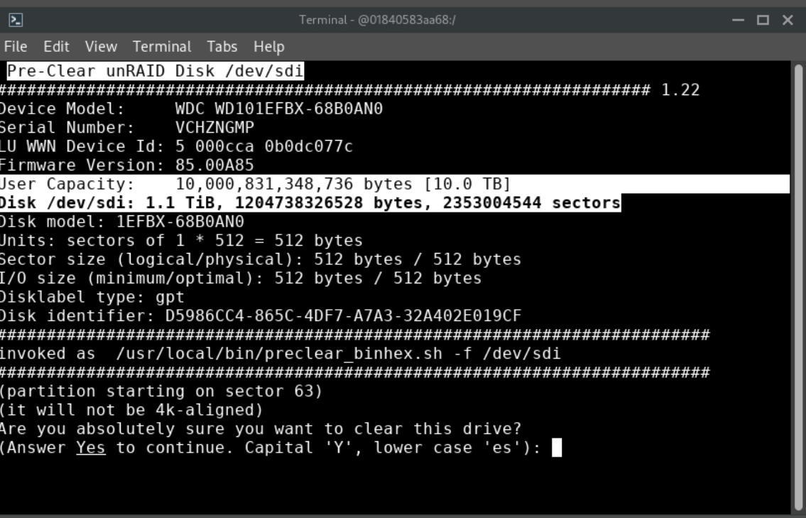

image.thumb.png.27d026795c480d46084ab54c5e7f3bd9.pngI am trying to preclear a 10tb drive to replace an old drive.
I have done this before about a year ago, and everything worked (last time wd red 10tb, and now wd red 10tb)
However, this time, I am getting an issue with preclear binhex and the plugin, and unassigned devices, where it only detects the drive as 1.1tb.
Doing a smart disk check on the disk in unraid reveals it as 10tb.
Starting the binhex preclear also shows user capacity as 10tb, but disk as only 1tb.
Could someone please advise?

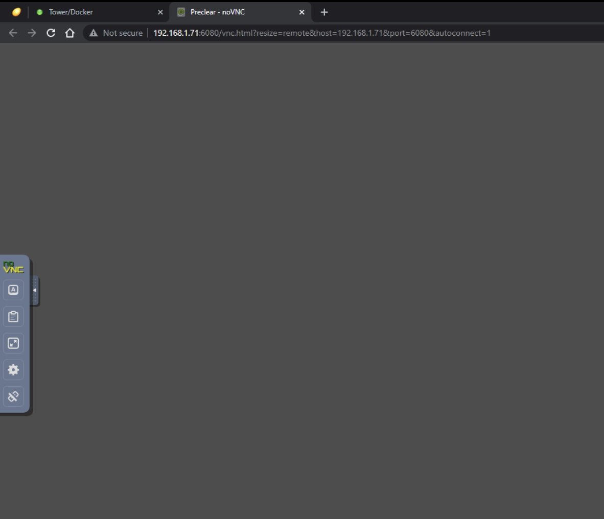

So I just went to check on my preclear and the VNC remote screen looks like attached. How do I know if it’s still running? It’s as if there’s a terminal window oversized on my screen but I can’t scroll to see any command line?
Edit: So I can see from main UnRAID screen the disk is still being written to as it was in the zeroing phase. I just can’t get the terminal window to show up?
Edit 2: So I managed to get the terminal window back but no idea what I did exactly. I was trying to set different scaling options to see if that would work but no change.  I pinched the screen (working on an iPad) and it was back. Prior I was using AnyDesk on my Windows vm to check progress. Perhaps the combination of pinching between the two caused it??
Edited by betaman
