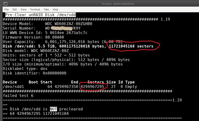

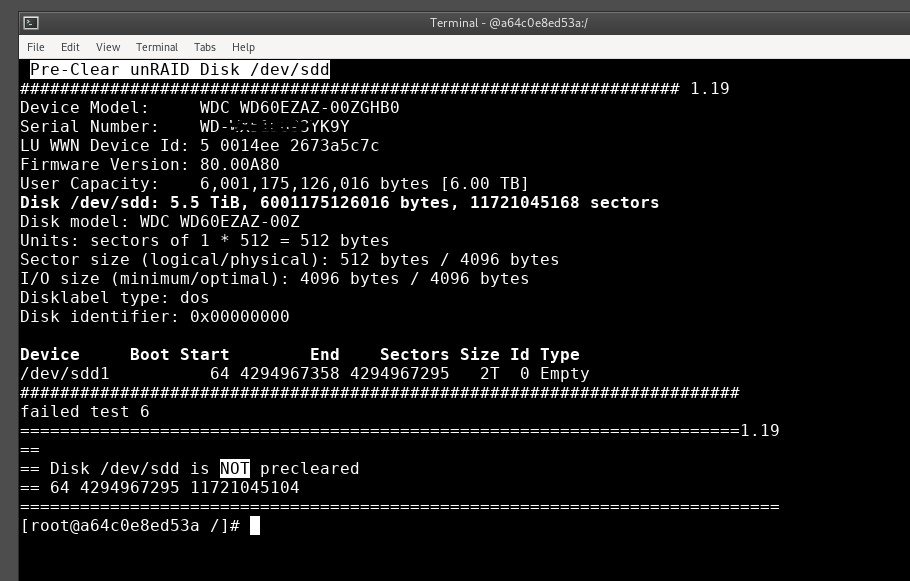

Just finished preclearing a 6TB WD Blue Drive.  I checked to see if the disk had the proper preclear signature. This is the output of the check:
Edited by Frank1940
Looks to me like it has something to do with the old 2.2TB limit size limit...
And what is "test 6"?
Which command you passed to preclear_binhex.sh?
preclear_binhex.sh  -c 1 -M 3 /dev/sdd
and this is the command I used to check it:
preclear_binhex.sh -t /dev/sdd
(Both of these were copied directly from the BASH command stack on the noVNC terminal screen.)
The Disk is still in the server and I could rerun it with the -f option if that would be of some value.
EDIT:  However, I do recall that I did check it after a run of two cycles and the test also failed at that point.  I didn't report it than because it was some time after that the finish of the preclear cycle that I did the check.  (I was trying to put hours on a new hard disk as it will be a cold standby replacement.)

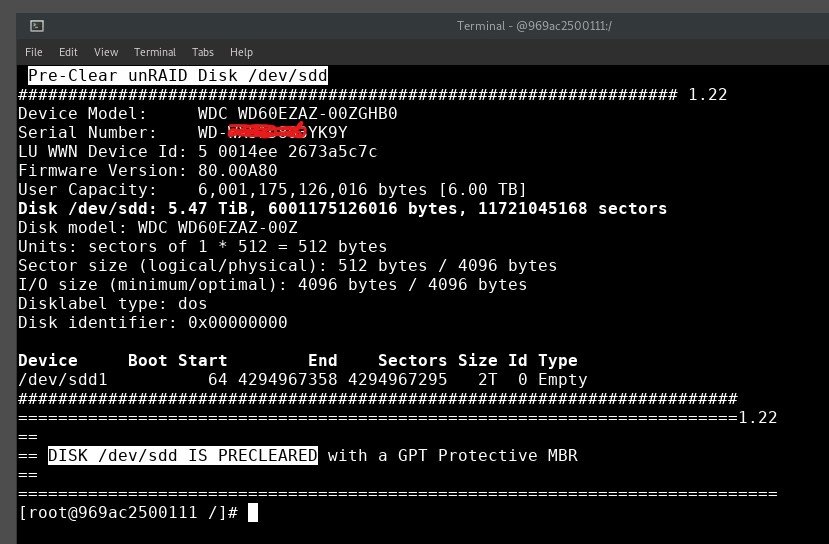

Update Docker.  Now getting this:
It looks like it is working now.  The only question is the size of sdd1 and its ending sector.  It is not quite what I would be expecting to see...
That's correct. It creates a GPT Protective partition so Unraid can recognize it. We must remember that when Unraid was first launched, we only had MBR partitioning scheme and disks were far from archiving more than a few gigabytes. This was the way that was found to implement a layer of compatibility in the transition to > 2.2TiB hard disks.
