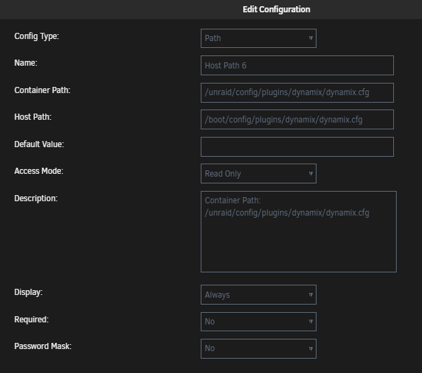

I am having the same issue as reported above. Someone should really mark this plugin as broken! Has anyone figured out how to reverse this install issue?
What I see on my webui (even in safe mode!)
Warning: parse_ini_file(/boot/config/plugins/dynamix/dynamix.cfg): failed to open stream: Success in /usr/local/emhttp/plugins/dynamix/include/Wrappers.php on line 22
Warning: array_replace_recursive(): Expected parameter 2 to be an array, bool given in /usr/local/emhttp/plugins/dynamix/include/Wrappers.php on line 22
Warning: extract() expects parameter 1 to be array, null given in /usr/local/emhttp/plugins/dynamix/template.php on line 21

this docker image isnt broken per say, its related to the fact there is no dynamix configuration file due to no changes to web ui settings, link to the issue as posted by another user and resolution:-
https://forums.unraid.net/topic/91163-solved-webui-is-messed-up/?do=findComment&comment=853465
i will check in the change to the template now, which should prevent this from happening in the future (volume maps folder not file) - see my last comment.
Thank you!!!! This worked!

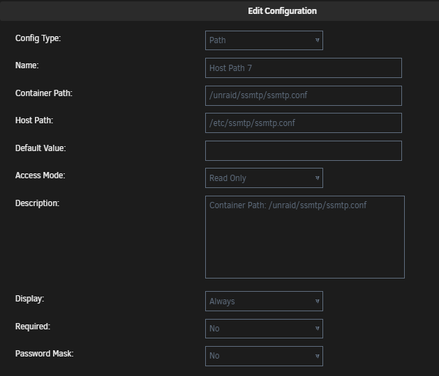

On 10/2/2019 at 10:23 AM, binhex said:
OK email notification looks good, so the image is currently building, once its ready please pull down. if you want to use email notification then you will need to add in the following additional volume mounts (new users AFTER 2nd Oct 2019 will NOT have to do this), please copy the host and container paths EXACTLY as they are in the screenshots below:-
and also another additional volume mount:-
then run the preclear script with the -M option to get notification of progress via email.
NOTE as long as you have setup email notification on unraid then you will NOT need to specify any email configuration or recipient email address(es).

I seldom have new disks to preclear anymore so it's taken me a while to test the email function you added. Tried to modify my install of the docker as you posted in the quote but it appears the paths have changed (Host Path 6 is currently /unraid/config/plugins/dynamix:/boot/config/plugins/dynamix). I got around this by just removing the docker and appdata and doing a fresh install. Just thought you might want to edit this post.
I am getting the following when trying to start the Docker:
