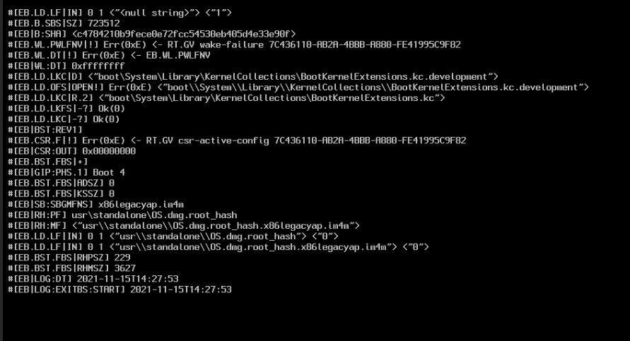

How did you get this to work? Every time I move the EFI folders, and delete the other vDisks, I get the attached error
Did you read my above reply?
It contains the "why" and "how you fix it".
sorry just saw it now. Will give it a shot

I tried this last night but got the same issue after trying to create the SMBIOS with opencore configurator. So you're saying I should just skip that part of the guide? Where do I stop following the main guide? After moving the EFI files?
Well I managed to get Monterey running, however I did not create the SMBIOS with opencore configurator, just moved the EFI files to the main disk. It boots, but is very slow and I can't connect any Apple services still. Is there a way to update the SMBIOS with the right info without running OC config? I'm scared because that's always when it breaks lol
On 10/28/2021 at 2:04 AM, ghost82 said:
Hi, as promised I tested the OpenCore.img and it has no issue, I'm able to boot and install mac os, I tried monterey, but the same applies for big sur and catalina.
Now..the easiest way for you, since the original img included in macinabox is still able to install mac os (<-- not true, see below), could be:
1. clean the container and the data, spaceinvadersone tell how to do it in his video, this is very important, maybe double check also with terminal commands that everything is deleted
2. install again macinabox and install mac os as you did for the first time (<-- not possible, product id is no longer valid, see below)
3. do not change smbios data, do nothing, just shutdown mac os
4. From unraid, or from another box, download the new opencore.img from
https://github.com/SpaceinvaderOne/Macinabox/raw/2a2400c44af497a00f2610523cb0c0844d2aae27/bootloader/OpenCore.img.zip
and extract it from its zip archive
5. From unraid, go to /isos/ (opencore.img should be in the isos share)
Delete BigSur-opencore.img (should be named like this, or similar) and paste the new OpenCore.img you just downloaded and extracted, rename it to the same name it was the deleted one
6. Boot mac os
7. Download opencore configurator 2.51.0.0 to mount partition and change smbios
https://mackie100projects.altervista.org/download/opencore-configurator-2-51-0-0/
8. Side note: you can not copy/replace the efi files from the opencore.img to the mac os disk; by this way if you mess something it will be easier to just replace the opencore img instead of mounting the efi partition inside the vdisk.img (mac os disk)
This finally got me up and running. I was able to get Moterey booted with the correct SMBIOS and remove the other two vdisks. Now to try and get Apple services working...

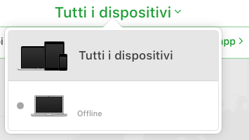

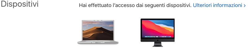

3a. login to appleid, under "devices", delete additional devices (following picture as example):
3b. login to icloud, go to find my device, on the top click on "all devices" and verify that you don't have additional devices:
Once you have all these things verified, do not change anymore your smbios data and try to login; if it fails, write the specific error message.

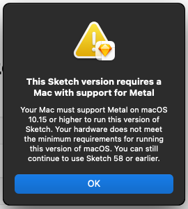

Just tried to run Sketch inside of macOS Monterey using the VNC graphics. I get an error about the Metal hardware API.
Is there a way to get Metal support through VNC?
no.
