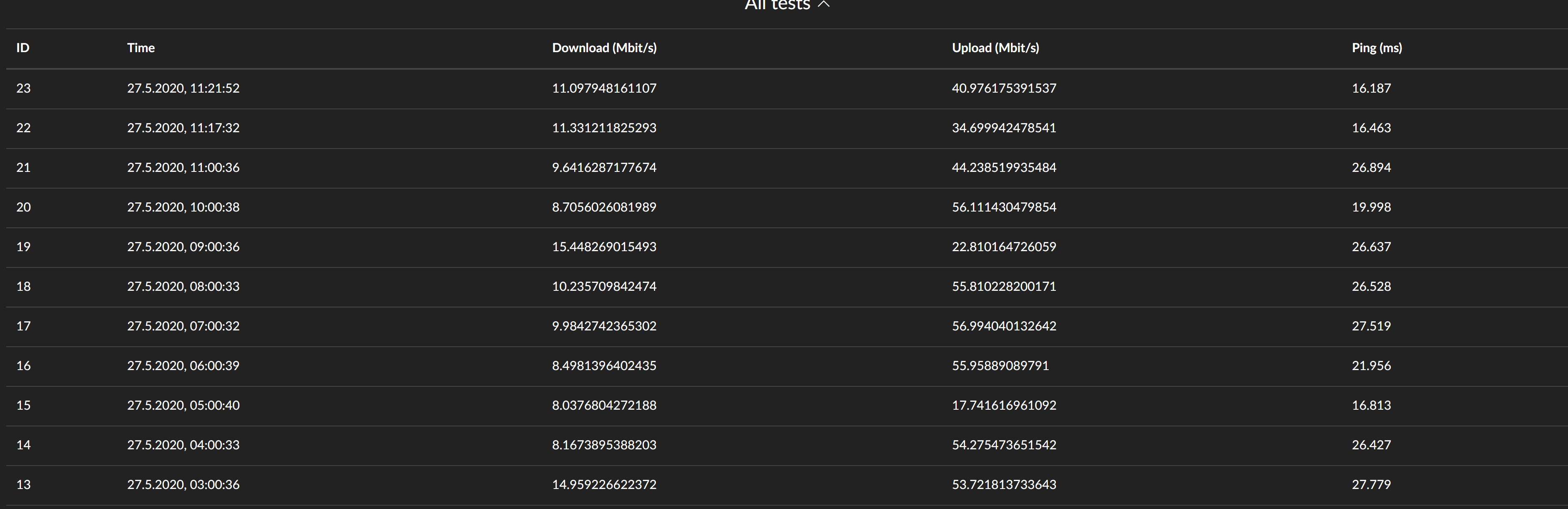

IMHO there is something wrong when calculating speeds and showing them in the frontend:
Here an example from my home:
In this case, it seems like decimal point is somehow shifted.
Upload is correct, but download is far away from real values. I have a 1gig download stream and when testing directly via speedtest.net, i always get around my 1100 Mbit/s. This is very similar to the values in the frontend, but the comma is in the wrong place :D
// And as a suggestion: You should add a hint on WHAT exactly you need for a "speedtest.net server" metric, IP adress? Hostname? or an server ID from an XML file hosted here: https://c.speedtest.net/speedtest-servers-static.php .
For all others: It's the XML file and the 'id' attribute in it.
Hey, could be the speedtest-cli program changes units when you get to high speed connections. I've only got 30mbit down so can't test it, could you install speedtest-cli by doing:
pip3 install speedtest-cli
then post the output of:
speedtest-cli --json
so I can see what's going on with the results. You may potentially want to specify a server ID when running that, as it will pick the closest one to you and may reveal your location.
It's the server ID from the XML file. So you could put: "7028,11445,17418" as the value in the settings card, and each time it runs it will pick one of those 3 randomly.

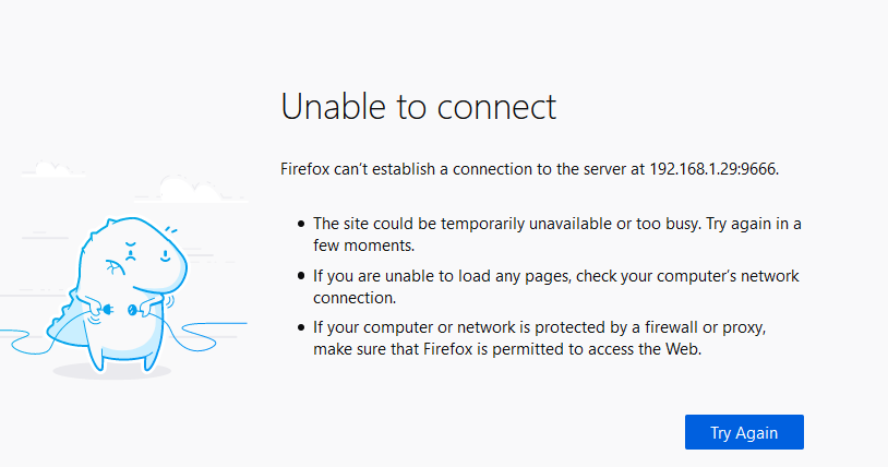

I just install Deemix yesterday and was able to use it.  Had to change permissions, but that was it.  This am I tried to login and its not working.  I tried to update the container and I'm still not able to use the web UI.  Getting the message "WARNING: This is a development server. Do not use it in a production deployment. Use a production WSGI server instead." in the logs
Edited by PaDadof2

The deemix docker was removed from Docker Hub. Change the repository to registry.gitlab.com/bockiii/deemix-docker and it should work again.
Tried this, but sadly the same results
EDIT:  Edited container port to 9667 and now it works.  Thank you
