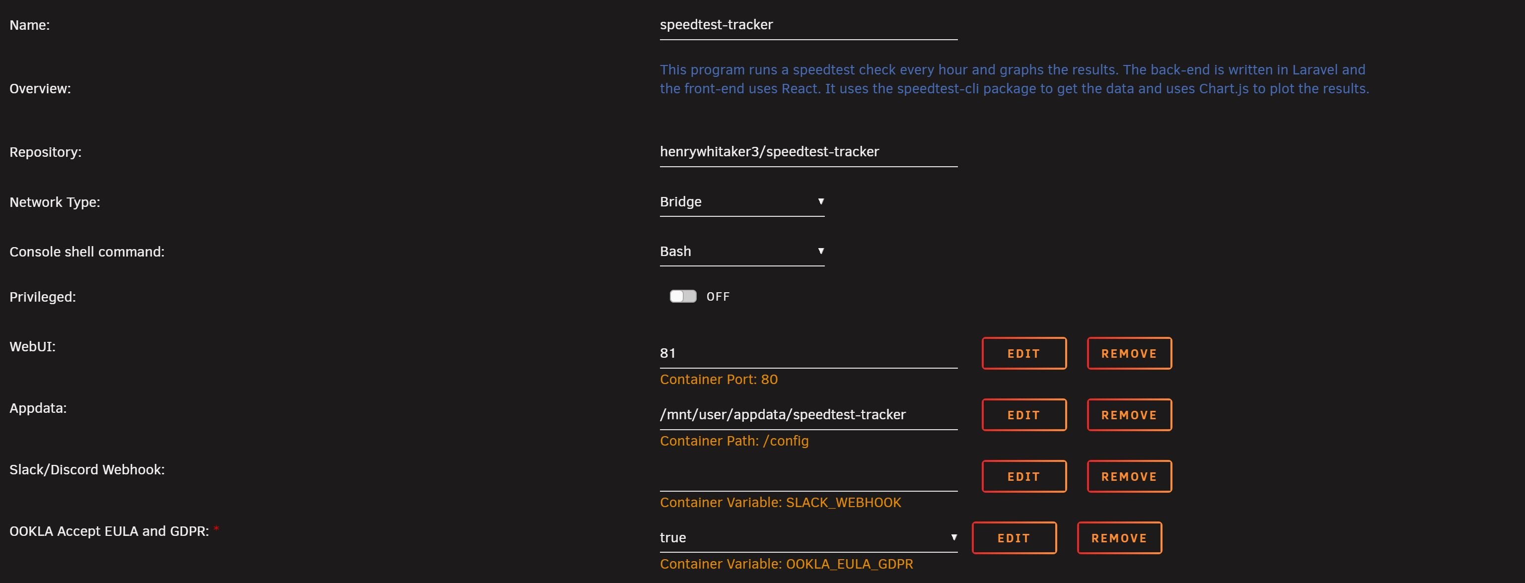

Have speedrest-tracker installed and running but all the tests come back with an ( x ) have checked the log and this keeps comming up any help ?

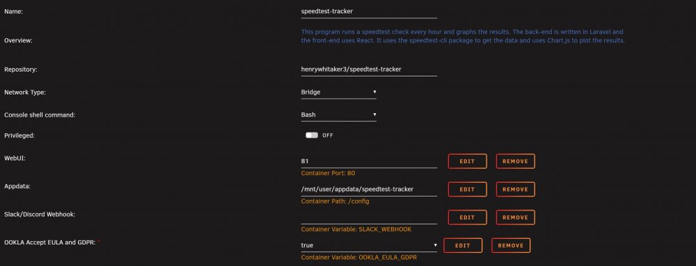

Have you set the EULA env var?
OOKLA_EULA_GDPR=true
indeed it is set to true
Hmm, weird. Can you post the full output of

Weird, try doing
docker exec -it speedtest-tracker rm /config/www/app/Bin/speedtest
then restart the container
There's been a bug with the drop downs. May need to toggle it to false and back to true.
Nah container shouldn't start if the EULA var isn't set to true

I have run the command and restart the container, but still getting the same result

Telegram chat id and bot token unset
Base path is unset
Clearing old jobs from queue
[cont-init.d] 50-speedtest: exited 0.
[cont-init.d] 99-custom-files: executing...
[custom-init] no custom files found exiting...
[cont-init.d] 99-custom-files: exited 0.
[cont-init.d] done.
[services.d] done.
nginx: [alert] detected a LuaJIT version which is not OpenResty's; many optimizations will be disabled and performance will be compromised (see https://github.com/openresty/luajit2 for OpenResty's LuaJIT or, even better, consider using the OpenResty releases from https://openresty.org/en/download.html)
[cont-init.d] done.
[services.d] done.
You may only use this Speedtest software and information generated
from it for personal, non-commercial use, through a command line
interface on a personal computer. Your use of this software is subject
to the End User License Agreement, Terms of Use and Privacy Policy at
these URLs:
https://www.speedtest.net/about/eula
https://www.speedtest.net/about/terms
https://www.speedtest.net/about/privacy
To accept the message please run speedtest interactively or use the following:
speedtest --accept-license
these URLs:
