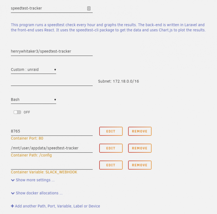

started getting this yesterday with speedtest-tracker, tried removing/wiping the container and reinstalling:

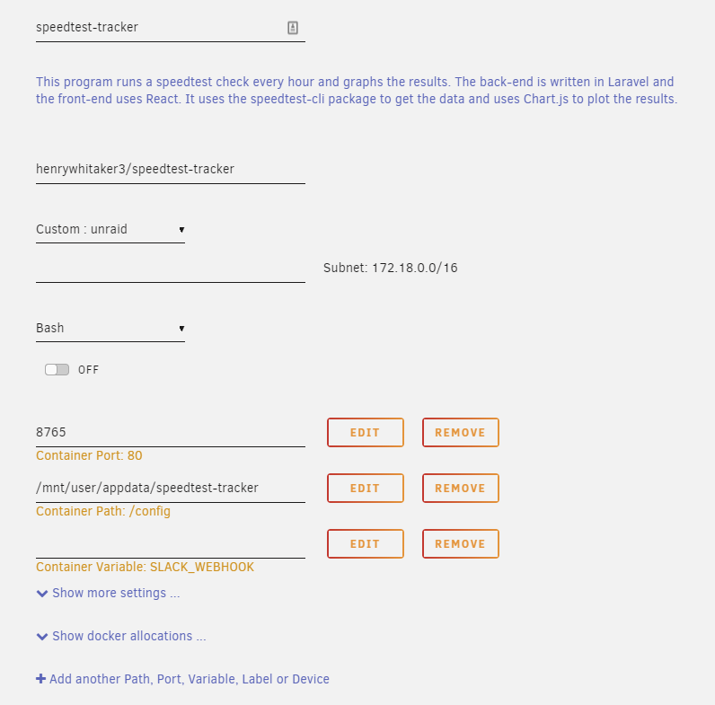

Can you do post a screenshot of the settings for the container?
1 hour ago, HynesJeff said:
wonder if it is your custom network doing some funky stuff, does it work with the default bridge?
turns out the port was in use somewhere else.. not sure where though.
