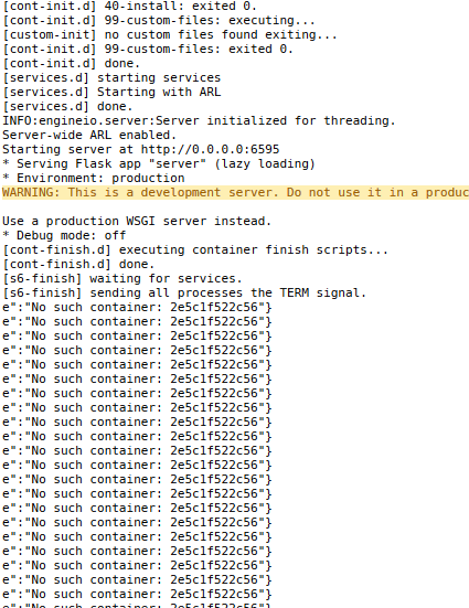

Hey guys. The latest Deemix docker seems to be broken. I noticed the port in the config still says 9666 but the documentation mentions 6595. Regardless of what I put in the configuration, I am unable to connect. Removing and adding the container doesn't seem to fix it.
In the template add a new port 6595. You will also need to change the port for the webui (visible when you enable advanced).
If it still does not work try a force update. remember it will take some time to install the software again (you can check to log to see the progress)/.
I finally got the app to update and remove 'not available' tag.  I've tried several different ports including 6595/WebUI with no luck.    Whenever I attempt to hit the UI it times out.
Regardless of UI port I get this in my log.
Did you change it here? :
I did but apparently I fat-fingered the address. Everything is working properly, thank you.

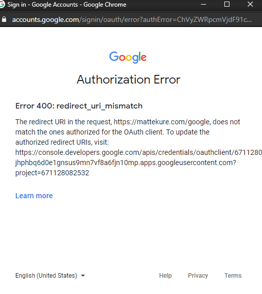

I have the draw.io docker running.  And when I attempt to open an image from google drive, I am asked to authorize the app.  When I do, I get the following error.

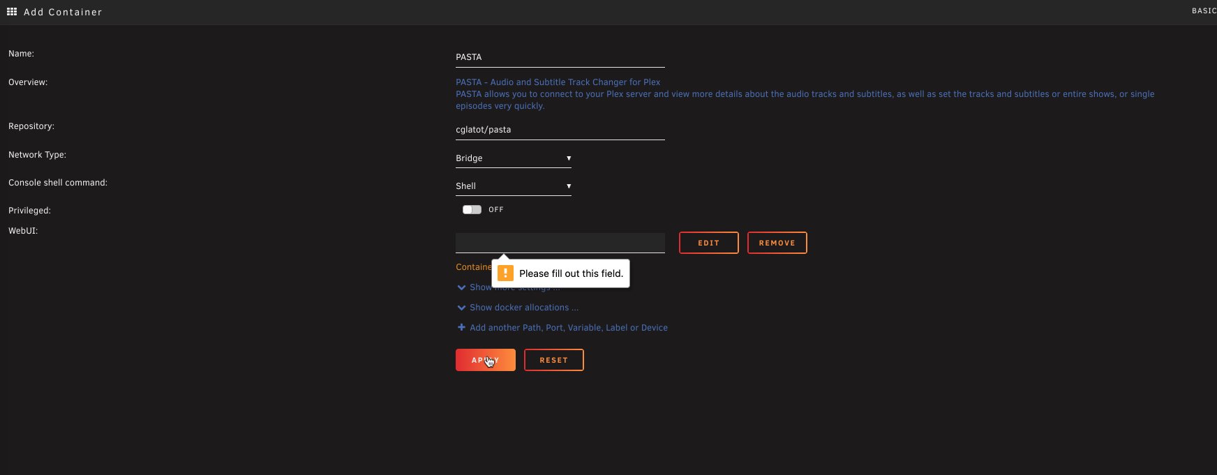

I'm trying to get the PASTA plugin up and running but I have no idea what to put for the "WebUI" section. There is zero info on github or instructions with the docker container for what needs to go there.
4 hours ago, ramblinreck47 said:
"WebUI" section
That is already filled, the webserver runs on port  80 inside the container, map any port of your choosing, and it should work without you changing anything.
I came here for this same question, it doesn't have a default value and won't let you save the container config without it.
Cerberus:AddContainer 2020-06-24 16-40-40.jpg
322437279_CerberusAddContainer2020-06-2416-40-40.thumb.jpg.d449ae037cf600e36225fd4068dcc7f5.jpg
It's left empty for you to decide the port that should be exposed to the host, since port 80 is normally used by unraid itself.
Ah ok, could be useful to add that explanation on the template as it wasn't clear (to at least 2 users) what was expected there. Or maybe set a default port and the user can change it if they like?
We have atleast 15 templates that are set up like this, and this is the first time i have heard it is being a "problem"
