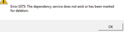

  4. Now try starting the service clicking on the Start button. This did not work for me, I received an error that said:
    Could not start the Workstation service on Local Computer. Error 1075 the dependency service does not exist or has been marked for deletion.
    Continue to the next step if you received this error as well.

  5. Finally, go back into Services and start the Workstation service which should now start successfully. Confirm that the Service Status says Running and Startup type is set to Automatic, hit apply and OK if needed.
That's it. You should now be able to establish SMB connection and access your shares with a more secure version of the SMB protocol.

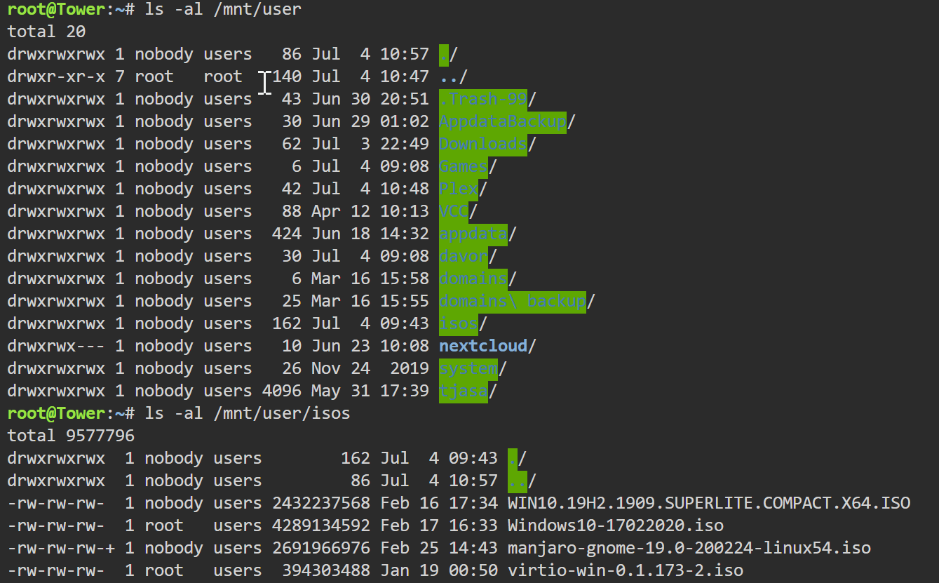

8 hours ago, DoesItHimself said:
Hoping @Frank1940 or some of the pros might know the obvious answer I'm missing here.
Read very carefully this post from LimeTech:
        https://forums.unraid.net/topic/25064-user-share-problem/?tab=comments#comment-228392
Where this really comes around to bite you is if you have a share that is 'Secure'.   Apparently, if your first access to this share is a read operation, you will get logged in as 'nobody'.  If you later try to write to this Secure share, you will not be prompted to login, you will only be told you don't have permission...
Now, about that problem with the 'Movies' and 'TV' folders.  You are going to have to use the command line to see what the permissions are on those files and folders.  (Use the Terminal that is part of the GUI.)  I will give you an example of both the command and the output:
root@Elsie1:~# ls -al /mnt/user
total 3499216
drwxrwxrwx  1 nobody users          58 Apr 12 01:30 ./
drwxr-xr-x 11 root   root          220 Apr  9 09:51 ../
drwxrwxrwx  1 nobody users          29 Jul 15  2019 Backup/
drwxrwxrwx  1 nobody users         118 Nov 19  2017 CommunityApplicationsAppdataBackup/
drwxrwxrwx  1 nobody users          75 Nov  2 17:03 Data/
drwxrwxrwx  1 nobody users          33 Dec 13 17:19 Folder_Tree/
drwxrwxrwx  1 nobody users         125 Apr  8 22:04 Media/
drwxrwxrwx  1 nobody users         146 Mar 23 17:33 appdata/
-rw-rw-rw-  1 nobody users 10737418240 Apr 14 08:51 docker.img
And moving down the tree:
root@Elsie1:~# ls -al /mnt/user/Media
total 43732856
drwxrwxrwx 1 nobody users         125 Apr  8 22:04 ./
drwxrwxrwx 1 nobody users          58 Apr 12 01:30 ../
drwxrwxrwx 1 nobody users        4096 Apr  8 22:04 All\ Movies/
-rw-rw-rw- 1 nobody users 44599541760 Feb 10  2017 DISNEY_WOW_Calibration.iso
drwxrwxrwx 1 nobody users           6 Mar 12  2014 DVD\ Calibration/
drwxrwxrwx 1 nobody users         206 Apr  8 22:04 Family\ DVD\ Videos/
drwxrwxrwx 1 nobody users          71 Jun 21  2017 Music/
-rw-rw-rw- 1 nobody users   178259492 Oct 20  2016 Nathaniel-Ashley-Wedding.pdf
drwxrwxrwx 1 nobody users          85 Jun 21  2017 Trailers/
The BASH shell that Unraid uses has a editor built into it. So be sure to experiment with the 'arrow' keys after you have entered a couple of commands!  IF you don't understand what is being displayed or it doesn't 'look' like what is above in these examples, ask.  (Anything that begins with a  'd'   is a directory.  Anything that begins with a   '-'   is a file.)
You can also try running the New Permissions script in the Tools menu on just the 'Media' share.   If that fixes it, you have a problem with some Docker or plugin not being properly configured.  That is not a problem if you have only one of these which adds files to that share but if you have more than one, you have wiped out any evidence that points to the culprit.

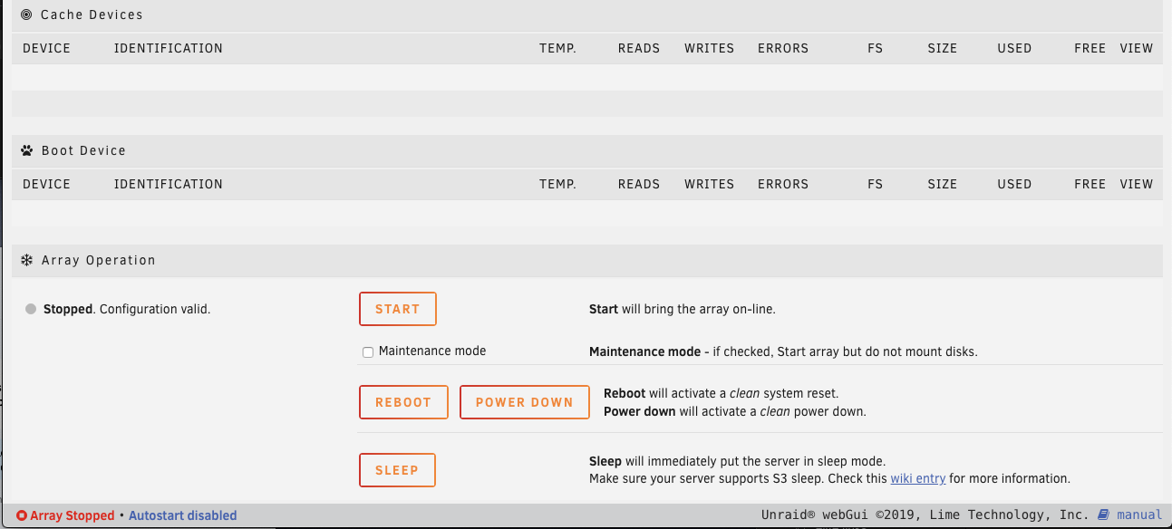

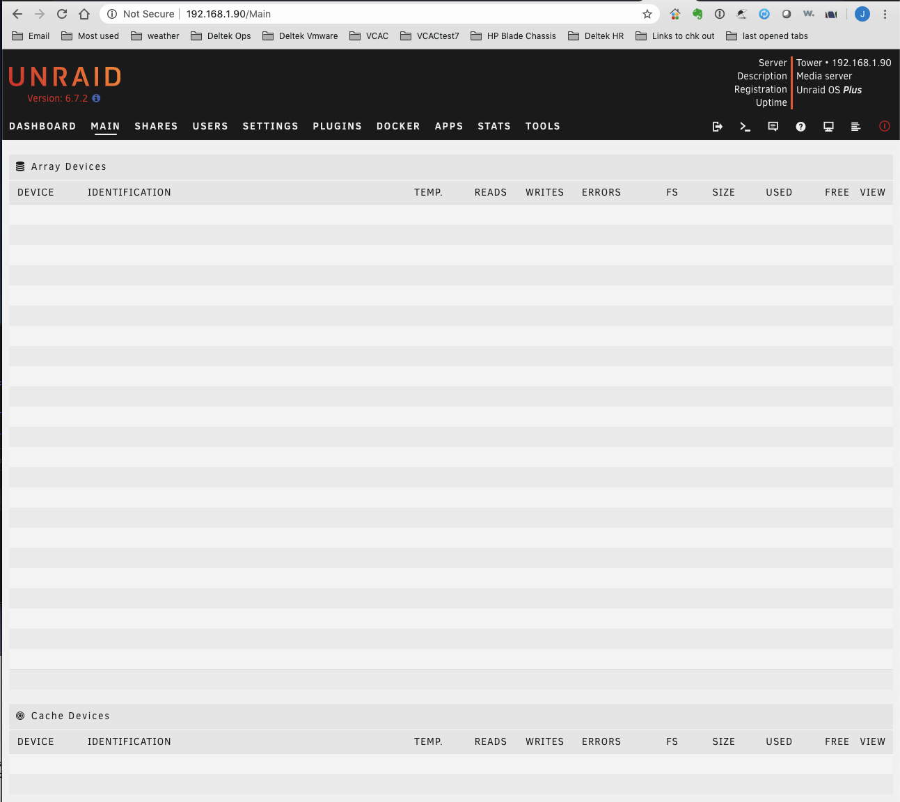

I need assistance with my 6.7.2 version of Unraid.  For the past couple of days I've seen my dashboard showing now drives, nothing visible and the array not started.  I can ssh and can see by USB boot drive, but cannot do anything.  I looked at /var/log/dmesg and see my drives, but Unraid GUI does not.  I've rebooted a few times to see if there would be a difference.  I don't see anything.  I'd like to try and run diagnostics, but there is nothing how to run from CLI only the GUI.  Can you look at my screenshots and provide some troubleshooting steps?  I'm not too worried at this point because I'm sure the data on the drives is still there.  Just gotta get back up the Unraid server application.
Open a new thread and post your diagnostics.   Doesnt appear to be relevant to this thread
If you cant hit diagnostics from the UI enter in diagnostics at a command prompt

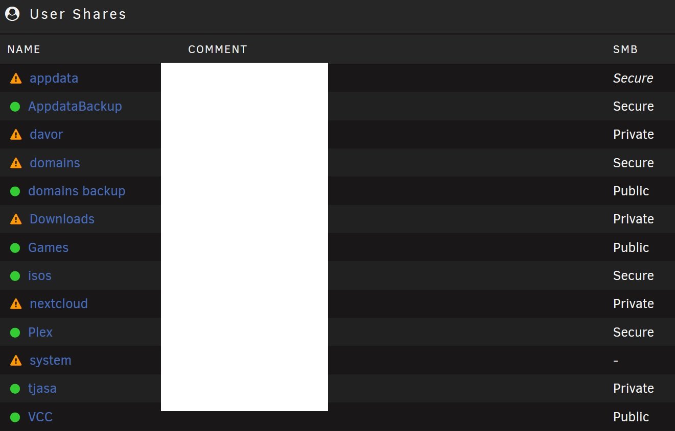

Hello there,
Upon looking over this topic I don't think I've seen anything resembling my issue.
My issue is that the permissions I set for shares in Unraid are being ignored on my mapped drives in windows (and linux) which means I have r/w permission for all shares, no matter the security set for each and additionally the export setting is being ignored and even the shares which have export set to no are visible.
For example I can r/w on a private share which should only be accessible by a different user and I can r/w on a secure share even tho it's set as r/o for my username. I'm trying to avoid public shares (was reading that ransomware topic :D) and I am logged in on windows via credential manager which is set to correct user and password as set in Unraid.
This is my setting for mapping the share in windows:
[Tower]
path = /mnt/user
comment =
browseable = yes
valid users = davor
write list = davor
vfs objects =
Edited by Ver7o
Not sure I understand what you are trying to do with this:
[Tower]
path = /mnt/user
comment =
browseable = yes
valid users = davor
write list = davor
vfs objects =
If you are giving Windows access to /mnt/user, then you are bypassing the security of individual Unraid user shares and just giving it all of the user shares as one share, so no separate user share security.
You should map each share separately, or better yet, don't map anything. I never "map drives" to network resources anymore, since it is simpler to just browse the network, and most applications can browse the network too so no need for "mapped drives".
@Ver7o, As I look at your Shares, I see that you have Public, Secure and Private shares.  You should always make sure that you access your Private share first so that you force a login.  The reason for this is that it is possible that you can be given 'guest' access to a share and SMB will only allow one connection from each client computer.  In that case, when you attempt to access your Private share, it will always fail and the failure message will not really tell you what the problem is...
Edited by Frank1940
