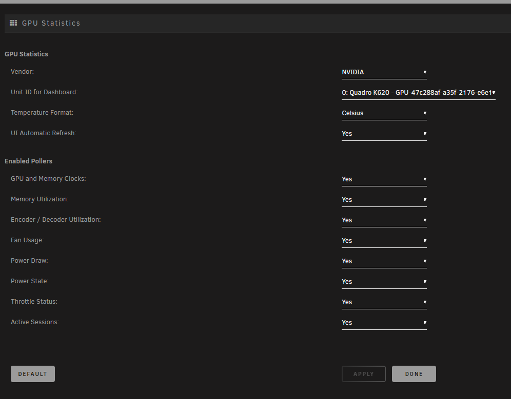

2 hours ago, mlapaglia said:
ok i added the optional display preferences back in, on my machine whenever i try to save my preferences they go back to default, does that happen on yours?
Exactly.
EDIT: do you write the settings in a file? Haven't looked at the code that closely...

1 hour ago, mlapaglia said:
I'm not sure, I just modified it to make it look like the other dashboard, not sure how the back side works.
Is it possible that you don't change the values in the 'defaults.cfg'?
Also I would recommend to create a file /boot/config/plugins/YOURPLUGINNAME/defaults.cfg with the changes that the user makes and save/read it from there since it will survive a reboot if it's in this directory: Example
EDIT: The abillity to hide things would be very nice since the Power Draw is broken on most GTX1050Ti cards like on mine and I would like to hide it because it's simply useless.

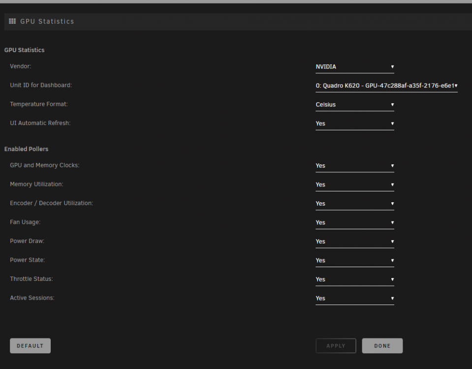

ok, i tried to find some examples but i can't find checkboxes being used anywhere in my config pages. once i switched them to drop down lists they started working:

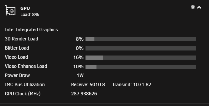

@smidley @madelectron any anyone else wanting to test Intel iGPU support:
First install the Intel GPU Top plugin from @ich777 -- This is NOT the docker version on Community Apps.  It has to be the plugin version by ich777.  Then uninstall my current plugin and manually install this one - https://raw.githubusercontent.com/b3rs3rk/gpustat-unraid/dev-intel-test/gpustat.plg
Make sure you go to settings and set it for Intel.  If you have a valid iGPU, it should show up on the settings page.  If not, message me the output of the following command run from the UnRAID console:
lspci | grep VGA
If your iGPU is detected, but you're not getting any data on the dashboard, go to the UnRAID console and type/copy paste the following and send me the result:
cd /usr/local/emhttp/plugins/gpustat
php ./gpustatus.php
If you are getting some, but not all the data you'd like to see review the UnRAID console output of:
intel_gpu_top
If the metric I display on the dashboard is not showing up for you in intel_gpu_top your CPU/iGPU/Chipset doesn't support monitoring that.  Recommend disabling that particular metric in your plugin settings.  If the metric shows up in intel_gpu_top but still doesn't display on the dashboard, send me the output of:
timeout -k .500 .400 intel_gpu_top -J -s 250
To revert back to my existing plugin, just uninstall the test version manually and reinstall from Community Apps.
Enjoy!
Edited by b3rs3rk
oops
2 minutes ago, alturismo said:
@b3rs3rk little review
intel_igpu_top
dashboard
output from your cmd attached
thanks for looking into it ;)
Did you select Intel in the settings page and apply it?  You're getting the NVIDIA output on the dashboard.
Edited by b3rs3rk
forget it, my fault, didnt save settings vendor intel ... sorry
