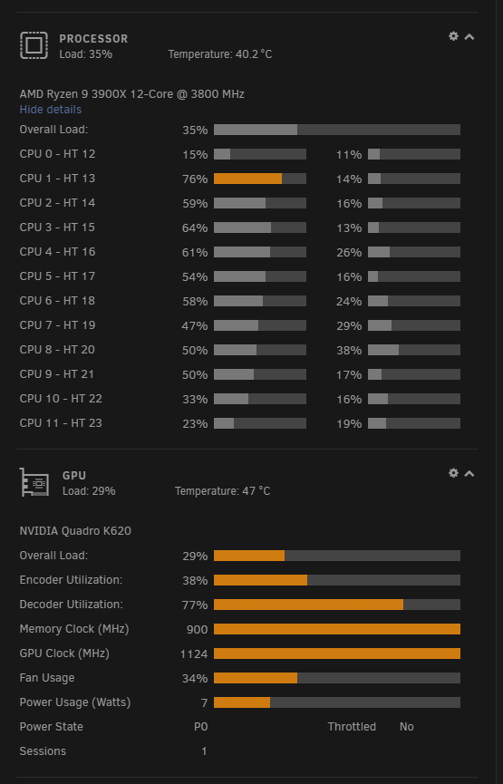

  • I did some more work to get it to look like the CPU sidebar that comes with unraid
  • I have created a PR for b3rs3rk's plugin to add MultiGPU support for 6.12 as Dashboard panels are different in 6.12. The PR works on pre realeases but does not provide Multi support. There are some ot

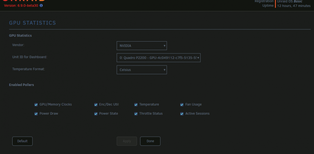

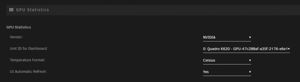

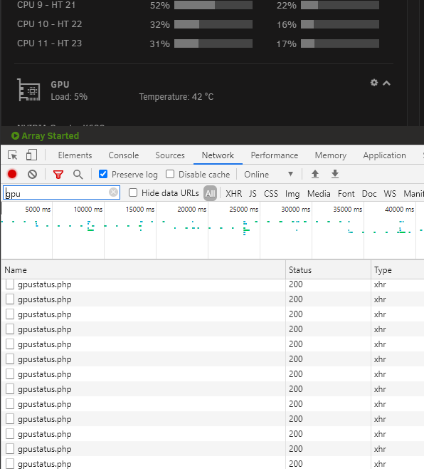

Hi, does anyone know how to change the refresh timing on the widget? Mine works but the stats doesn't change until I refresh my browser. Or do I need to do something else to clear cache? Thank you in advance!

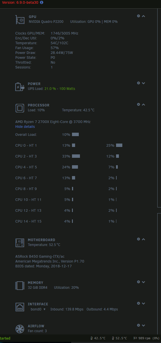

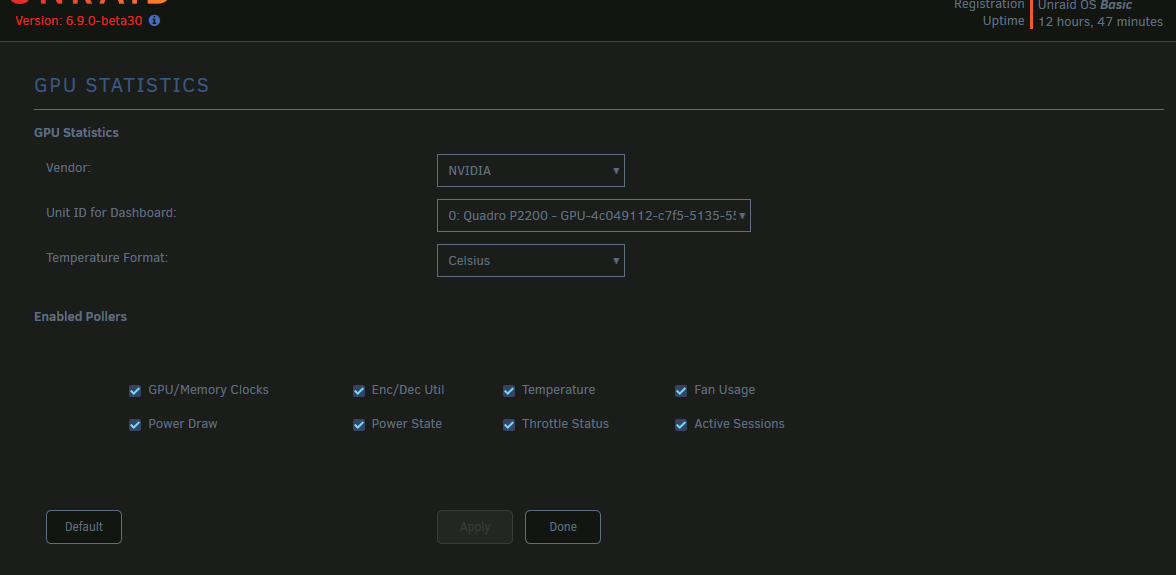

same problem here, i use Nvidia Unraid 6.9.0-beta30 and my GPU is a Quadro P2200, everything is refreshed in real time on the dashboard but not GPU statistics...
here are infos :
result of 'nvidia-smi -q -x -i 0' :

several results of 'cd /usr/local/emhttp/plugins/gpustat/ && php ./gpustatus.php' when starting hw encoding (updated each time i send the command) :
{"vendor":"NVIDIA","name":"Quadro P2200","clock":"139","memclock":"405 MHz","util":"0%","memutil":"0%","encutil":"0%","decutil":"0%","temp":"38C","tempmax":"102C","fan":"48%","perfstate":"P8","throttled":"Yes","thrtlrsn":" (gpu_idle)","power":"7.32W","powermax":"75W","sessions":0}
{"vendor":"NVIDIA","name":"Quadro P2200","clock":"1746","memclock":"5005 MHz","util":"11%","memutil":"22%","encutil":"40%","decutil":"89%","temp":"44C","tempmax":"102C","fan":"49%","perfstate":"P0","throttled":"No","thrtlrsn":"","power":"38.52W","powermax":"75W","sessions":1}
{"vendor":"NVIDIA","name":"Quadro P2200","clock":"1746","memclock":"5005 MHz","util":"11%","memutil":"21%","encutil":"38%","decutil":"90%","temp":"44C","tempmax":"102C","fan":"49%","perfstate":"P0","throttled":"No","thrtlrsn":"","power":"38.47W","powermax":"75W","sessions":1}
{"vendor":"NVIDIA","name":"Quadro P2200","clock":"1746","memclock":"5005 MHz","util":"13%","memutil":"24%","encutil":"46%","decutil":"100%","temp":"45C","tempmax":"102C","fan":"50%","perfstate":"P0","throttled":"No","thrtlrsn":"","power":"39.14W","powermax":"75W","sessions":1}
GPU stats dashboard :
Main Dashboard :
it's weird all your infos are updated in real time as intended, it's seems to be just a refreshing issue on the main dashboard caused by the webserver or the browser, perhaps you must try another method to refresh the infos on the dashboard, perhaps like in the dynamix.system.temp which send the output in html directly in a <span> :
result of 'cd /usr/local/emhttp/plugins/dynamix.system.temp/include/ && php ./SystemTemp.php' :
<span id='temp' style='margin-right:24px'><span title='Procesor'><i class='fa fa-thermometer-0' style='margin:0 6px 0 24px'></i>402&thinsp;&deg;</span><span title='Mainboard'><i class='fa fa-thermometer-0' style='margin:0 6px 0 24px'></i>50&thinsp;&deg;</span><span title='Array fan'><i class='fa fa-flag-o' style='margin:0 6px 0 24px'></i>978&thinsp;rpm (0%)</span><span title='Array fan'><i class='fa fa-flag-o' style='margin:0 6px 0 24px'></i>1179&thinsp;rpm (0%)</span><span title='Array fan'><i class='fa fa-flag-o' style='margin:0 6px 0 24px'></i>1557&thinsp;rpm (32%)</span></span>
I'm sure it will work if you modify slightly the output of your plugin, feel free to contact me if you want more infos or if you need someone to test improvements...
Edited by doobyns
update infos for debugging

On another note, also not seeing live ENC/DEC statistics on 6.9.0-beta35. Verified with "nvidia-smi dmon -s u"
I can help troubleshoot the UI refresh in 6.9.0. When I look at the page source I don't see the `setTimeout` listed, where does `$update` get set, i'm guessing this is false? when I call the `setTimeout` command manually in the console the UI does refresh.
    <?if ($update):?>
      setTimeout(gpustat_status, <?=max(abs($display['refresh']),2000)?>);
    <?endif;?>
Edited by mlapaglia
I tried cloning the repo and making modifications but i couldn't get my plugin to work.. i modified the existing plugin while it was installed and got this:
Here's the PR: https://github.com/b3rs3rk/gpustat-unraid/pull/6
I need some help creating the pkg file for the pr.
Edited by mlapaglia
Would be appreciated if the fix could be merged, I love this tool. Thanks to mlapaglia for taking the time!
It looks great. I’ve got no front end Dev experience to speak of and I will excitedly review the PR work you have done when I return home from vacation. I have some other stuff I was working on that I will have to merge in but I’ll handle that later on. Thanks.
Ya I don't have that part wired up yet. I'm also curious why the plugin has to hit an endpoint every second to get information, while CPU usage in the unraid CPU sidebar doesn't make a http call to get information.
Edited by mlapaglia
That makes sense...
I think this is because they are streaming it from a bash output or a bash script, but I could be also wrong...
thanks! i couldn't find much information online about developing plugins so i was making wild stabs in the dark lol
ok i added the optional display preferences back in, on my machine whenever i try to save my preferences they go back to default, does that happen on yours?
