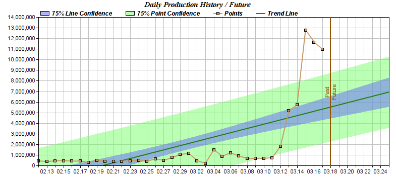

It looks that Unraid team is kicking major a$$. 18.7mln credits makes this team NUMBER ONE! And yes, there are big number of "overachievers" in this group.

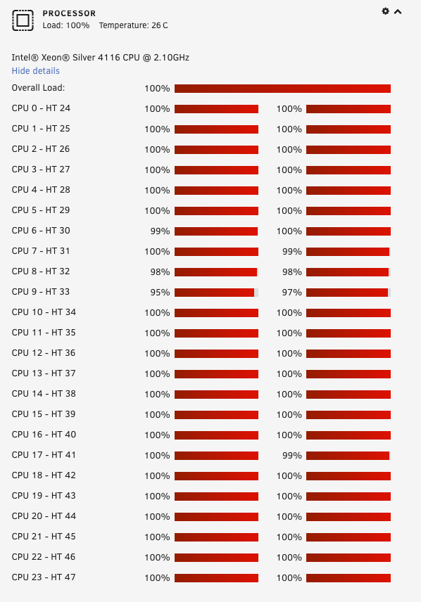

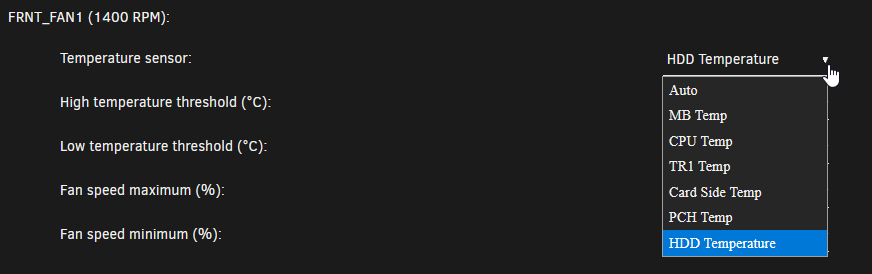

I resolved my lockup issue with BOINC.  It has now been running 15+ hours with no problems.
I noticed that right before the last crash, the MB temp had risen from 33C to 78C.  Cooling was obviously an issue.  Under normal loads I had never seen it higher than 34C.
Through the IPMI Support plugin, I had set my side intake fans (which blow air from side to side through the drive cages) to react to HDD temps.  In my brilliance, I thought, if all the HDDs are spun down, I certainly don't need these fans running at full RPM so I had them dialed down to 200 RPM with no active hard drives.  If one hit 35C they ramped up to 700 RPM and at 40C they kicked in on full at 1400 RPM.  Problem is that this air flow once passed through the drive cages, flows back to the motherboard.  I had essentially cut off most cooling to the MB when the HDDs were spun down.
As long as something else was going on on the server that spun up an HDD or two, the system was happy.  As soon as they all spun down, it was just a matter of time before a lockup under a sustained heavy load (such as BOINC) because the MB cooling (except for a bottom intake fan) had been shut off.
Through the IPMI Support plugin, I had set my side intake fans (which blows air from side to side through the drive cages) to react to HDDs temps.  In my brilliance, I thought, if all the HDDs are spun down, I certainly don't need these fans running at full RPM so I had them dialed down to 200 RPM with no active hard drives.  If one hit 35C they ramped up to 700 RPM and at 40C they kicked in on full at 1400 RPM.  Problem is that this air flow once passed through the drive cages, flows back to the motherboard.  I had essentially cut off most cooling to the MB when the HDDs were spun down.
As long as something else was going on on the server that spun up an HDD or two, the system was happy.  As soon as they all spun down, it was just a matter of time before a lockup under a sustained heavy load (such as BOINC) because the MB cooling (except for a bottom intake fan) has been shut off.
Oh wow, that is very specific!
Thanks for this, I have this same setup. But I have torrents running most of the time, so it's rare for drives to be spun down.
I just changed it for both sets of fans to depend on the CPU temperature, is this a good option? I've noticed that most of the time hard drives won't get too hot, even when I'm transferring a lot, or during a parity check. So this should be safe?
My CPU fan reacting to the CPU temps was enough to keep the CPU cool.  The potential problem with having case intake fans react to CPU temps is that, depending on the thresholds, your CPU temp may be relatively low while the MB temps are climbing if the motherboard is not being cooled properly; although, I can't really see a scenario where the MB temp is rising too much unless the CPU and/or PCH is getting a pretty good workout.
I have noticed that controlling the fans based on MB temp is also an option with the IPMI plugin.
I am going to experiment with the various temperature sensors that it can monitor and find a combination of temps and speeds that will work in all cases.  Of course, that will likely mean increasing the RPM of the fans to at least 50% on the low end.  My Noctua fans are very quiet so, I really did not need them dialed down to 200 RPM anyway.
If your HDDs don't get too hot, even during a parity check, you are probably fine to tie the fan performance to some other temperature measure.  In my system, the Parity drive can get up to 45C during a parity check, but the data drives are usually a few degrees lower than that.  They get closer to 45C in the Summer because of ambient temps.
