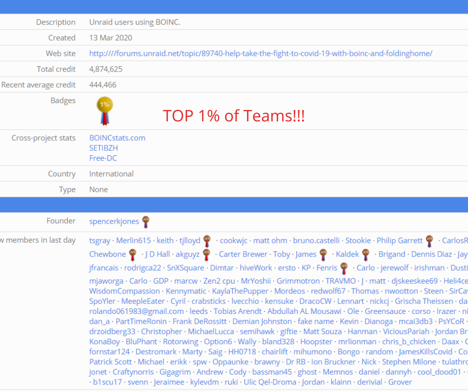

2 hours ago, hernandito said:
Did we find a COVID-19 cure yet??

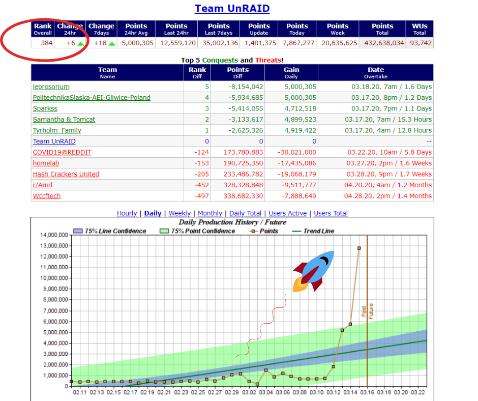

I see that the unRAID team is Top 5% Average Credit...
Look again, we just broke into top 1%.

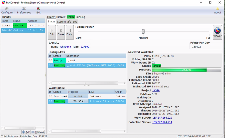

Got a VM running with half my CPU pinned to it along with a GTX1060 and also my gaming PC with all cores and a GTX1070. Hope it helps the cause. My 2 GPUs are working overdrive for the foreseeable future and both computers are pumping out major heat.
My tower now serves as a space heater for my home office 😁

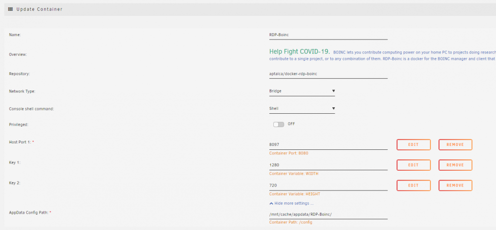

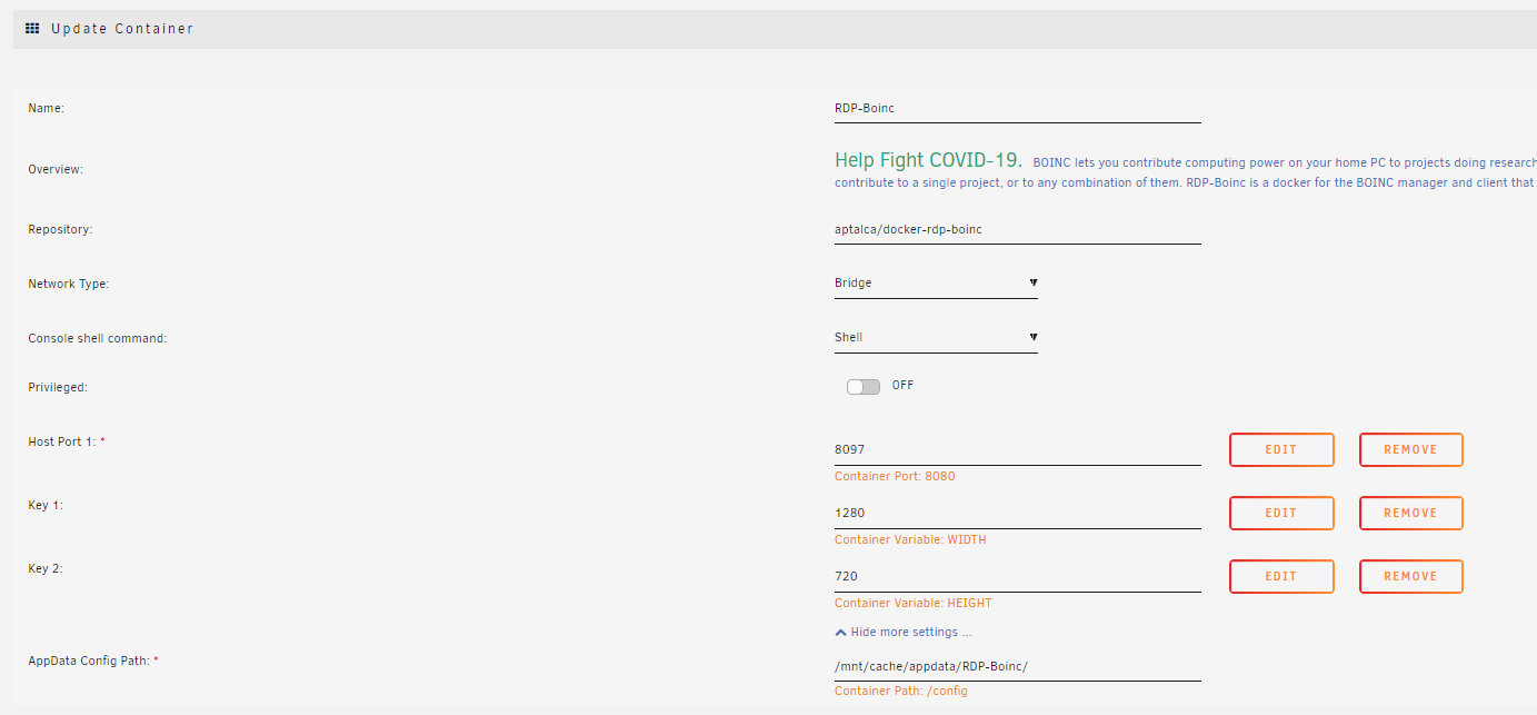

15 minutes ago, ksculland said:
Cannot get the webUI to display
http://192.168.1.40:8097/#/client/c/Boinc
Is there anything I do?
Anything need be done on my router to allow this to work?
Try putting the config folder on /mnt/cache
Thanks for the suggestion, but still have same issue.
Did I do it correctly?

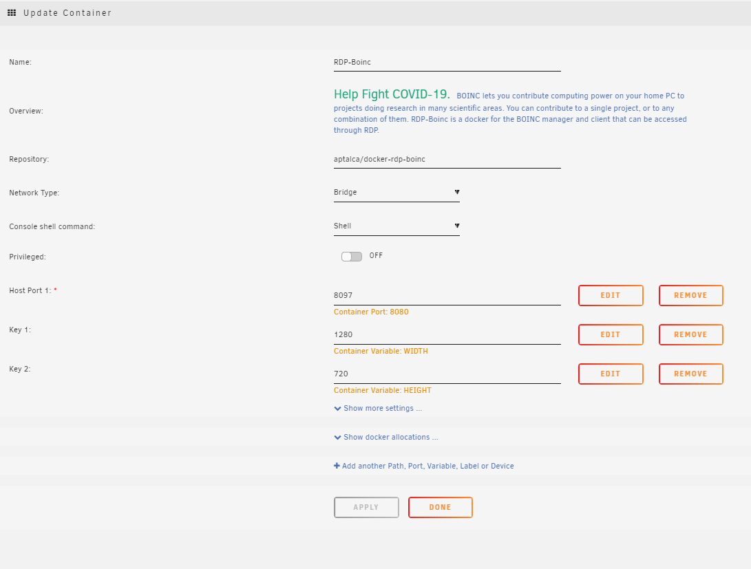

To everyone who has performance issues / unresponsiveness / lag while BOINC docker is running:
Go to Docker template, click on "Advanced View" (upper right corner, on the same level as "Update Container") to see the advanced view and then:
  • Select the cores you want BOINC to use and make sure to NOT select (a) CPU 0 + HT and (b) any core isolated to VM.
  • Add --cpu-shares=64 to the Extra Parameters box. This will ensure BOINC does not starve other dockers when running (while allowing BOINC to always run full steam when other dockers are not running).
  • Optionally add --memory=[#]G to limit the docker RAM usage to [#] gigabytes. This will prevent your other apps and VM getting killed if BOINC uses too much RAM.
Screenshot as an example - core 16-31 are selected for BOINC and memory limited to 16GB.
