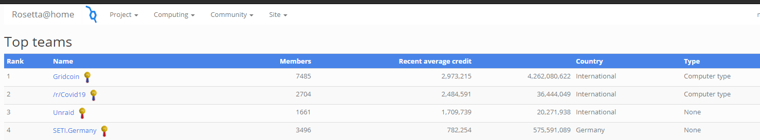

Team Unraid, now #3 top teams.

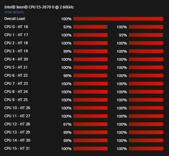

Got mine going on all cores.

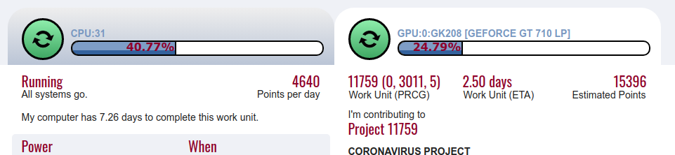

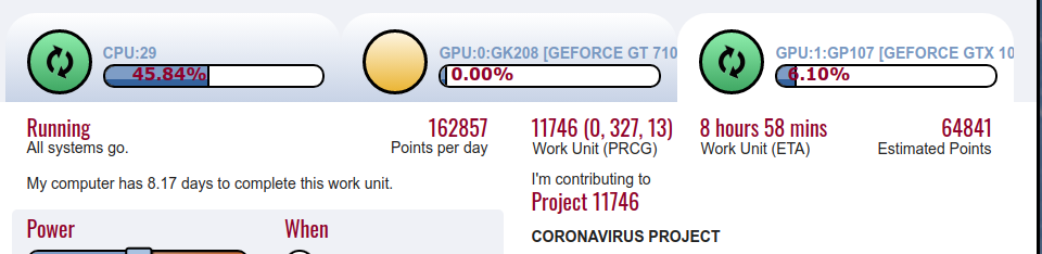

22 hours ago, sjaak said:
found i bug in the docker system.
i have 2 F@H docker images setup. the first one is setup to use the gt710, the second one is setup to use the 1050TI
but after create the second images it only sees the 710 (which is not assign to it)
then a change the config.xml:
  <slot id='0' type='CPU'/>
  <slot id='1' type='GPU'/>
  <slot id='2' type='GPU'/>
now it using the 1050ti and de 2nd image has NO work assign to the gt710, only the 1st one...
pretty weird that the 2nd image is seeing the GPU which is NOT setup to using it...
first image:
second image:
at least 2 GPU's (of the 3 gpu installed) are working :D

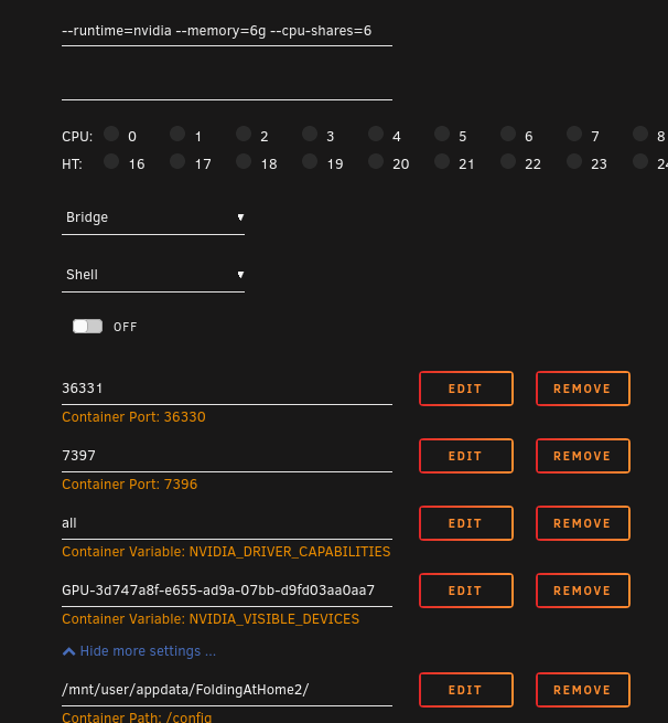

What did you set in the NVIDIA_VISIBLE_DEVICES variable for the containers?
just the UUID of the GPU:

So just for me to understand what you want, you want the two containers to see just one GPU each?
As far as I know, when setting only one specific device in the variable, the container should only see that one.
I saw that you have 2 GPU devices in the xml you posted. Remove one and it will only use one of the gpus. You might have to experiment with the ID to get the correct card.

yes, 2 docker images so each use have its own GPU (i have no idea to assign 2 gpu's to one docker image, if that is possible i going to use 1 docker image)
i changed to config.xml to 2 gpu's because with only one its seeing only the gt710, which is NOT assign to it... that's the weird thing about it...
i did experiment with the ID setting, no luck...
also, f@h2 sees the 710 but does not assign work to it...
i would love to know how to assign 2 specific gpu's to one docker image, especially for Plex and f@h.
(i have 1 pcie slot free, so an another 1050ti can fill that up :P )
To make all GPU's available to one container you just set the NVIDIA_VISIBLE_DEVICES to all. You also then need to adjust the xml to reflect all GPU's.
And the slots id part in config.xml:
 <!-- Folding Slots -->
  <slot id='0' type='GPU'/>
In the above config I removed the CPU as I use it for boinc. If you want all 3, add one more line.
