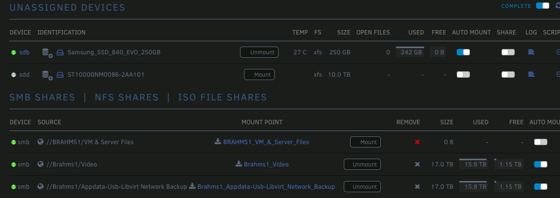

I have server A connected via smb to server B (both running unRaid)
1347391144_ScreenShot2019-06-28at7_57.21AMcopy.thumb.png.6449f6ee125ce050100261f973a2bf05.png

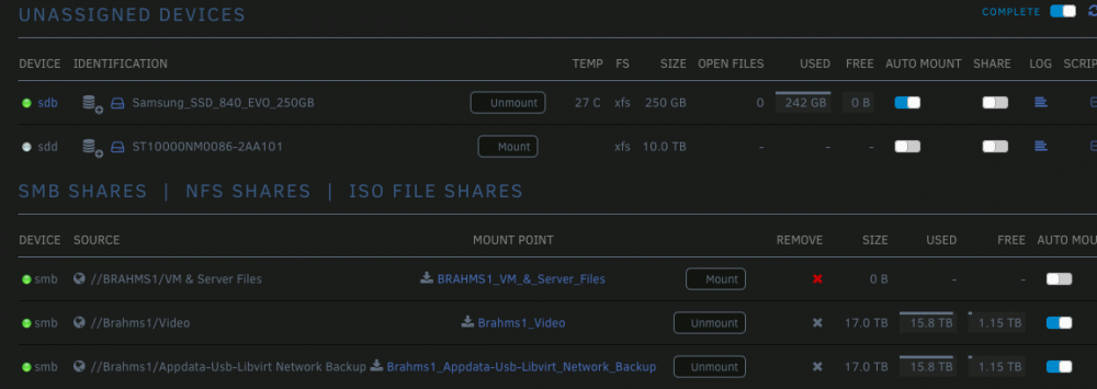

I stopped the array on server B, imitating an os update/reboot.
Server A, still has the remote share mounted in UD from Server B on my local network
Server A tries  to find server B but can't

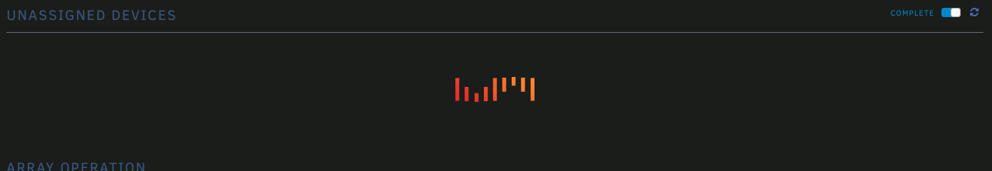

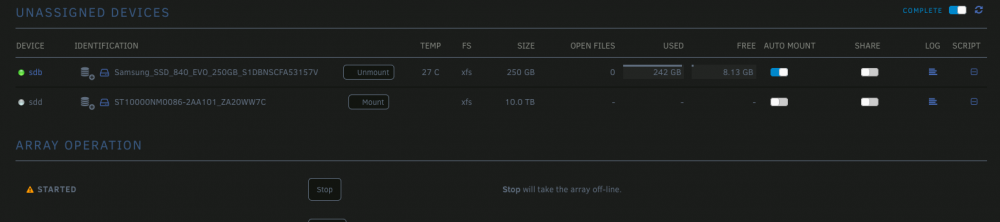

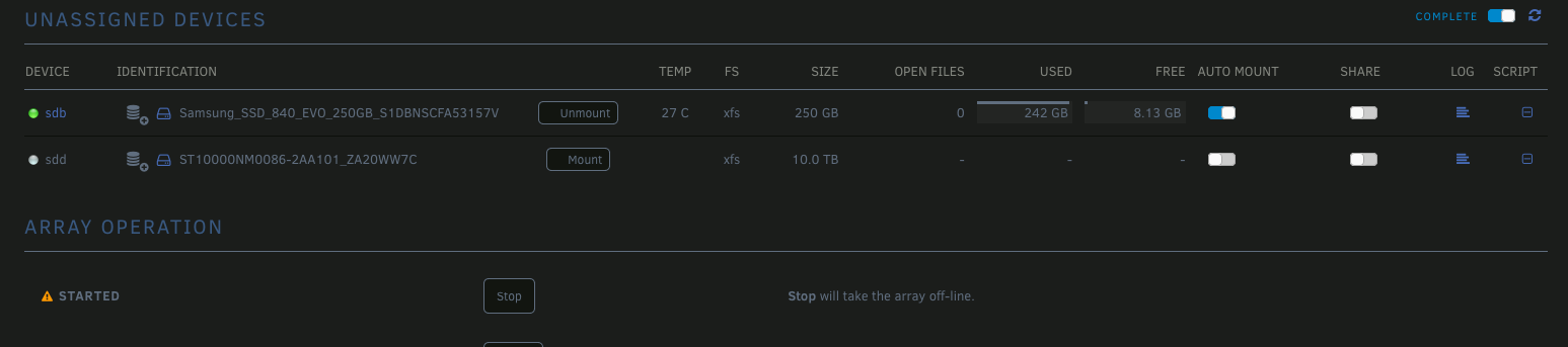

After timing out, the gui section for mounting remote shares disappears  (as indicated by the moving graphic which stops moving and shows only the disks inside the server.
1102601900_ScreenShot2019-06-28at7_24_17AM.thumb.png.bc4706412f76f4b979c59e863ef842fa.png
At the same time, the nginx upstream timeout occurs in the logs (watching live updates via tail)
Jun 28 07:23:00 Twins nginx: 2019/06/28 07:23:00 [error] 5371#5371: *1961 upstream timed out (110: Connection timed out) while reading upstream, client: fe80::c48:f133:39ab:5f21, server: , request: "POST /plugins/unassigned.devices/UnassignedDevices.php HTTP/1.1", upstream: "fastcgi://unix:/var/run/php5-fpm.sock:", host: "twins.local", referrer: "http://twins.local/Main"
There is no way to unmount missing share in the webgui now

It is not directly a problem with the remote server or network, but rather, how UD handles remote mounted shares that go offline. It occurs across all 3 of my installs,  when a mounted smb share goes offline (not randomly, typically are offline when I'm doing an unRaid os update, or hardware swap).
its a reproducible error/problem caused only by interaction with UD, as demonstrated below, carried on just now on a fresh boot:
1231173696_ScreenShot2019-06-28at7_28_38AM.thumb.png.cab1aaf2d94f3b6d93a9da6eb895c9f6.png
it returns "resource busy" in CLI, additionally, forcing it off does not work either
Clicking on any tab other than main, the webgui is still functional for a short time and runs without error.
Returning Server B back online (that hosts the remote share) still results in web gui loading icon. when it times out, UD displays disks in that server as before, no remote shares or section where that option is normally preset is visible.
after multiple refreshes of main tab, web gui can crash (and often does for me)

I have spent a lot of time on the UD plugin to keep it from appearing to 'hang'.  The issue comes from some commands UD uses to get the mounted devices information.  Remote mounted devices using CIFS mounts are particularly messy because of the 'df' command used to get remote mounted devices information and the way servers going off-line are handled.  I've set timeouts on all commands that I can to keep UD from hanging, but there may be more that needs to be done.  I can't reproduce the problem with the setup I have, so it is very difficult to fix the issues you are seeing because it is probably related to your particular setup.
You can't unmount a remote mounted share when it goes off-line because CIFS reports the mount as busy.  Unless UD does a forced unmount, the device won't unmount.  It is not a good idea for UD to do a forced unmount, because the device could actually be busy.
My suggestion is to unmount any remote mounted shares before you take the remote server off-line.
Also, any of you having any issues with UD, please remove the preclear plugin and reboot your server.  The preclear plugin is partially integrated with UD (that's why you can see preclear information in UD), and there is a background preclear task that collects device information that may have some issues.  I don't have the time or desire to troubleshoot preclear.  There has been a lot of discussion about the need to preclear disks.  It really isn't necessary and the preclearing has been a source of problems.  I know all you preclear fanatics will want to start a debate about it, but for troubleshooting these issues, please get it out of the way.
Post your diagnostics from normal operation.
