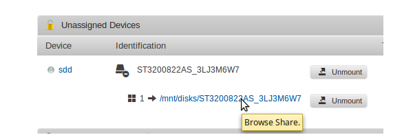

When I click on the partition name, it takes me to the contents via the browse share function. What am I missing to be able to rename it?
Click on the disk serial number, then click on the partition name and rename it to the share name you want.
The share won't show up unless you turn on the share switch for the disk and SMB shares is enabled in the UD settings.
If you hover your mouse over the active areas on the page, you will see a tool tip describing its operation.  This should help you with how UD works.
It has to be unmounted to change the name.
Ahh, I must have missed that tidbit in the directions.
