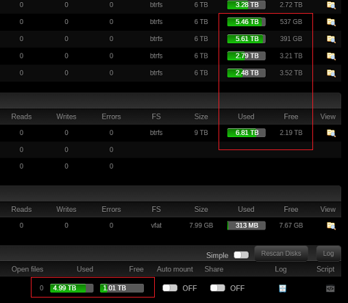

Is it possible UD follow the Display setting "Used / Free columns" & center alignment the number , thanks.
