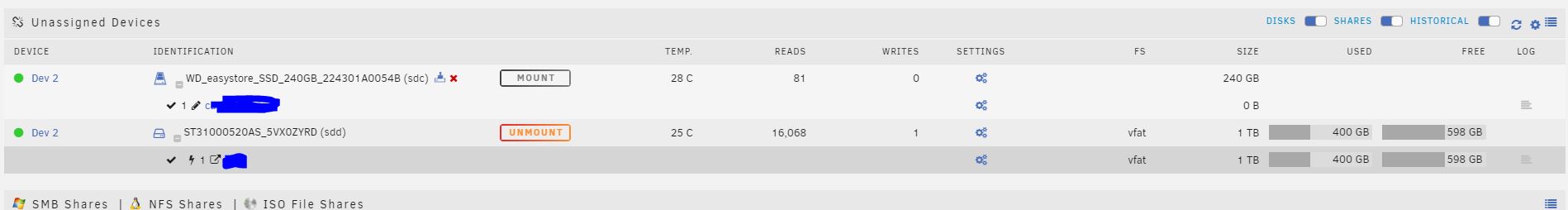

Good afternoon, I recently ran into some trouble and I thought it was a dead drive and now after a week with a new drive this has happened again.
I have a drive I replaced with an SSD formatted it to an encrypted file system. a few days later the drive appeared not to have a file system and unraid wanted me to format the drive and the mount button was grayed out. Thought it was an old drive and I purchased a new one. And to day I got the same thing... except it is still showing the mountpoint. Any help would be appreciated.
text  error  warn  system  array  login
Jul 17 11:08:21 DT310 kernel: sd 1:0:1:0: [sdc] Spinning up disk...
Jul 17 11:08:21 DT310 kernel: sd 1:0:1:0: [sdc] 468862128 512-byte logical blocks: (240 GB/224 GiB)
Jul 17 11:08:21 DT310 kernel: sd 1:0:1:0: [sdc] Write Protect is off
Jul 17 11:08:21 DT310 kernel: sd 1:0:1:0: [sdc] Mode Sense: 7f 00 00 08
Jul 17 11:08:21 DT310 kernel: sd 1:0:1:0: [sdc] Write cache: enabled, read cache: enabled, doesn't support DPO or FUA
Jul 17 11:08:21 DT310 kernel: sdc: sdc1
Jul 17 11:08:21 DT310 kernel: sd 1:0:1:0: [sdc] Attached SCSI disk
Jul 17 11:08:46 DT310  emhttpd: WD_easystore_SSD_240GB_224301A0054B (sdc) 512 468862128
Jul 17 11:08:46 DT310  emhttpd: read SMART /dev/sdc
Jul 17 11:08:53 DT310 unassigned.devices: Partition 'sdc1' does not have a file system and cannot be mounted.
** Press ANY KEY to close this window **
Both your disks are marked as 'Dev 2'.  That's a problem.  Do this:
  • Post diagnostics.
  • Reboot and see it the drives are sorted out.
  • Post diagnostics.
reboot did not fix...
dt310-diagnostics-20230717-1315.zip
  • Post diagnostics.
this is also interesting, when i click on the dev2 it shows up at dev1...
I see some issues:
Jul 17 11:08:53 DT310 unassigned.devices: Mount drive command: /sbin/mount -t 'vfat' -o rw,noatime,nodiratime,nodev,nosuid,iocharset=utf8,umask=000 '/dev/sdd1' '/mnt/disks/ugg'
Jul 17 11:08:53 DT310 kernel: FAT-fs (sdd1): utf8 is not a recommended IO charset for FAT filesystems, filesystem will be case sensitive!
Jul 17 11:08:53 DT310 kernel: FAT-fs (sdd1): Volume was not properly unmounted. Some data may be corrupt. Please run fsck.
Jul 17 11:08:53 DT310 unassigned.devices: Successfully mounted 'sdd1' on '/mnt/disks/ugg'.
and
Jul 17 11:09:04 DT310 unassigned.devices: Warning: shell_exec(/bin/df '/mnt/disks/ugg' --output=size,used,avail | /bin/grep -v '1K-blocks' 2>/dev/null) took longer than 10s!
The timeout is a problem on the vfat disk.
Do this:
  • Click on the Device Settings icon (three gears), clear the "Disk Name" field and see if the 'devX' changes.  The disk name should be in the form of 'devX', and not 'Dev X' in the Disk Name field.
  • Unmount the vfat disk and run the file system check (check mark icon).
What format is the unmountable disk?  Linux is not seeing a partition on that disk.  Can you put it into another computer and see if the file system is recognized?
2 hours ago, dlandon said:
Do this:
It renamed itself to dev3 now
I will work on the vfat disk later on...
the unmountable disk is xfs-encrypted. I will see what I can do for another computer.

I am not sure what is happening here.  I have 2 drives passed using Unassigned Devices but the Samsung 970 SSD shows up twice.  I have marked it as Passed through and Disable mount button and disabled Show partitions but the disk still shows up in my list (as the third option in the picture) and the Format button is still active.  This makes me uncomfortable.  I have passed the entire disk through to a VM and I would rather not have the ability to accidentally format the drive.  "Dev 2" is a separate SSD that is passed through in the same way to a VM that uses it and it does not show the partition as a separate device.  Dev 1 is an NVME m.2 SSD and the Dev 2 is a 2.5 inch Silicon Power SATA SSD.  Any ideas if there is a way I can get that NVME1n1p3 device off of this list?
