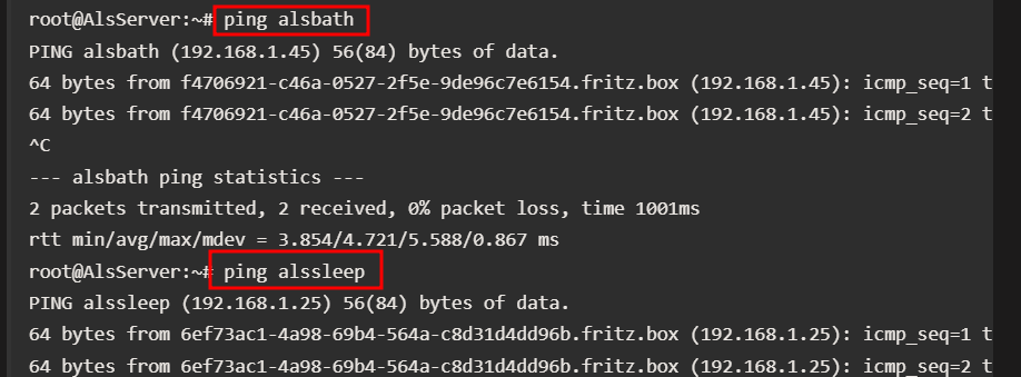

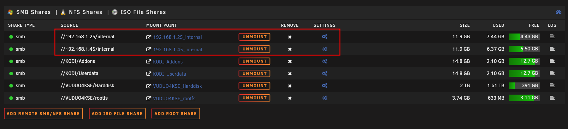

i can add the shares "again", either manually or by searching Server, working fine and end with "success", but no change in UI, still red crossed like above and still in the background mounted.
message after successfully added again via host name
Aug  8 05:30:26 AlsServer unassigned.devices: Remote server 'ALSBATH' cannot be found on the LAN.
Aug  8 05:32:17 AlsServer unassigned.devices: Remote server 'ALSSLEEP' cannot be found on the LAN.
while i can ping them
root@AlsServer:~# ping alsbath
PING alsbath (192.168.1.45) 56(84) bytes of data.
64 bytes from f4706921-c46a-0527-2f5e-9de96c7e6154.fritz.box (192.168.1.45): icmp_seq=1 ttl=64 time=3.85 ms
64 bytes from f4706921-c46a-0527-2f5e-9de96c7e6154.fritz.box (192.168.1.45): icmp_seq=2 ttl=64 time=5.59 ms
^C
--- alsbath ping statistics ---
2 packets transmitted, 2 received, 0% packet loss, time 1001ms
rtt min/avg/max/mdev = 3.854/4.721/5.588/0.867 ms
root@AlsServer:~# ping alssleep
PING alssleep (192.168.1.25) 56(84) bytes of data.
64 bytes from 6ef73ac1-4a98-69b4-564a-c8d31d4dd96b.fritz.box (192.168.1.25): icmp_seq=1 ttl=64 time=2.83 ms
64 bytes from 6ef73ac1-4a98-69b4-564a-c8d31d4dd96b.fritz.box (192.168.1.25): icmp_seq=2 ttl=64 time=0.882 ms
^C
so i thought, well, lets add them again with IP instead name and voila, back again normally in the UI ;)
thanks for the Tipp with just readding ... worked out in the end ;)
Even though your server can be ping'd, UD could not resolve those two server names to IP addresses.  Did you ping by server name or IP address?
As you found out, you can use either the server name or the IP address in UD.  The situation you were in was probably you doing an edit to the config file to get UD to "think" it had resolved the server name.  That used to work, but I've been working through a lot of issues with UD that caused problems with character sets that make php fail.  The Chinese character set has been particularly challenging.  That's why the situation you had failed after a UD update.
to check i used the name of course ;)
and all is good, just happened on the update when i posted and wondered ... readding by ip resolved it and everything is fine here, thanks for taking a look and the hint with readding ;)
The reason I asked was to confirm the name lookup.  UD seems to be having difficulty resolving names to IP addresses at times.

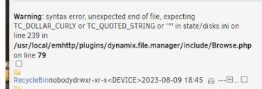

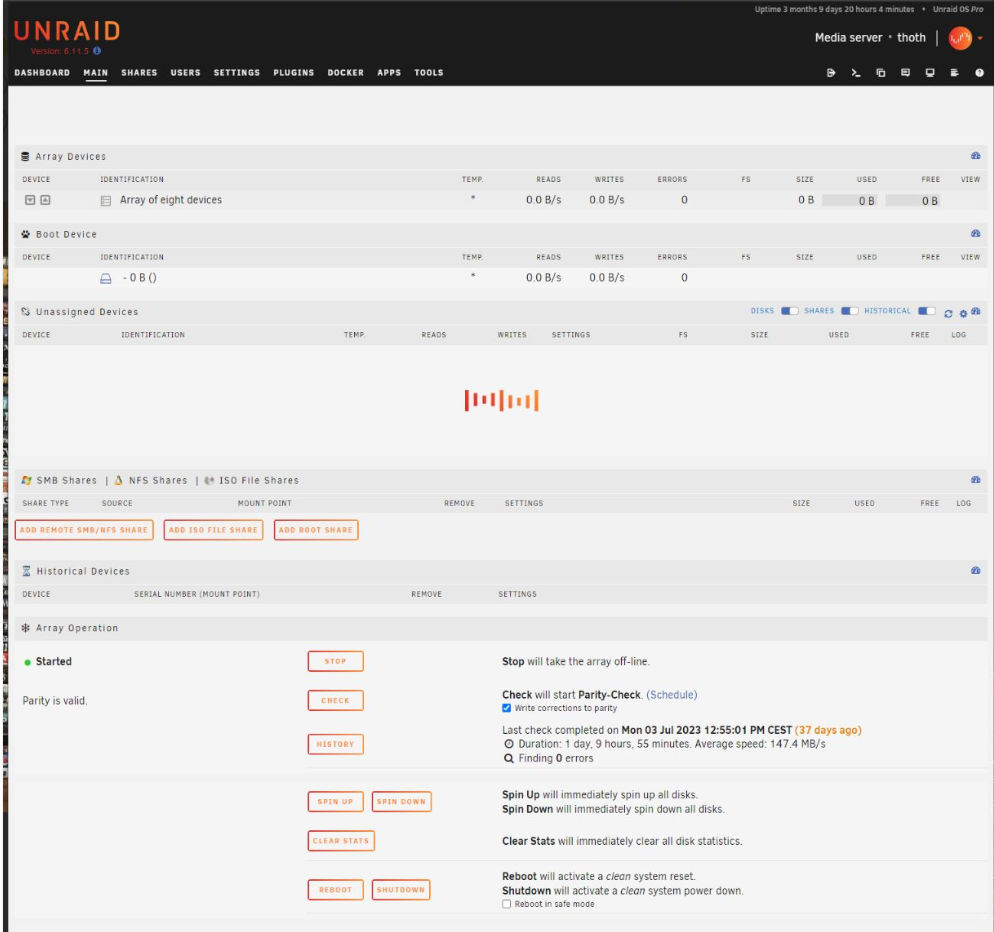

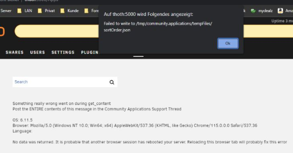

After updating unassigned devices to 2023.08.07 in Unraid 6.11.5 the whole Unraid GUI got broken:
I was forced to delete the plg files from the flash drive and reboot the server. Now after doing a fresh install of the plugin everything seems to be normal. Not sure what the problem caused and sadly I disabled the syslog mirror option 🙈
Some other errors, which were visible after the update and disappeared after reboot:
Dynamix File Manager
Community Applications
Have also been having unraid gui issues for the past few days, it will not load for me, and I also tried what mgutt did and it also went back to normal, for ~1 hour, then the gui went on the fritz, not loading/forever loading for me, again.
Several days ago there was an UD preclear release that had some files missing,  That release caused some gui issues.  It was posted for about five minutes.  You may have caught that release.  I'm not sure if that is causing this for you, but remove the UD preclear plugin and see if yur issues clear up.
Apologies sir, it was not your plugin, I forgot I turned on IP4 + 6 on the same day, and that seems to be the problem, turn it back to IP4 only, no more problems with the GUI. So all good.
