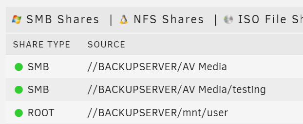

26 minutes ago, murkus said:
I dont know what you mean by device designators, but the export path/filenames only contain letters, number, dashes and underscores, nothing else.
This is what I was talking about:
27 minutes ago, murkus said:
I wouldn't know why this should not be acceptable names and renaming them would be quite an effort as they are mounted by a lot of other machines, too.
The source is only for UD to identify the remote share and has to be free of characters that cause issues in php.  The actual share name characters are not an issue.

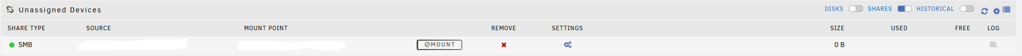

I recently updated to 6.11.5 from 6.9.2, but now my unassigned device doesn't show any space (Used/Free).  This has led Unraid to believe there is no space available and has interrupted my backups.  What can I do to get the space data back?
Edited by clowncracker
The problem is more than just the space.  I see some strange stuff.  There is no 'Source' or 'Mountpoint', but the disk orb is green meaning that UD thinks the remote server is on line.
Do this:
  • Click on the double arrows on the upper right of the UD page.
  • If that doesn't fix things, pm me the '/flash/config/plugins/unassigned.devices/samba_mount.cfg' file.
Do this:
Refreshing Disks and Configuration didn't work, just PM'd you the file.  It's weird, if I use my Windows PC to access the SMB share (totally unrelated to Unraid) it works.  So I know it's online.
I believe I have resolved the issue.  The share somehow got unmounted even though the mount button is disabled.  I've manually remounted the share and have set AUTOMOUNT = true on the settings.
There is still a problem. The remote share does not show on the ud page.  I'll take a look at the configuration file.
Does the remote share show in the UD page?  Your configuration is fine and I don't see an issue.
