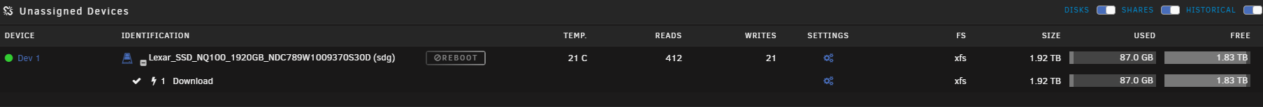

Following the application of the 2023.08.17a update this morning, i can now successfully connect to SMB shares again.
I did have to delete existing links and recreate (and unlock the domain account it was using!) but then it worked 1st time!
Running 6.12.3
I updated UD to 2023.08.17a, I see the same faded "Reboot" symbol even after stopping unraid & full re-boot.
My scenario is a little different as the share is still accessible via SMB.
I like the ability to move, delete, rename files in this UD share from the Unraid UI.  How do I get that feature back?
Post diagnostics.
5 minutes ago, a12vman said:
Post the output of this command:
cat /proc/mounts
The reason you are seeing the 'Reboot' tag on the mount button is UD doesn't think the device is mounted properly.  The idea here is to detect when a disk is removed without being unmounted.  I'm not seeing anything in the logs indicating the disk was removed without being unmounted.

No I have not removed this disk. It is plugged in to one of the internal sata ports, inside the server.
