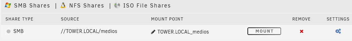

Hi! I'm trying to share some folders that I have in an Unraid server. They are in the same Network than my other server, which also uses Unraid. I want them to share using "unasigned devices" but when the remote is all set, it turns grey and does't work. I've read on Unraid forums that maybe one of the servers isn't communicating by ping with the other.Any ideas? Thanks
Post diagnostics.
11 hours ago, dlandon said:
Post diagnostics.
The problem solved by changing the server name for the IP in the assistant.
