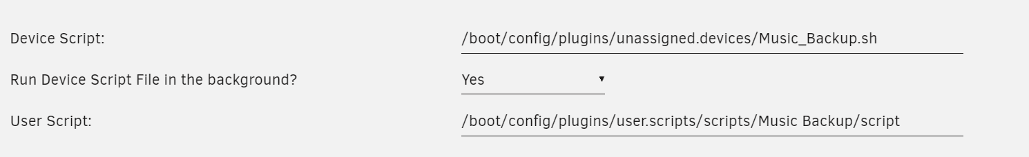

7 minutes ago, comet424 said:
if toggle is on   run sccript  else do not run the script....    if no demand   its ok i keep cutting and pasting
I would probably add an 'Enable Script?' line with 'Yes' and 'No' options just before the run device script in the background option:
It would default to 'Yes'.
I don't think adding another switch would be a good way to do it.

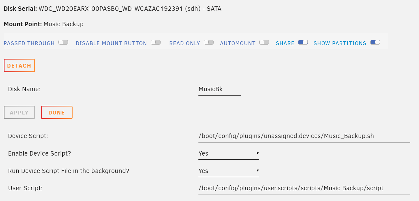

1 hour ago, dlandon said:

41 minutes ago, comet424 said:
@dlandon  ya  that would be cool too like a line say
with the 3 lines  above   Device Script
so Abouve Device Script add a line
and say    "Enable Script"      Yes   and No  as options
this way you can turn it off
the reason i said Toggle switch was because they Turn On And Off   aka Yes or No    just something simple that disables  the script...  thats all i ment about the toggle switchs
It's clearer to have it in the script area:
@dlandon  ya that works   i was just giving the idea of something to enable and disable the script
that works there in the middle   or at the above the script name  so
enable script
device script
but the
device script
enable script works too
i figured if you put enable script above it  its easier to read..  to see its enabled..  and disabled
but thats my preference
enable script
device script
and so on...
but thats only my preference
but looks good.  and as always i really enjoy your work.. since your products really are helpful to make unraid great
