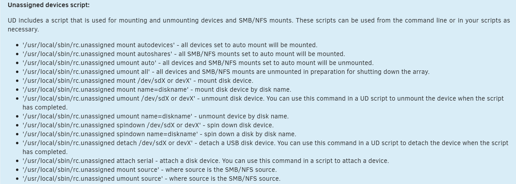

400 pages on this - crazy.
I have a user script that wakes a backup server, then rsyncs my media to it.
I find I have to manually un mount the nfs connection to it of there are errors/warnings in the logs as the server has gone to sleep.
I would like to automate the mounting and unmounting as part of the script with suitable delays.
I looked at the logs on unraid after a mount, but it does not help me with the actual commands.

From UD help:
Check out this post:
