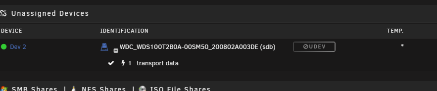

3 minutes ago, christophesimon said:
I rebooted it but SSD is still MIA doesn't it ? No identification...
Is it shown in the disk devices in the BIOS?  You'll have to find out why Linux is not seeing the disk.
what does it mean with this   non mount  i get this on my sisters  unraid box and i seeen she getting some messed up warnings i not sure whats going on with her box
and with the UD
mitchsserver-diagnostics-20231108-2206.zip
and with the UD
That means the file system type being reported by udev is not what is reported by Linux.  The disk is being reported by udev as a 'ntfs' formatted disk that is correct because the disk is mounted as a 'ntfs' disk.  Click on the double arrows icon at the upper right of the UD page and see if it doesn't fix it.
