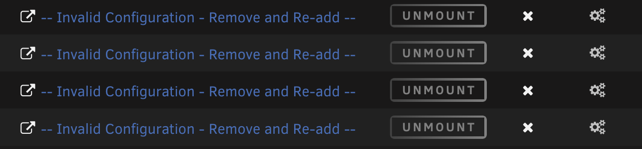

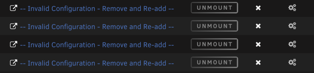

remote NFS shares have "Invalid configuration - Remove and Re-Add", but I cannot remove the share from UA (the "x" button does not remove the share). What now, how to fix?
7 hours ago, BeefIsForDinner said:
Evening. Ever since the ~16th, I haven't been able to mount my SMB shares on my Windows machines. I have sharing enabled and smb security configured, but I'm not getting anywhere. I tried on two separate unRAID servers and I couldn't access a share from either one.
It'll be fixed in the next release.
Show a screen shot of the NFS shares.

1050141935_Screenshot2023-08-25at00_37_48.thumb.png.72ead7c930f1a6f3e9355dd33a370082.png
What I was looking for were the device designations.  I'm pretty sure there are invalid characters in the device designations.
Irrespective of that, PM me the /flash/config/plugins/unassigned.devices/samba_mount.cfg file and I can walk you through how to remove those remote shares manually.  Don't post that file on the forum.
