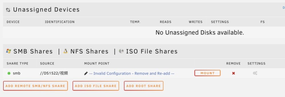

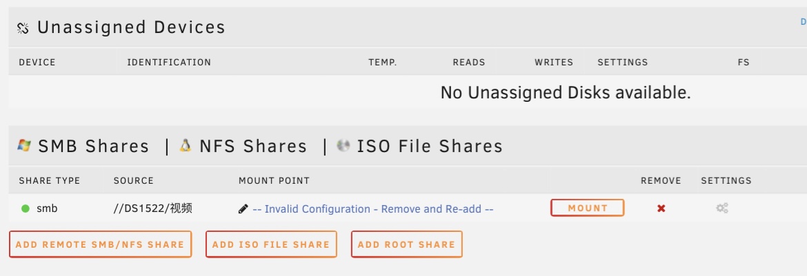

UD cannot mount remote SMB shares named with chinese characters, in the system log it says "share cannot be blank", can anyone help please
Post your diagnostics.

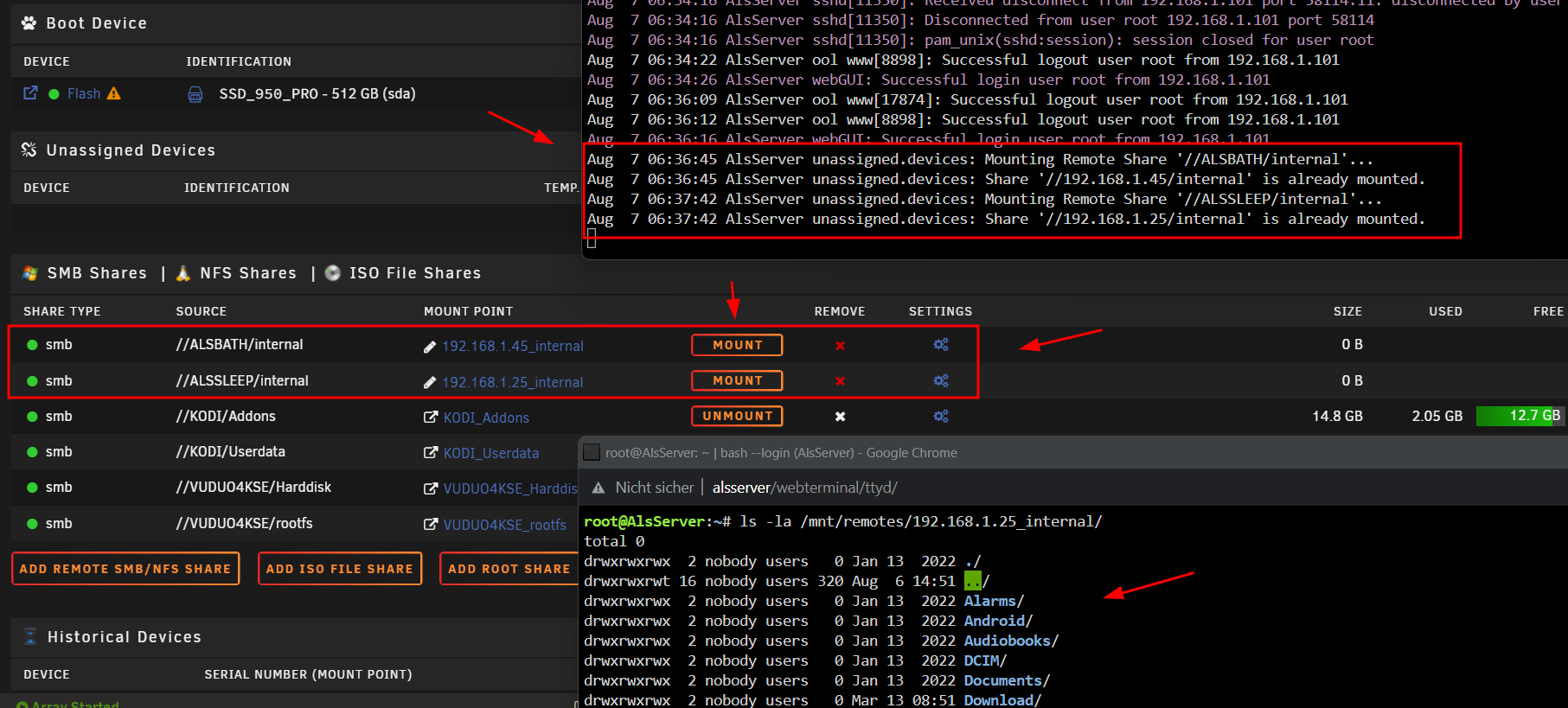

morning, latest update seemed to broke some UI output here.
UI = 2 shares not mounted (tested 2 browsers, chrome, edge)
when i push mount, says "already mounted" ... and actually they are already mounted ... just happened while updated UAD
Can you PM me the '/flash/config/plugins/unassigned.devices/samba_mount.cfg' file?
4 hours ago, YUPAN said:
after the new update I can add SMB share with chinese file name sucessfully, but got the mounting point showing “invalid configuration etc.”
Here is what I see in your samba_mounts.cfg file:
[//ALSBATH/internal]
protocol = "SMB"
ip = "192.168.1.45"
The 'ip' value is supposed to be 'ALSBATH', and not an IP address.
and
[//ALSSLEEP/internal]
protocol = "SMB"
ip = "192.168.1.25"
The 'ip' is supposed to be 'ALSSLEEP', and not an IP address.
I'm not sure how you got into this situation.  UD should never let this happen.  I suspect these are both old configurations and UD did something different then.
Do the following:
  • Stop your server.
  • Remove the two SMB mounts.
  • Start your server.
  • Add the two shares back and mount them to see if it's all sorted out.
about "old configuration" ... definately, i d say almost from startup ~ 2016 here ;)
i will do so on the next regular reboot (cleanup system) and report back then, its all working in the "background" as the shares are funtionally mounted, so currently more or less just a GUI glitch here ...
thanks for looking into it
6 hours ago, YUPAN said:
IMG_1301.thumb.jpeg.4a982770188930dd9b59934dd28b282a.jpegafter the new update I can add SMB share with chinese file name sucessfully, but got the mounting point showing “invalid configuration etc.” and was unable to mount, and nothing happens changing the mounting point to other names or the legacy mounting point in the UD setting sorry if it was my problem with settingsunraid-diagnostics-20230807-1237.zip
Fixed in the next release.  You will have to remove the remote share and add it back.  It will be fixed when the remote share is added back.
Be sure to turn off auto mount before a reboot or you'll end up back in the same situation.
I just remembered there is a trick that should fix this for you without a reboot,  Just add the share as if you were setting it up for the first time and it will update and 'fix' the configuration.
