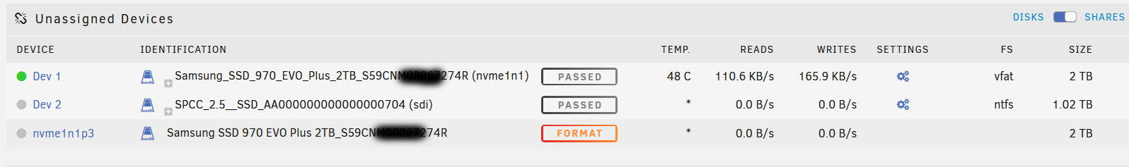

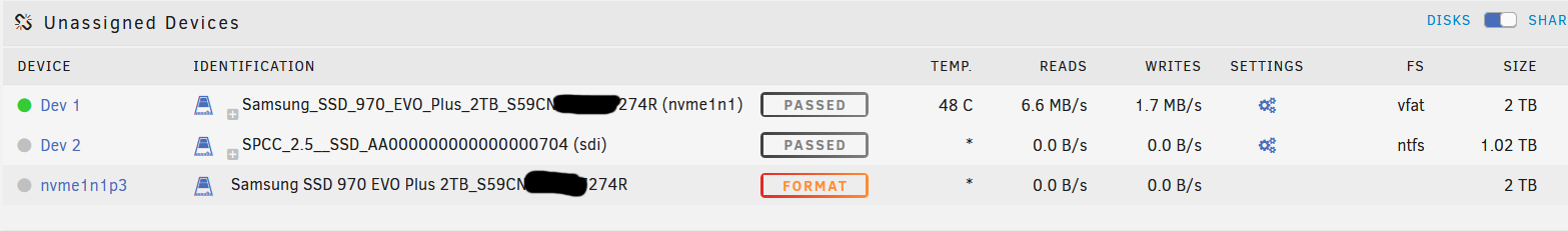

7 minutes ago, akguy said:
I am not sure what is happening here.  I have 2 drives passed using Unassigned Devices but the Samsung 970 SSD shows up twice.  I have marked it as Passed through and Disable mount button and disabled Show partitions but the disk still shows up in my list (as the third option in the picture) and the Format button is still active.  This makes me uncomfortable.  I have passed the entire disk through to a VM and I would rather not have the ability to accidentally format the drive.  "Dev 2" is a separate SSD that is passed through in the same way to a VM that uses it and it does not show the partition as a separate device.  Dev 1 is an NVME m.2 SSD and the Dev 2 is a 2.5 inch Silicon Power SATA SSD.  Any ideas if there is a way I can get that NVME1n1p3 device off of this list?
Post diagnostics.  Post a screen shot of the disks showing the partitions.
The third device in the list is partition 3 on the device in question.  Try clicking on the double arrows in the upper right hand corner of the UD page.

Now that's weird because it's showing only 2 partitions so I'm not sure why the third would appear.

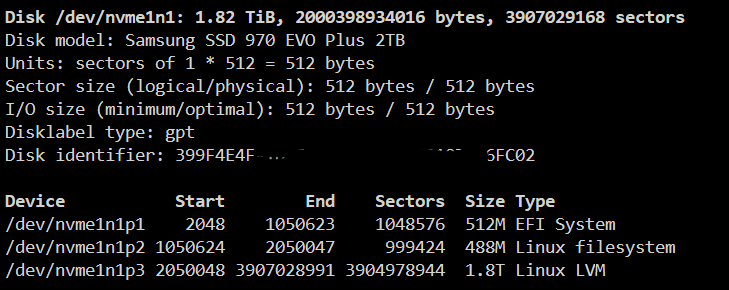

There is a Debian install running on the VM.  I double-clicked the arrows and nothing really changed.  I also ran fdisk -l to look how many partitions the disk had and it showed the following.
The drive seems to be functioning correctly and everything; the only issue is that I don't really like having the "format" button there because it gives me angst.

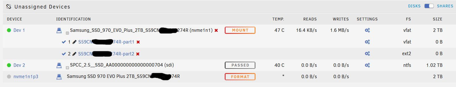

Udev is showing that partition as a separate device because it's an LVM partition.  I'll have to study this for a while.

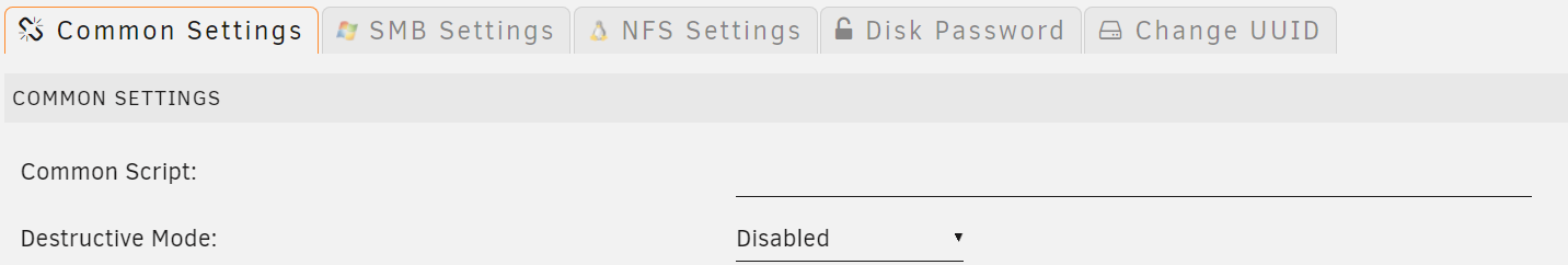

You can turn off the format button by turning off the 'Destructive Mode' in UD Settings.
Oddly, this didn't work.  Not sure if it requires a reboot for setting to take effect but after disabling Destructive Mode in Settings and refreshing the disks and configuration the format button is still there.  I will try to make a note of whether it goes away after the next reboot.
31 minutes ago, dlandon said:
The button will still show 'Format', but it will not be active.
The button is still orange.  It still has mouse-over effects when I move my mouse over it.  I will take your word for it that the button isn't active.  There is a part of me that wants to test it, but not badly enough to actually know what would happen if I press it.  Thank you for the simple solution and quick response.
Something else is going on here.  The button will not be orange if the destructive mode is disabled.  I've never seen a situation where it would be if destrctive mode is disabled.
I just noticed your screen shot.  If the disk is passed through to a VM, don't mount it.  You will cause corruption.  Why is the disk 'Dev 1' showing 'Mount' and not 'Passed'?

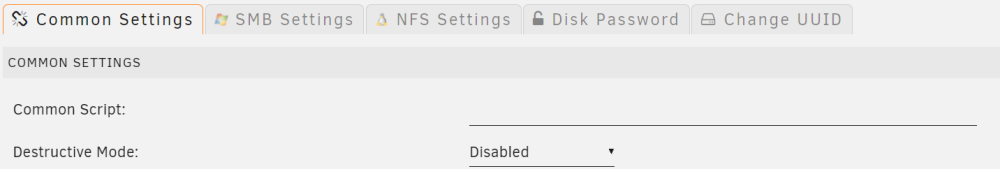

This is destructive mode:
As in the first screenshot I shared today, this is how my interface normally looks:
In order to show you the partitions as you requested in your first reply, I had to toggle some of the checkboxes in the Settings for Dev 1 and that's when it switched to the one you just showed.  I have disabled destructive mode just like in your screenshot but now mine is still back where I started today.  I'll reboot the server tomorrow and let you know if anything changes, but if you were right about the issue being that partition 3 is an LVM, it should be pretty easy to recreate this in a test.  I may install another NVME drive just to test if I can recreate it on another drive.
Just did a test and it looks like the 'Format' button is not disabled when destructive mode is disabled.  Fix will be in the next release of UD.
If you click the 'Format' button it will tell you that you can't format the disk with destructive mode disabled.
Thank you for that clarification.  I am happier knowing that even if my kid jumps on my mouse at exactly the wrong time it will not format this drive with Destructive Mode disabled.  It would be more intuitive if the button were physically disabled, as the mount button is physically disabled when drives are passed through.

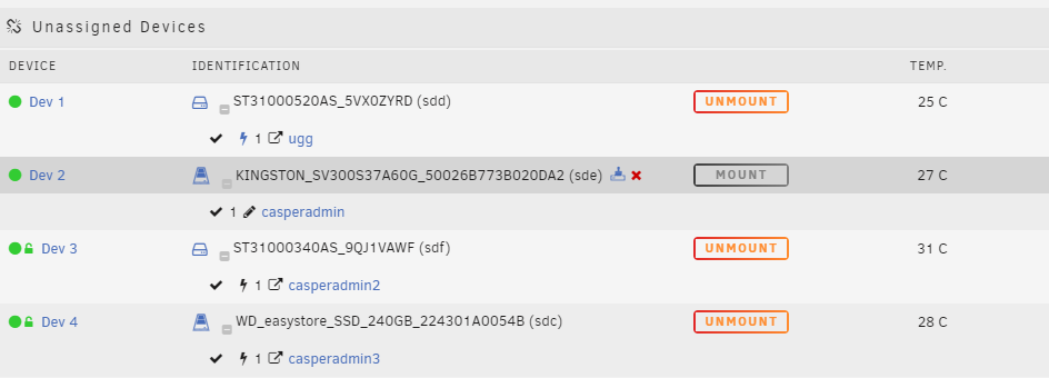

So everything has been running fine over the last week till I rebooted this morning and now my drive is not showing a partition again... any help would be greatly appreciated.

Jul 26 07:37:36 DT310 unassigned.devices: Partition 'sde1' does not have a file system and cannot be mounted.
dt310-diagnostics-20230726-0841.zip
The disk has no file system.  You might want to check cables.

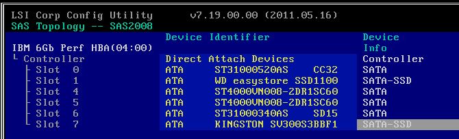

I went into the HBA card and all of the drives show ATA but it does have the device info as SATA. This issue also started when I put in the SSD. I have not had an issue with mechanical drives....
