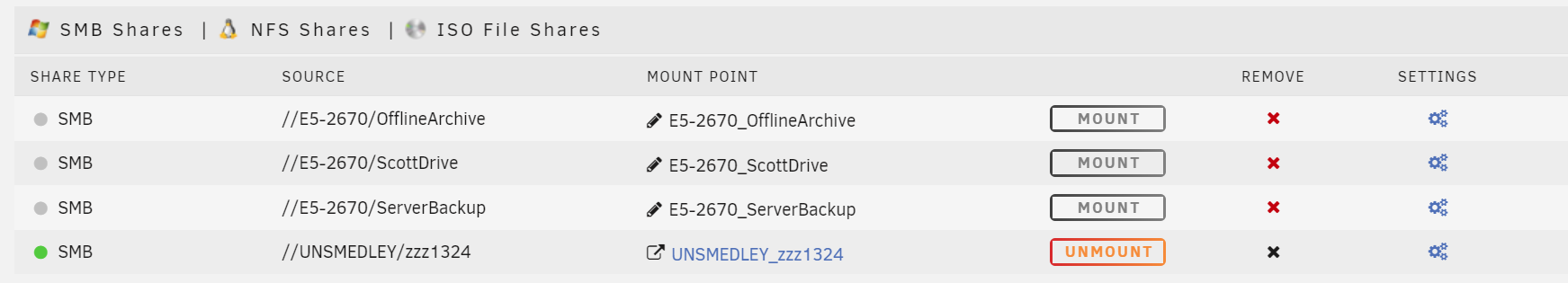

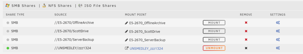

I've been trying to search this forum/thread, but haven't found this specific issue. I have a few remote shares set up on a Win10 PC. Everything seemed to be working fine and I was able read/write to those shares until recently. I usually have that PC powered off while I'm away, and when I returned recently and booted up that computer, the remote shares won't reconnect.  The remote PC is on and I am able to log into it (local or RDP) and the shares should all be accessible - afaik nothing changed.  How can I best diagnose the issue?  I've tried adding a new share from within unRAID, and when I "search for servers" that PC name (E5-2670) comes up, but then when step thru the wizard and try to load shares the list comes up blank.  Hoping I can reconnect these shares and appreciate any tips.  Hopefully it's okay to post this question right in the thread here but I'd be happy to make a new thread if that's preferable. Thanks!
bonzo-diagnostics-20230818-1509.zip
The gray orb ball means that UD doesn't think the remote server is online.  If UD can't ping the remote server, it is marked as being off-line.
Try to ping the remote server with the server name and server IP address.  See if it responds to one or the other.  If it doesn't respond to the server name, you can use the IP address.
Interesting result. I can ping the IP address of the computer no problem. It's on my subnet at the address x.y.z.35 (incidentally, how does one stop the ping command? It seemed to just keep pinging over and over - I wasn't sure how to interrupt the command so I just closed the command line window. Hopefully that stopped it and didn't just leave it running in the background forever!)  However when I tried to ping the computer name, it appears to have resolved to the incorrect IP address of x.y.z.39.  The mobo is one with dual NICs as well as IPMI, but I have the second NIC port bound only to Hyper-V manager and from my router it looks like the IPMI BMC was assigned a different IP address.  I just tried starting up one of the VMs and it was assigned yet a different IP address.  So why is unraid incorrectly resolving the hostname?  And what can I do about it?  Thanks!
Ctrl-C.  Closing the window stopped it.
That's a DNS issue you'll have to sort out on your system.
That was super-weird. I rebooted my main unraid server, and once it re-started suddenly the little bulbs were green and I was able to mount the remote shares on my Win10 box, but at the same time my backup unraid server no longer showed as online so that remote share couldn't be mounted. I went in a pinged it, and once I did suddenly it also started working (after a couple of tries - I forgot UNIX is case sensitive).  Something very strange seems to be going on with name resolution on my network - will have to try to get to the bottom of that.  Thanks for your help.
